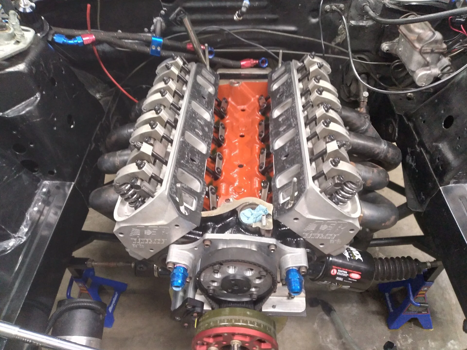

Re-Build Thread, 1989 Saleen Drag Car

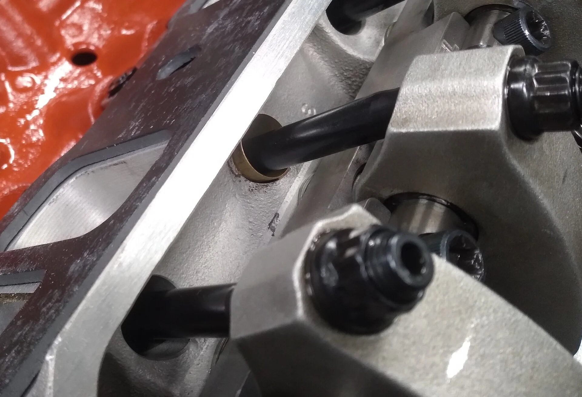

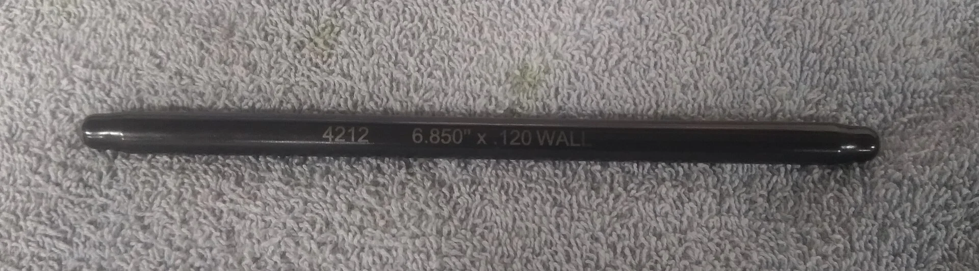

Using a 3/8" X .120 pushrod

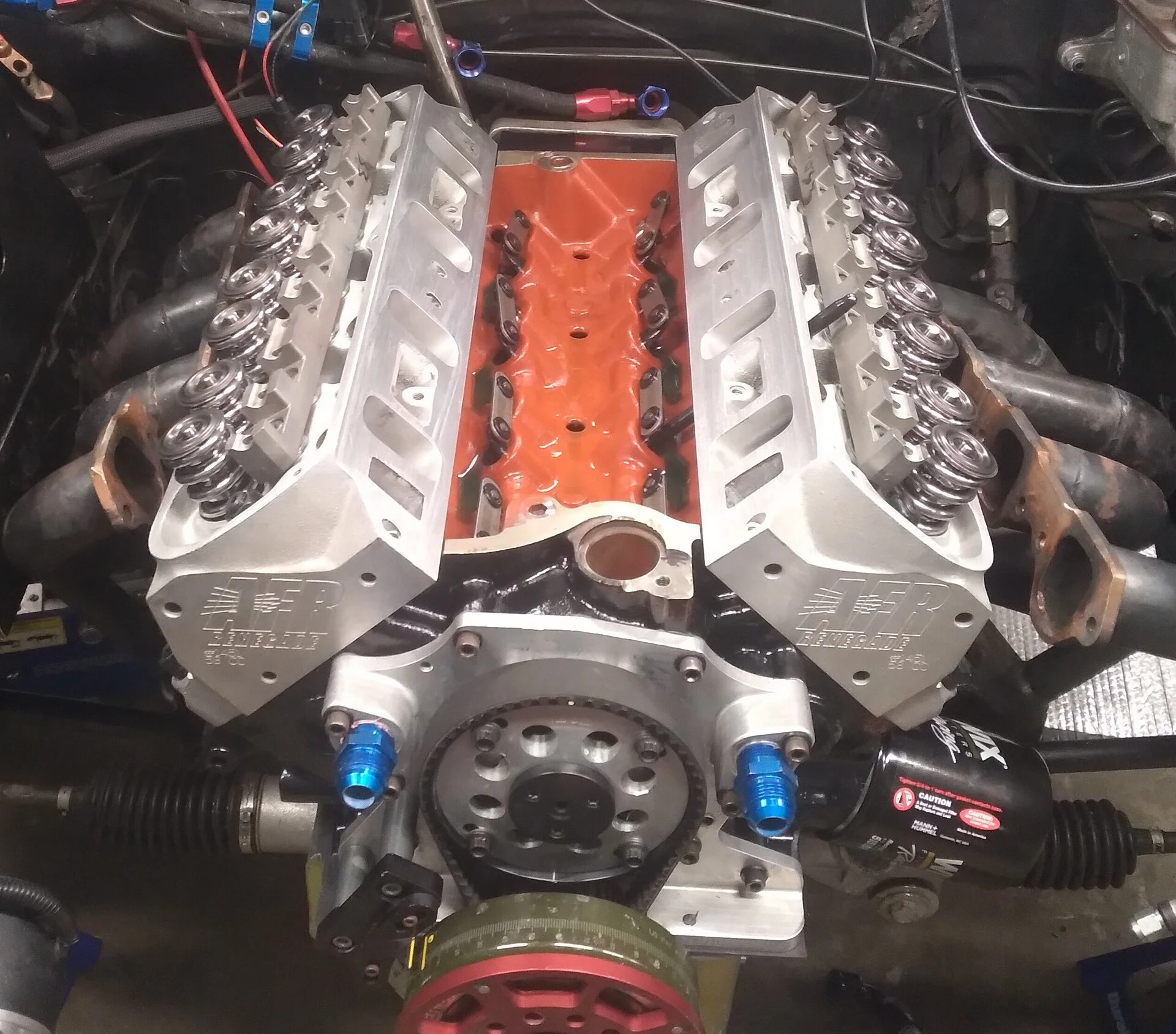

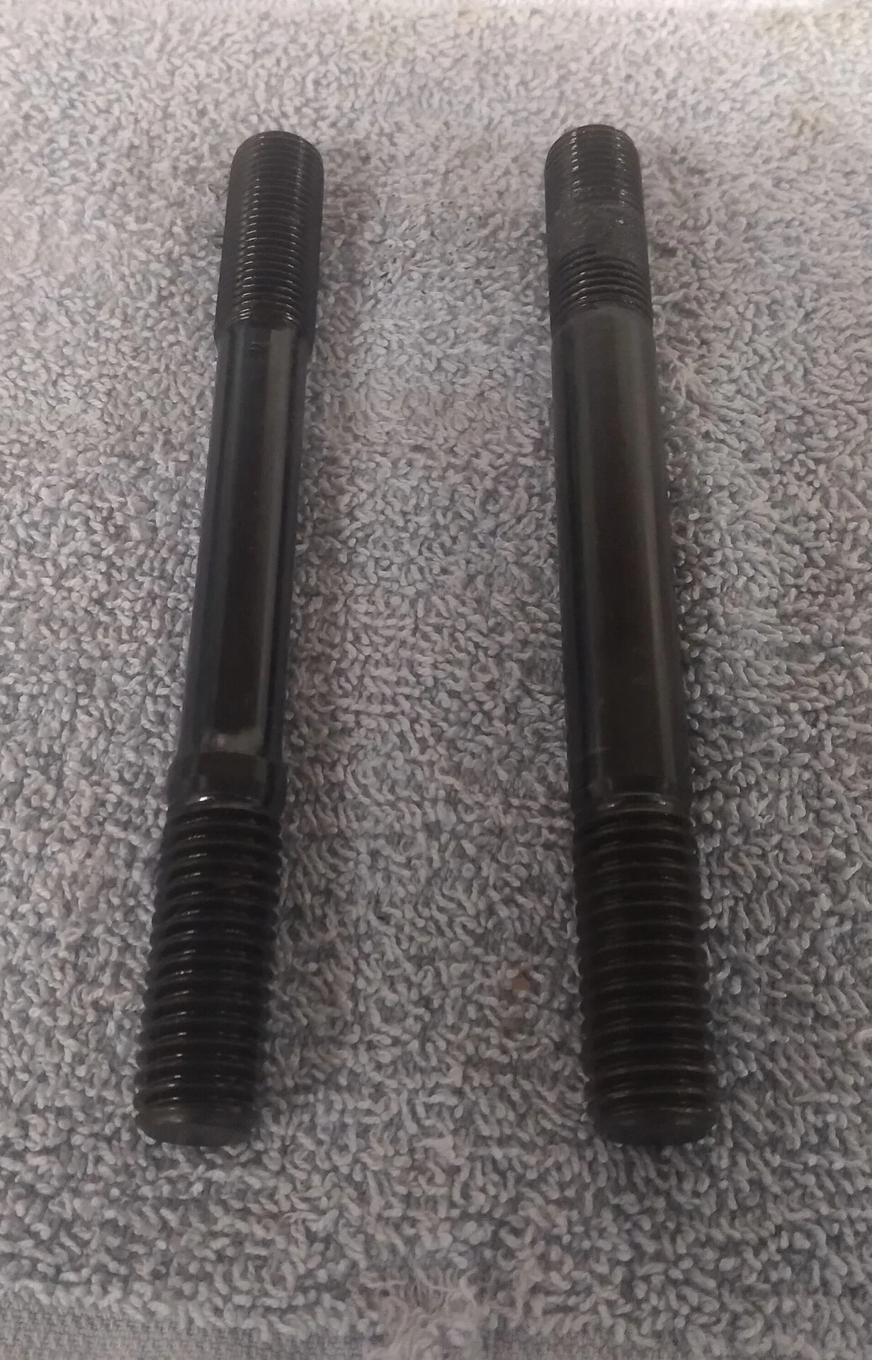

Why the undercut head studs?
Is that with the regular cut stud (on the right) the highest area of stress is right at the end of the thread, where the smooth part of the stud starts. Ideally you want the stress spread across the whole stud evenly, which doesn't happen with the standard design.
With a proper undercut head stud, they are shaped through forging and are thinner in the stud area. Even after the threads are rolled, the stress is evenly distributed through the whole stud. Thus, even though they are thinner, they are stronger then a regular stud.
This is especially critical in boosted applications where you are adding additional pressure to the head and sealing/clamping components.

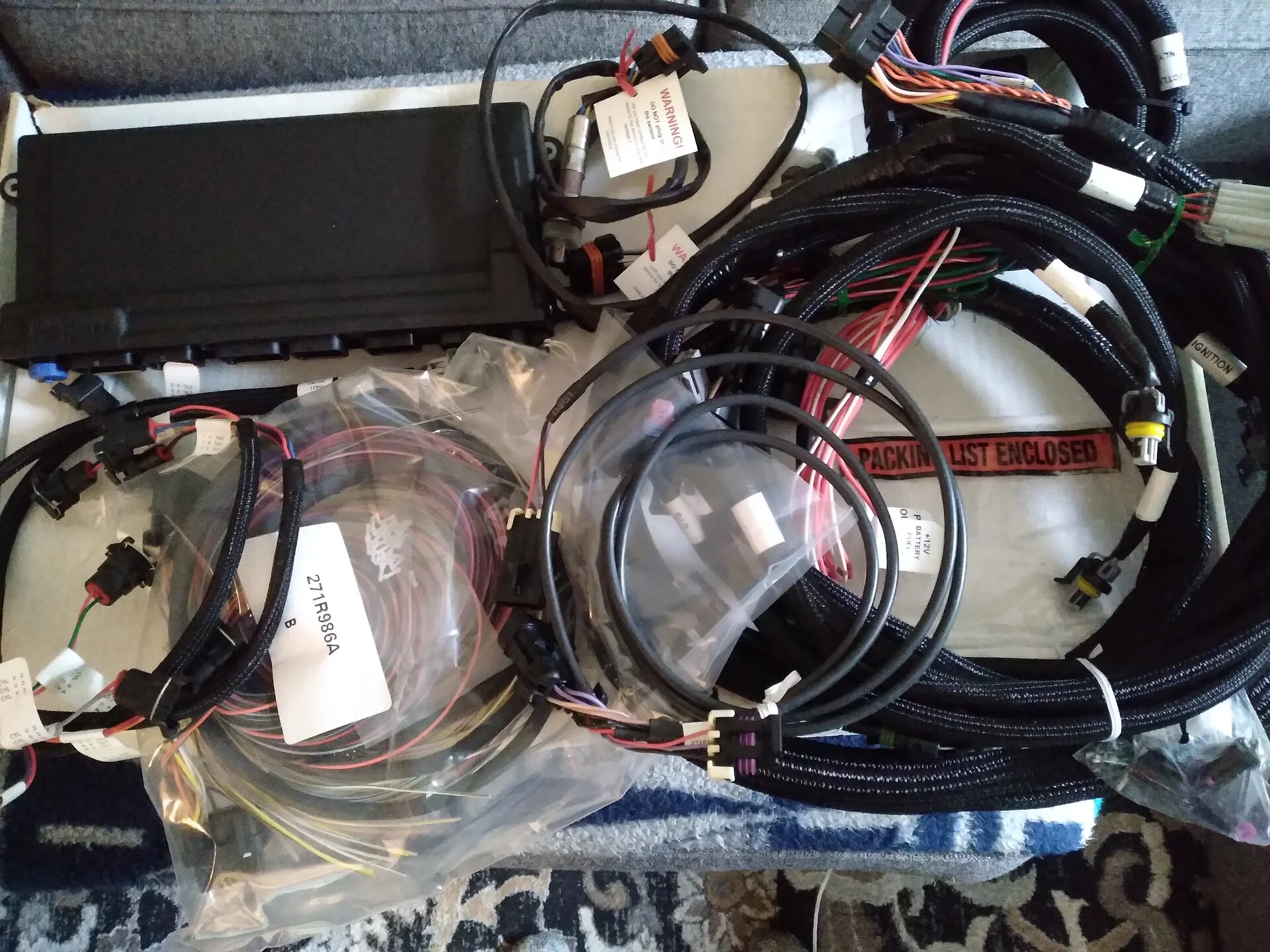

The Holley Dominator EFI system came today. I am impressed with Holley. I ordered this stuff on Friday the 27th of May, the day before a long Memorial Day weekend and it shows up today, only 4 days later, despite the long Holiday!
A lot of wiring to come. All wound up like this and it is hard to realize how much wiring there is. That ECU is HEAVY! Looking at everything this thing can do and I realize that I will only be using about 35% of the capacity of this thing. At least there is room to grow!

Now that you have all the room to grow you’ll start adding stuff quickly .
I wired in all this so far on the blue car -
Trans brake input ( for 2 step and launch retard control )
G meter
Trans temp
Laser ride height sensor
Rear shock sensors
Drive shaft speed
C02 shifter
Still have 8 egt’s in the box as well to wire up .
We also run COP with a cam sync and crank trigger deal

My car has a trans brake, but was never triggered with the Fast. Neither was the Boost Controller. I did use the Fast for a Driveshaft speed sensor and at one point had a 3 axis G meter, but never got it to work right. I will be looking to see if the Holley can operate the Boost Controller that is now done independently with a Boost Leash system. Also want to integrate the trans brake control. I did upgrade to dual wideband sensors and will probably be getting a crank case vacuum/pressure sensor. Lots of options for sure. The engine already has a crank trigger/cam sync used with the Fast.
