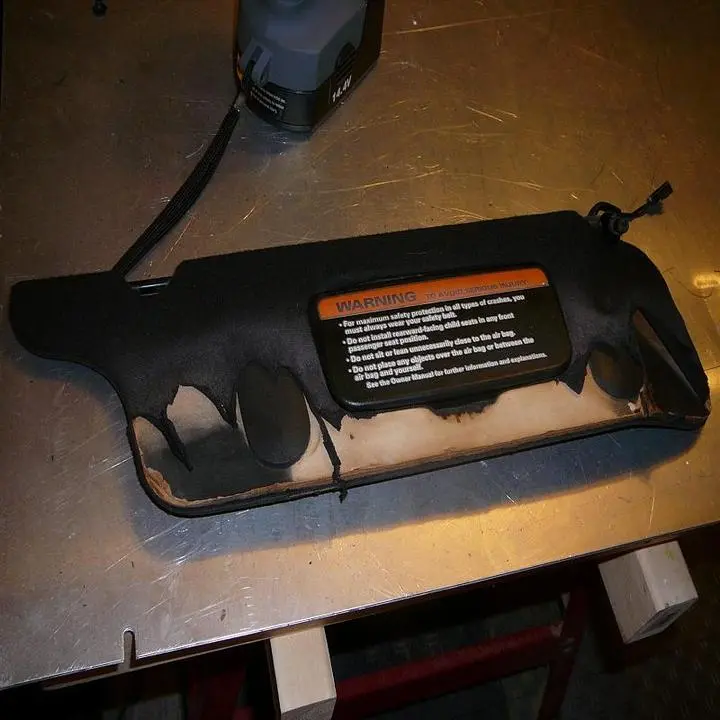

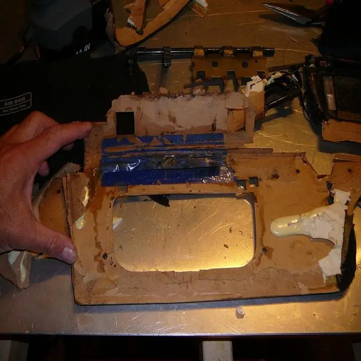

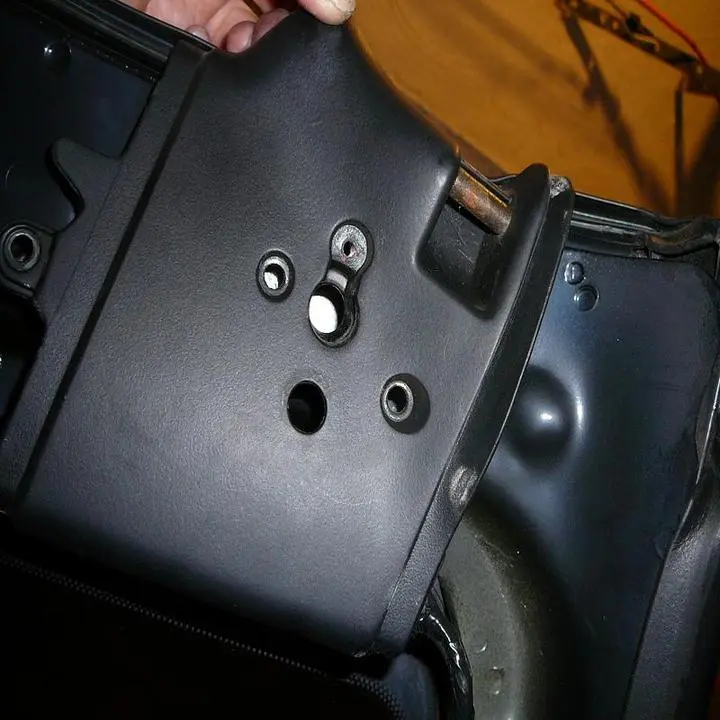

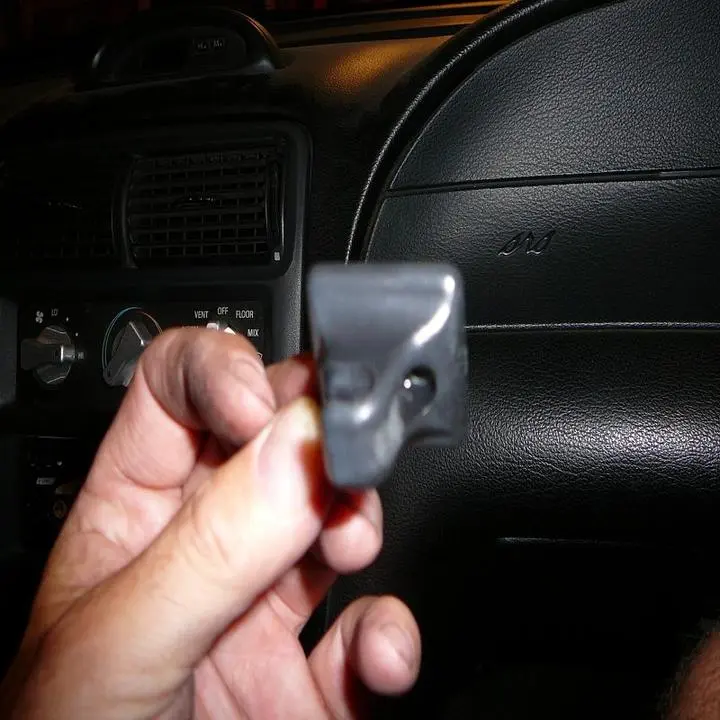

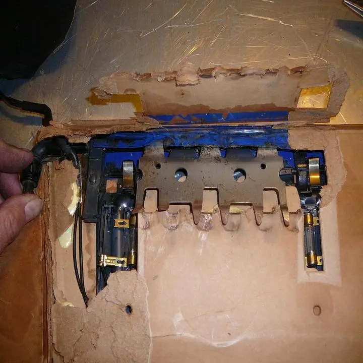

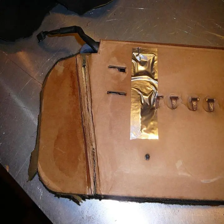

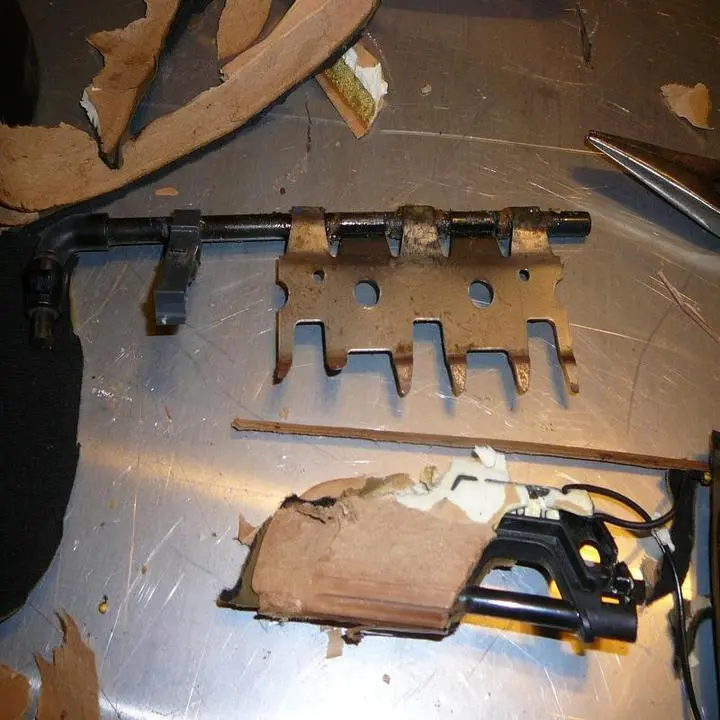

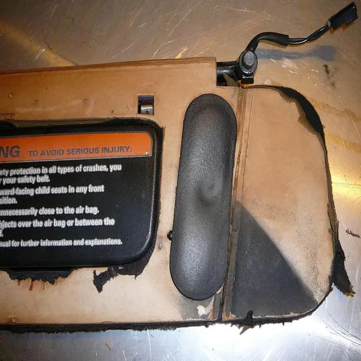

15 years in the sun .... yeah, they kinda need to be re-covered.
they are actually made of cardboard with the fabric attached with glue, so they are going to have to be completely rebuilt.

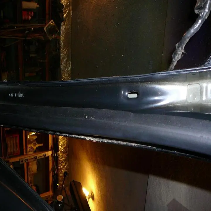

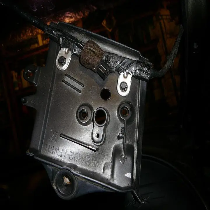

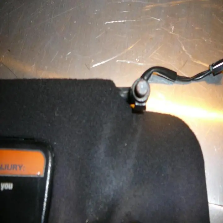

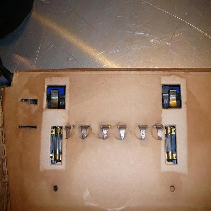

the backside of the plate where it attaches
the wiring

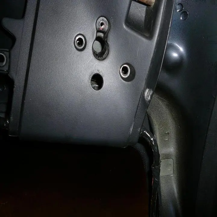

holes for mounting
the retainer

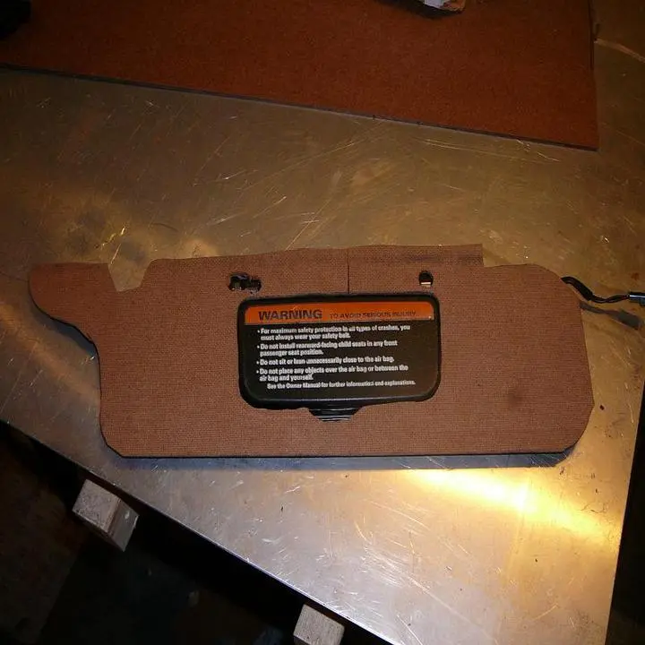

front side of the plate

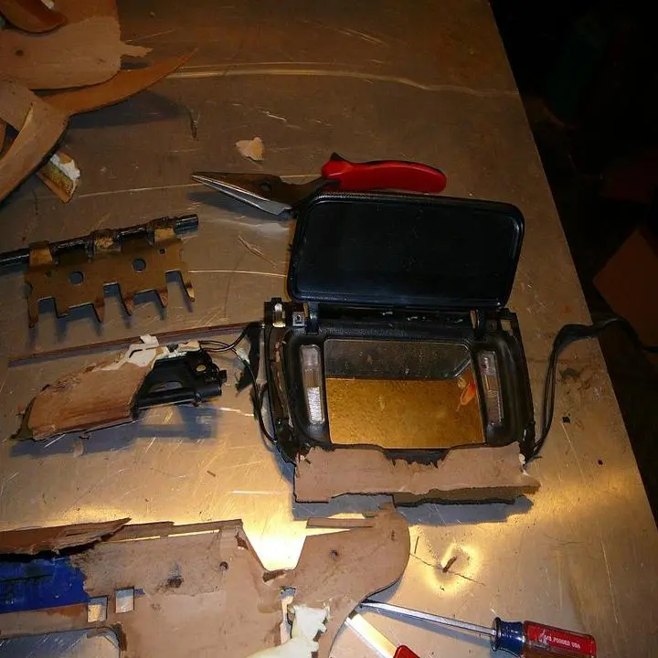

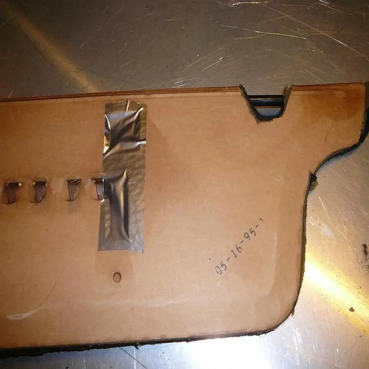

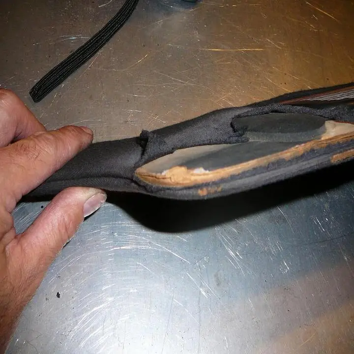

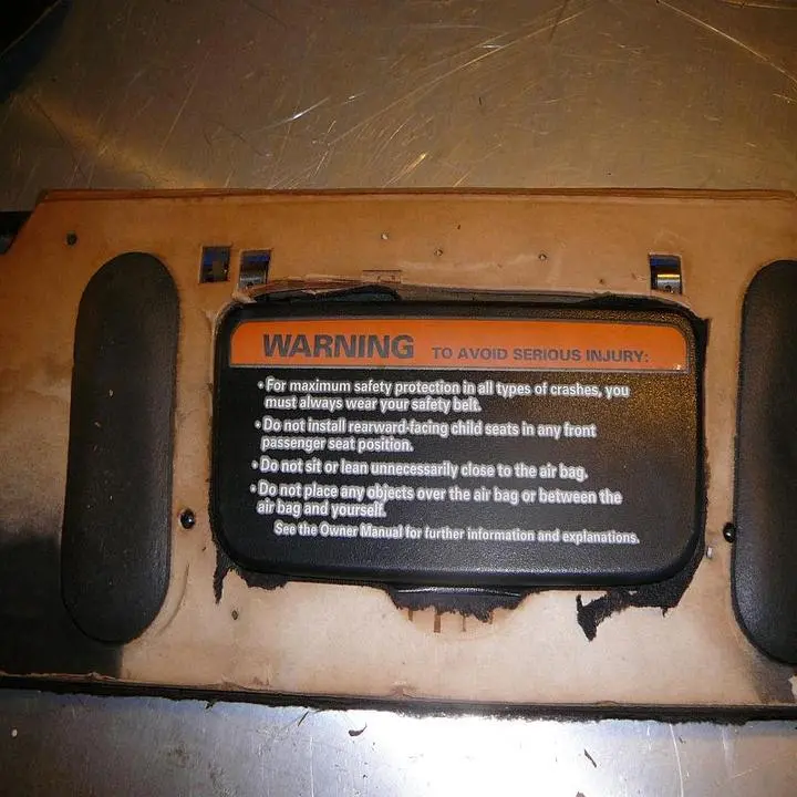

how the fabric is attached

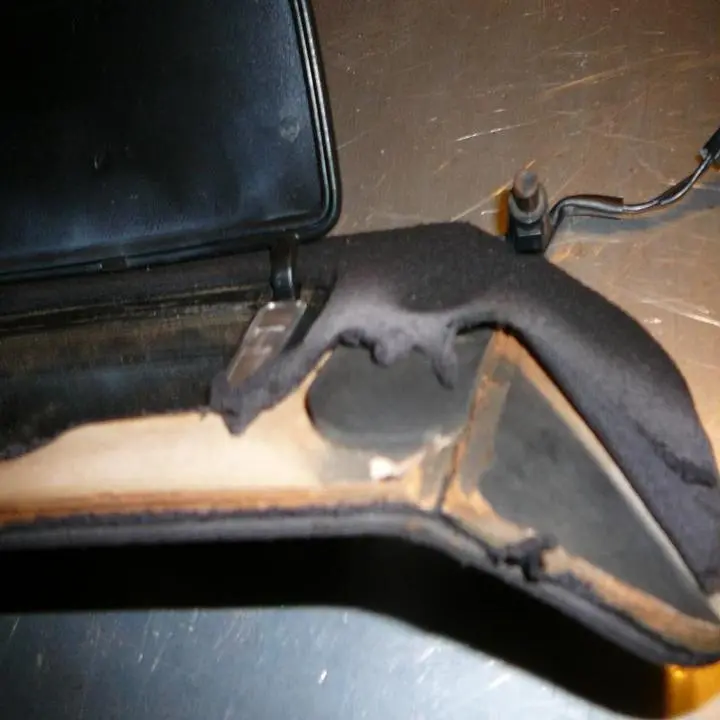

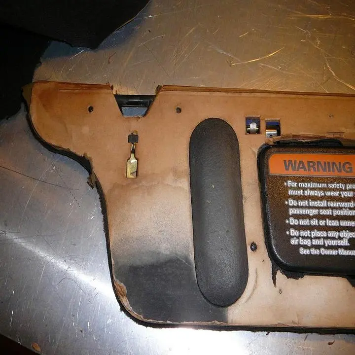

taking the fabric off

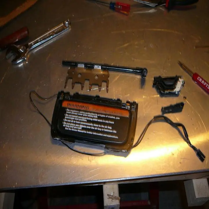

the back side

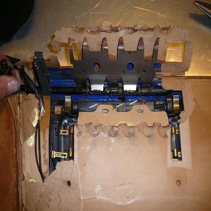

more teardown
yep, that is my blood on the mirror
guts out

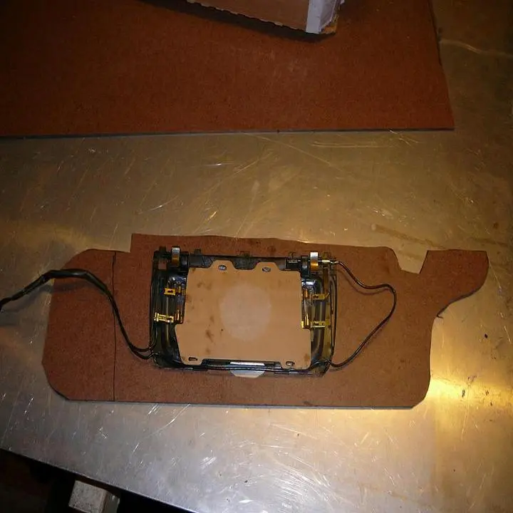

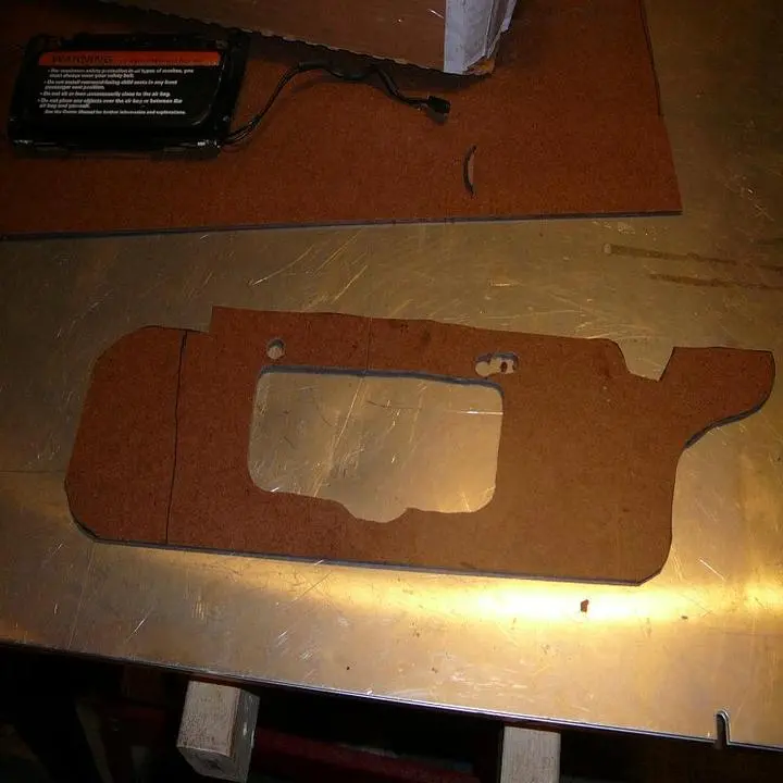

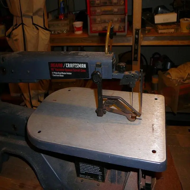

gotta love the scroll saw

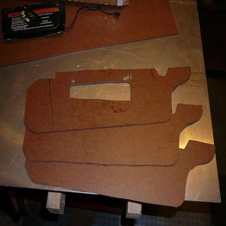

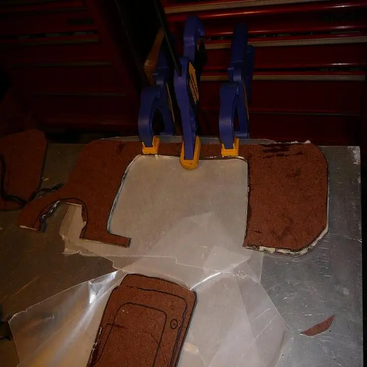

front piece ... there will be 4 total
2 pieces glued together ... for the middle

yeah, i know what you mean ... but, well you know me ... i'm a cheap bastard, and so far, i'm into it for about $20.
a pair of clean used ones i bet run over $100. i'll call prestigemustang tomorrow and get a price and post it.
either way, i'm way past the point of no return. good thing i like doing stuff like this.

i got some stretchy cotton knit stuff, which i was going to try to use.
but the more i think about it, the more i started thinking that approach will end up with something that has hard and sharp edges.
what i really need is something like that very durable cardboard stuff ford used so i can essentially duplicate their design.
for now, my current idea is to make a smaller center section with the necessary structural integrity (with the arm, mirror, and retainer), and then covering that with this very thin black carpet i found at home depot. hopefully this approach will result with something pretty close to a stock visor ... :shrug:

why not use your boards as a center section then use the cardboard as a sandwich. it will be thicker but will have the softer edges and yet be more ridged, just cut the center a tad smaller.
I am thinking along those lines too. The hardboard would definately provide rigidity, it is just too rigid though, so it is a good candidate for the center section.
I'm thinking you need some 1/16" particle or paper board. You might be able to dampen it and get the shape you are looking for.
Yeah, paper board sounds like it would be good. I have yet to find it yet.
I suspect that particle board won't be flexible enough. I soaked the hardboard for a week, and it still won't bend much without breaking.
Even something like a durable plastic that is rigid but flexible would work. I'm still looking for the perfect material.
There is a crafts place called Michael's, maybe they have something.
Hmmmm, turns out that 15" is just a little shorter than the main part of the visor (not including the part after where it bends); I actually need more like 16" or 17". So now I need to decide if I'm willing to live with visors that are a little shorter, or if I'm going to try to extend this, or go back to the hard board approach, or what the F I should do.
