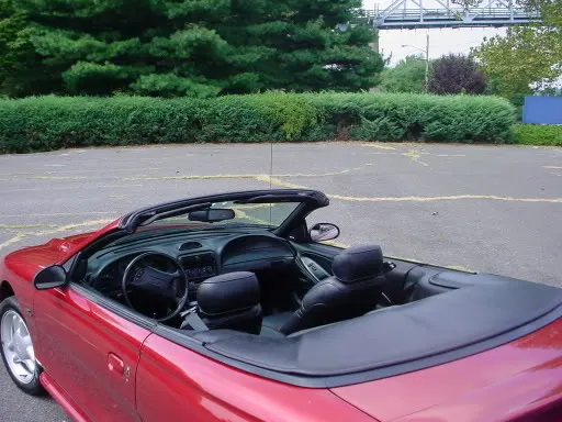

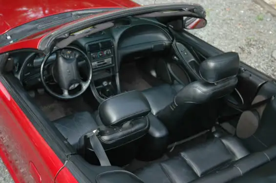

well ive done painting... a full interior actually... it was a pain in the ass... taped off the windows and everything and left the dash in the car... the problem with painting is you will be finding paint for the rest of your life... i really couldnt tell you how red paint made it from my garage to the basement... the AC filter for the house was red too... painting is a pain in the ass...and if your not to careful you are always doing touch ups... i say you just go pull an all black interior and swap it out... that would look best.... i think all black looks clean....
My interior for reference...
