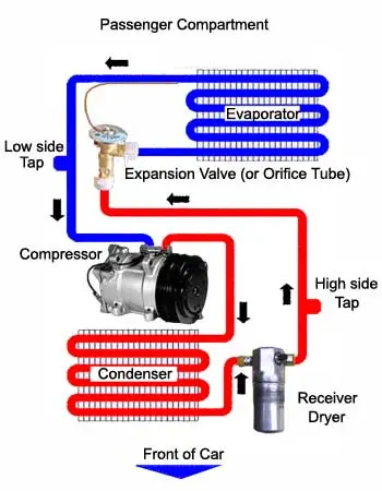

Since you are not familiar with how A/C works, here some background theory:
The condenser is up front of the radiator, and it is supposed to condense the hot gas from the compressor into a hot liquid. The hot liquid goes to the expansion valve located in the tubing next to the firewall. The expansion valve lets the hot liquid expand and become a cold gas, the cold gas goes to the evaporator inside the car where the fan blows on the evaporator exterior. The heat transfer from the air inside the car to the cold gas inside the evaporator causes the A/C to blow cold air. The now cool gas goes to the compressor where it gets compressed again into a hot gas and the process starts all over again. Keep in mind that this is a closed system, and the gas inside the A/C doesn't get out unless there is a leak, which is where you are at.
Typical automotive A/C system. This is similar to the Fox body A/C but the receiver/dryer on the high pressure side has been replaced by an accumulator/dryer on the low pressure side.
