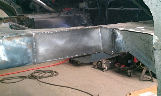

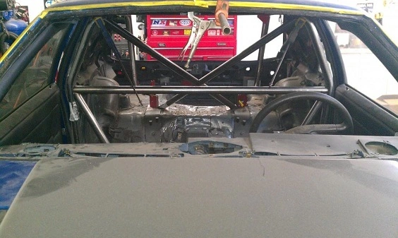

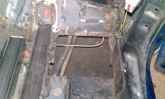

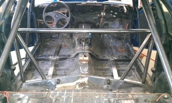

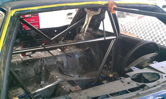

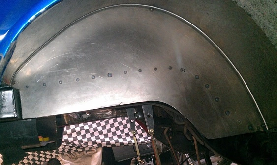

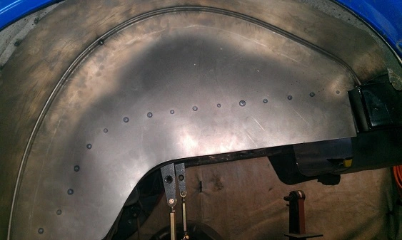

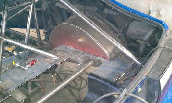

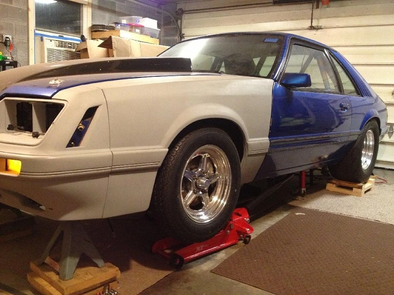

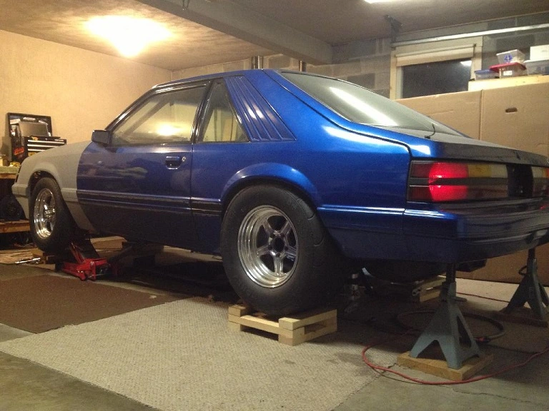

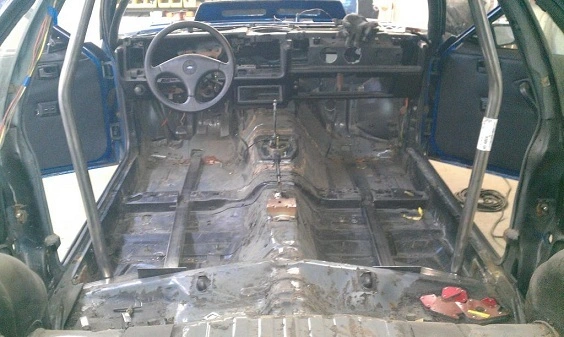

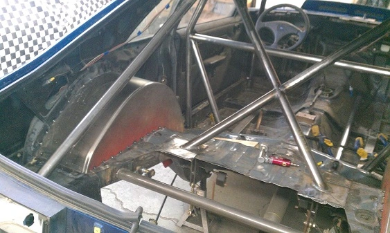

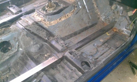

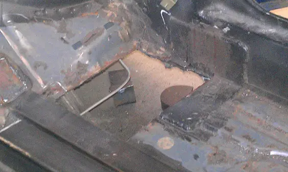

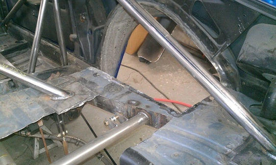

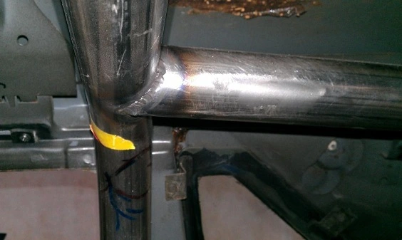

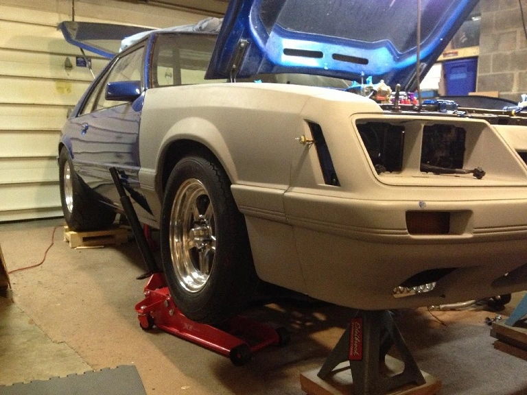

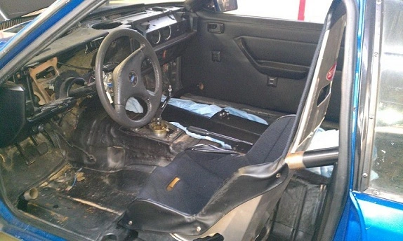

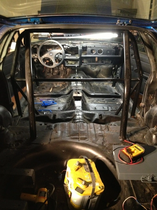

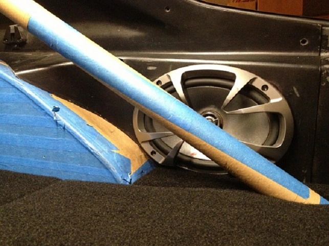

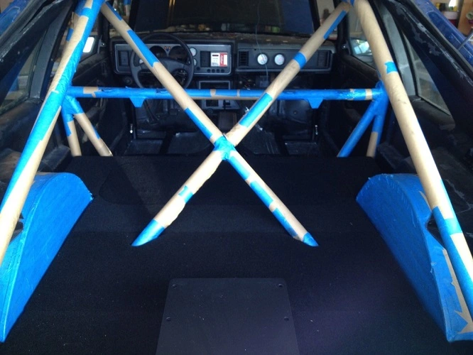

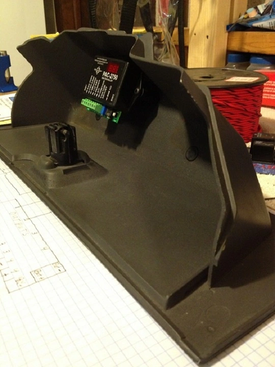

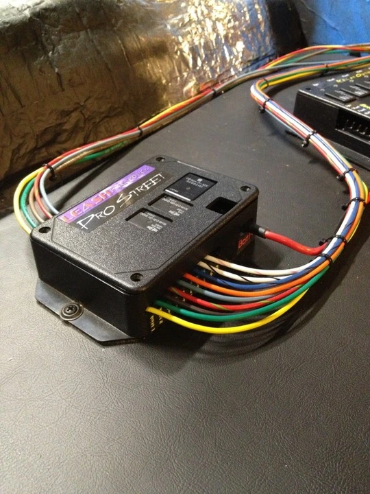

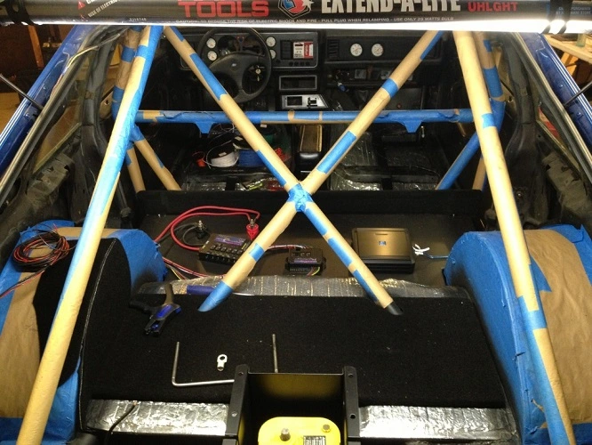

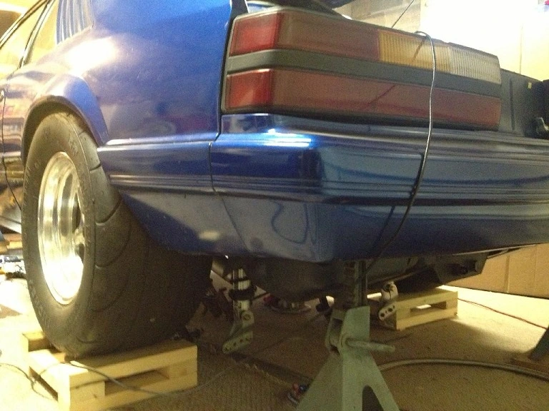

Well the front suspension is back on the car and the rear wheels/tires where mocked up for final measurements. Also, the rear has been narrowed 1" per side cause of the 15x10 wheels with 6 1/2" back spacing. We added the 9" large bearing ends to the housing plus I am keeping my SN95 Rear Disc brake set up with parking brakes. The Moser axles were ordered already and should of been delivered by now. Here are some more pics of the mock up we did:

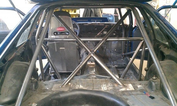

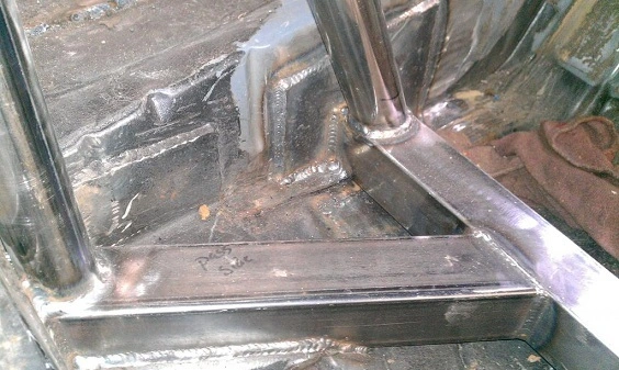

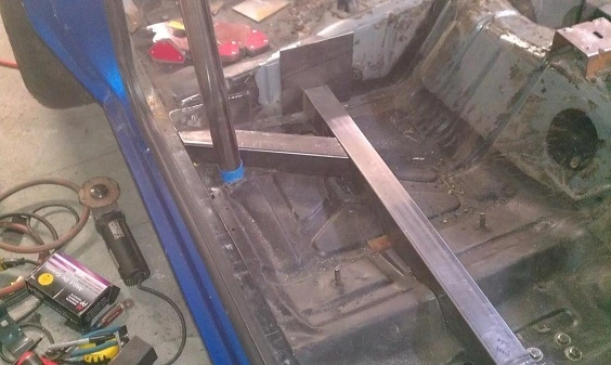

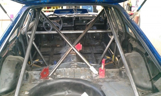

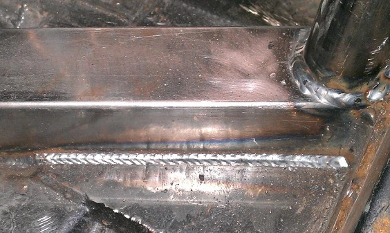

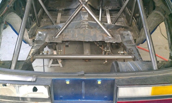

WOW! Seems some the chassis pics got deleted. Here they are again:
