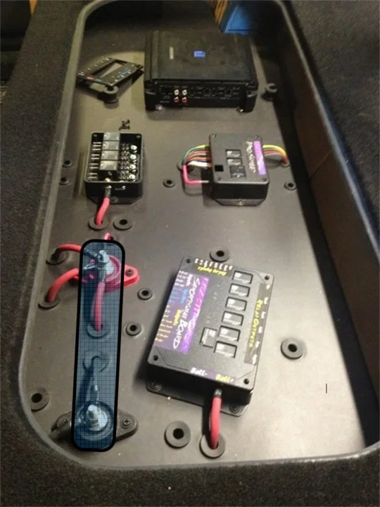

Thanks, that is a Great idea! I also have a panel that covers the opening when ever I do not want to show it off or while I am driving it.Very nice work. I would make one change; add a rectangular piece of clear plastic sheet as a cover over the two electrical power posts.
This is also a recommendation for any terminal strip like the one for the fans. This prevents things that get dropped from bridging the power to ground or other parts of the circuit.
