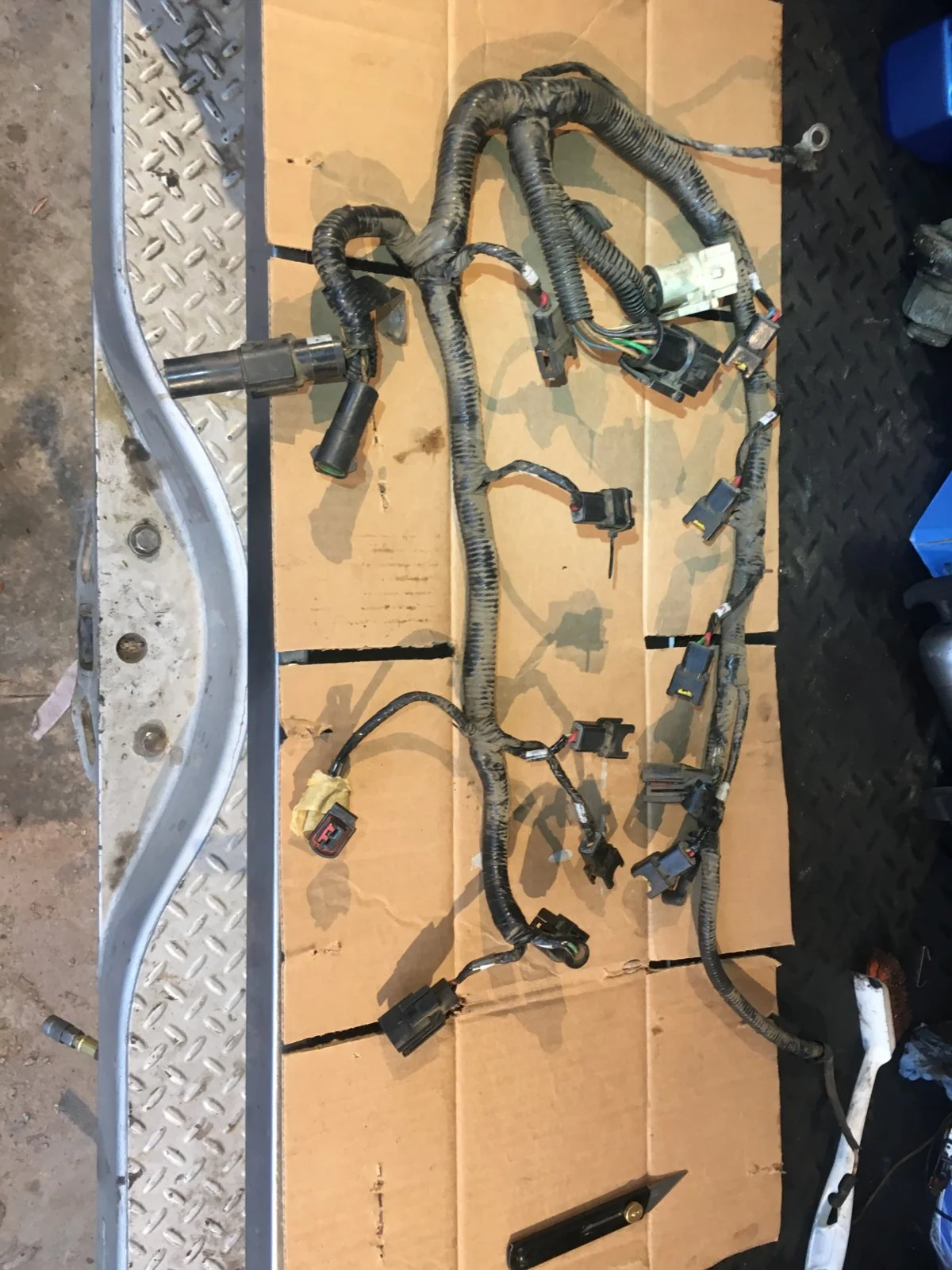

30-year-old 89 fox body injector harness stiff as hell feels like solid strand wire

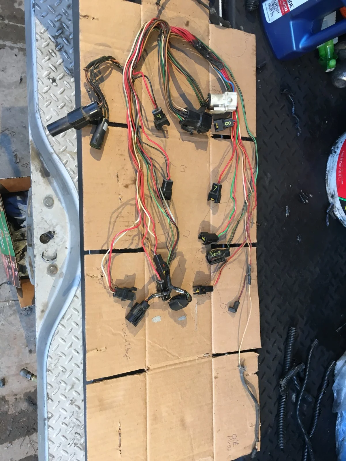

Here is everything stripped down that was the toughest part the old heat shrink tape was hard as a rock very difficult to cut off without nicking insulation on wire

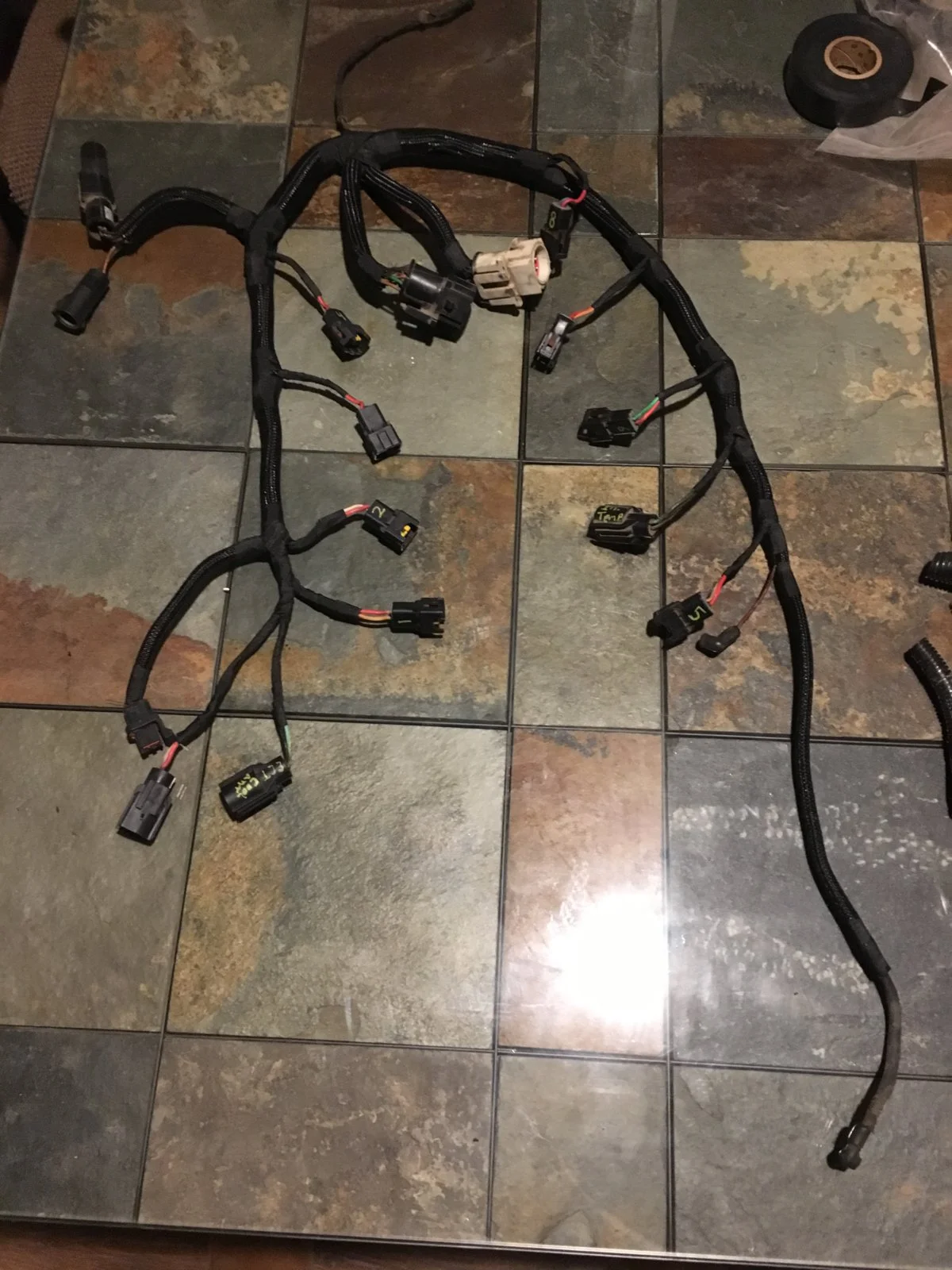

Here is the finished product
My fingertips are sore but it was worth it

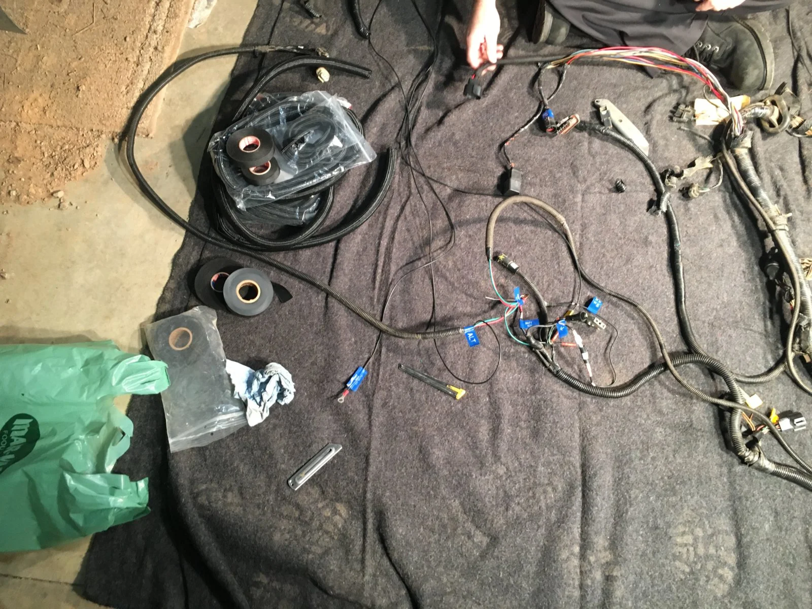

I got two rolls of the engine harness tape and one of the felted (quiet) tape.
That was easily enough for everything in the engine compartment
I mostly just wrapped it up with the braided split loom and used the Tessa tape for the ends and branches.

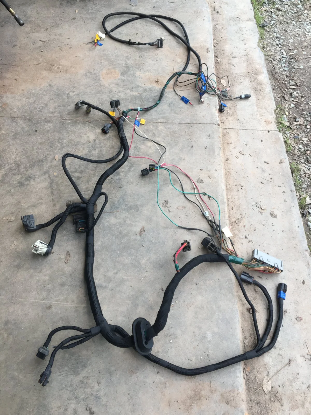

This harness is going to the 1965 fastback EFI conversion basically a hot rod car will see very little miles (not daily driven) if it were a daily driver I would probably wrap the wires with non- adhesive wire harness tape (to protect from water) then cover with loom.
Here is the main harness before and after pics
