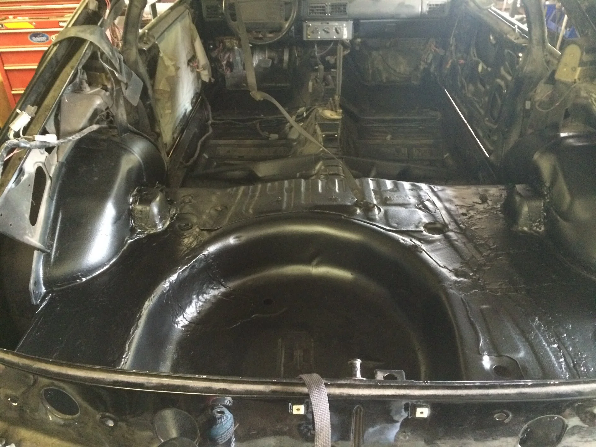

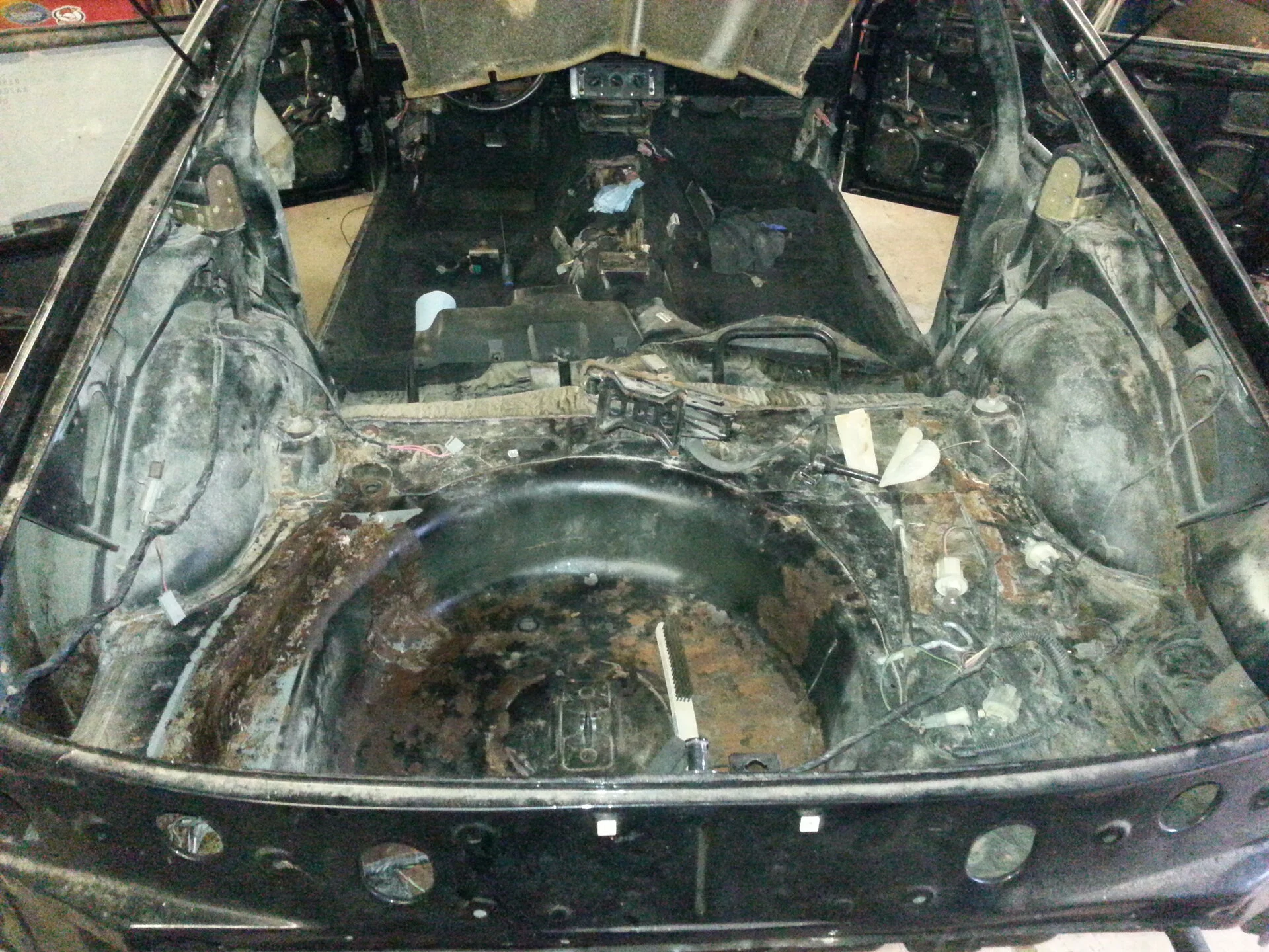

Does anyone with a 90-93 Mustang hatch have their interior out? If so, can you provide some pics of how these brackets are welded?
Adding them to my 88 and want to see how Ford did it

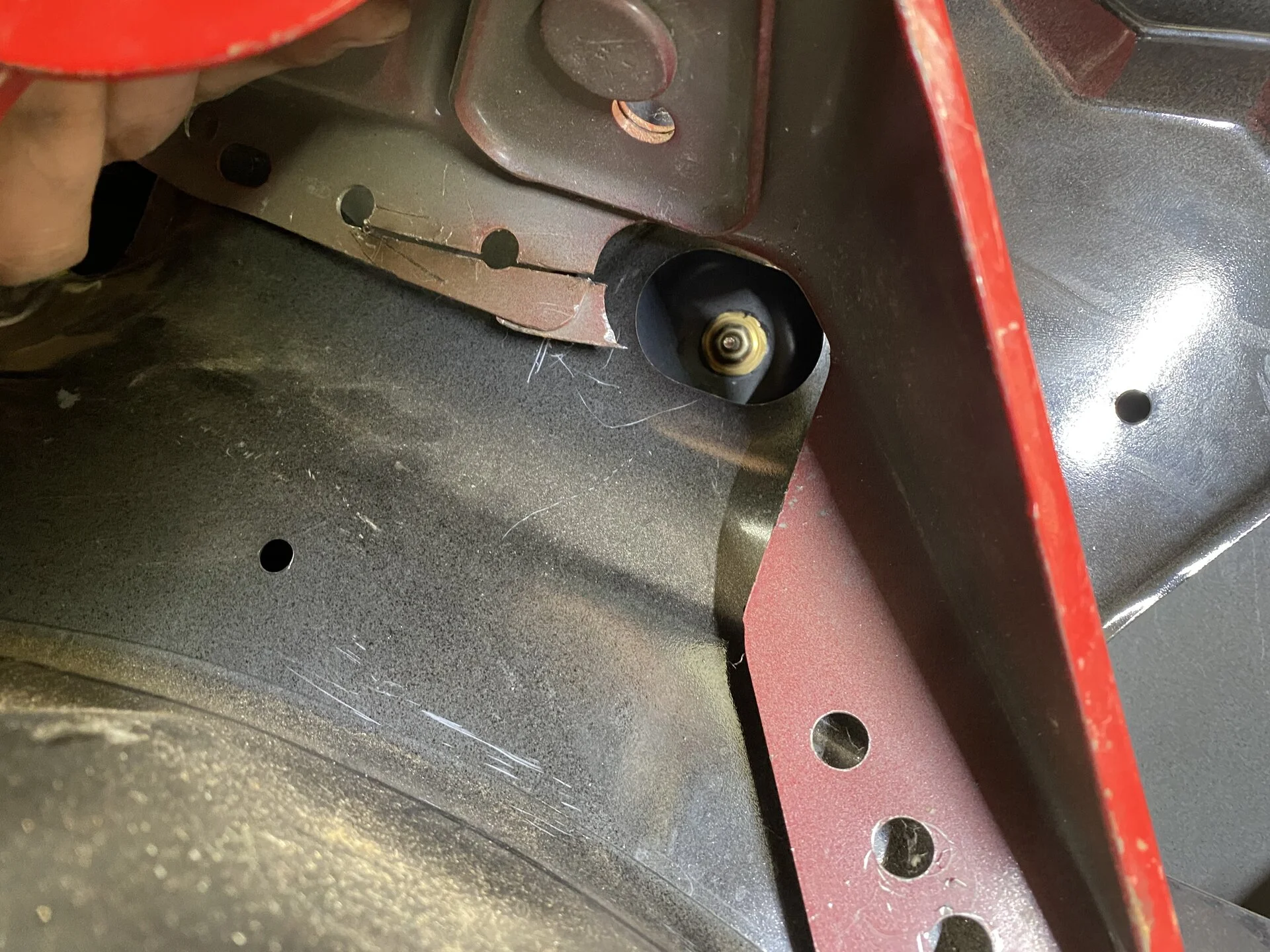

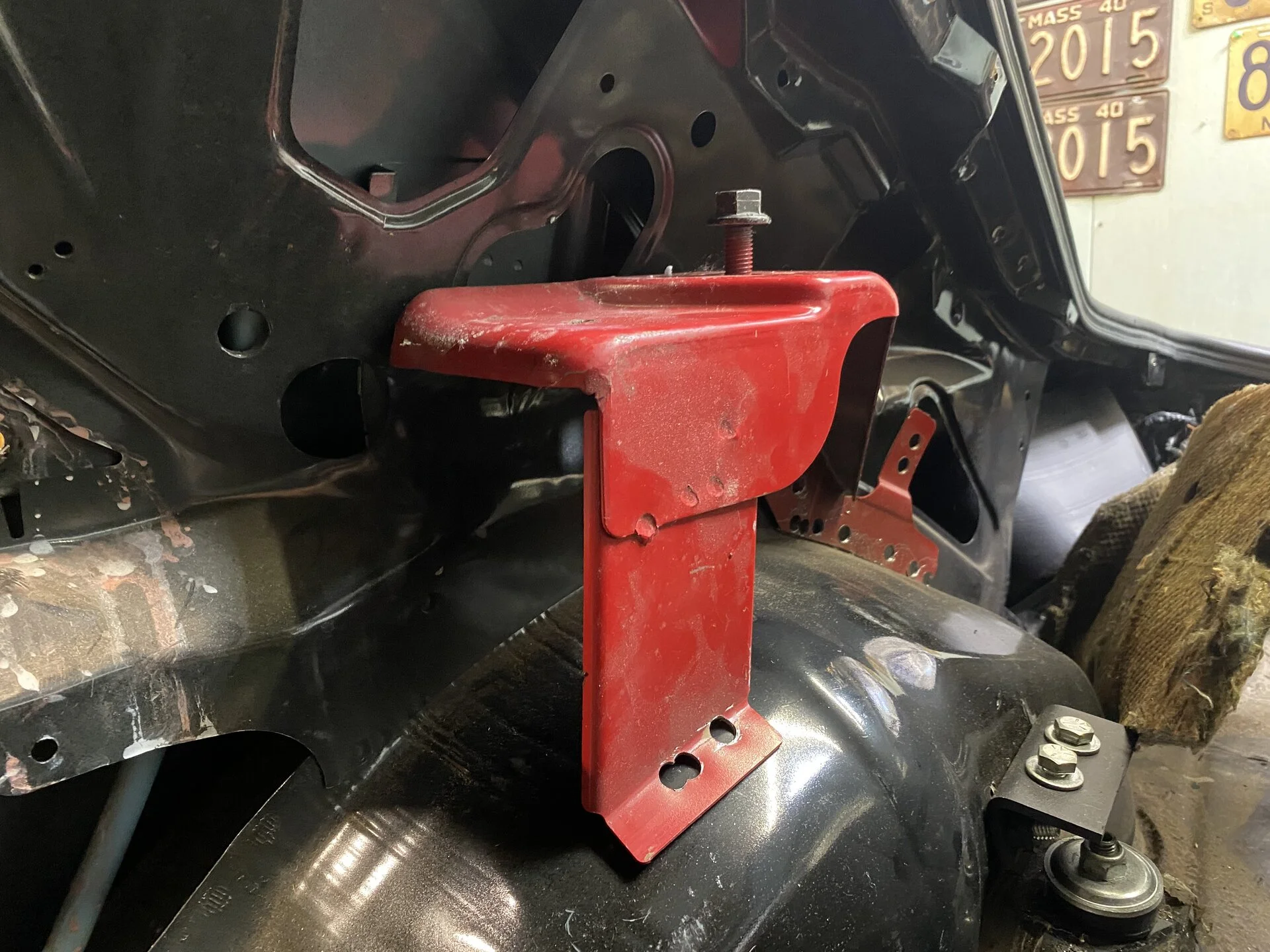

Found the braces themselves have a reference point based on the access hole for the window stud
With that lined up, it all falls into place.
Pass side is easy. Drivers side the sheet metal is nt 100% accurate for mating up but you can make it work.
