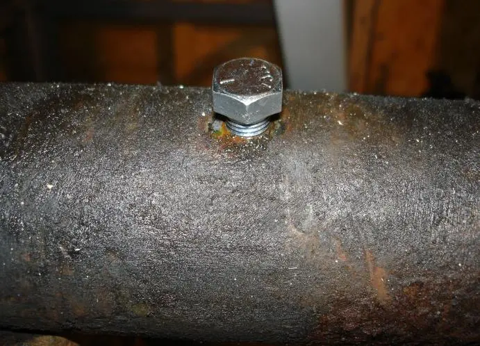

1.) Axle tube vent. What size threads are these so i can get a plug for it while i clean and paint it.
You don't. just leave it open and clean everything.
Glass bead blasting is the quickest, easiest method to do the outside of the assembly.

Thanks. I did take it off already. But i didn't want an open hole when they blasted it.
I just need something to cap the ends where the axles were since they are now open.
