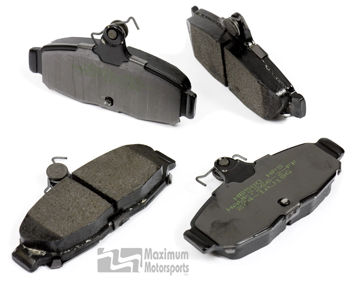

Pretty sure. Dont know how to word this, but the pads we pulled off the calipers were equal length to each other. The pads to be put on were larger and one was about an inch smaller than the other...
And yeah, the set i bought was for the rear disks of a 87 turbocoupe.
Pads should look like this
Yep, definitely didnt look like those. haha. Well, ill take mine back, and hit up MM. I like dealing with them, although their shipping time seems to be a bit long. Of the 2 or 3 orders ive placed with them, it took 2 days to just process the order, then almost 4 days of shipping.. not counting the weekend.
