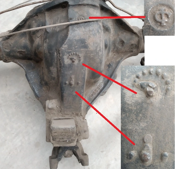

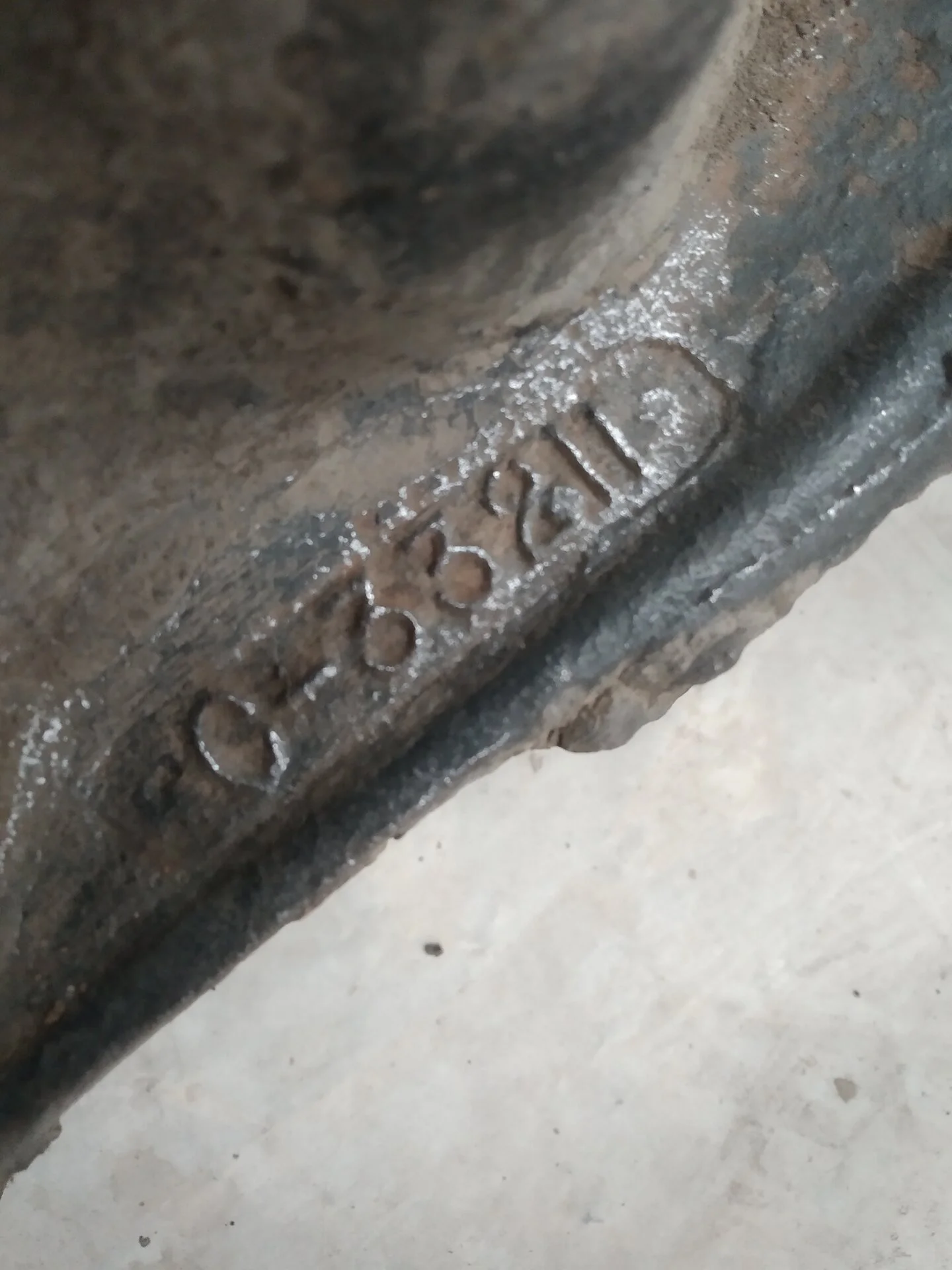

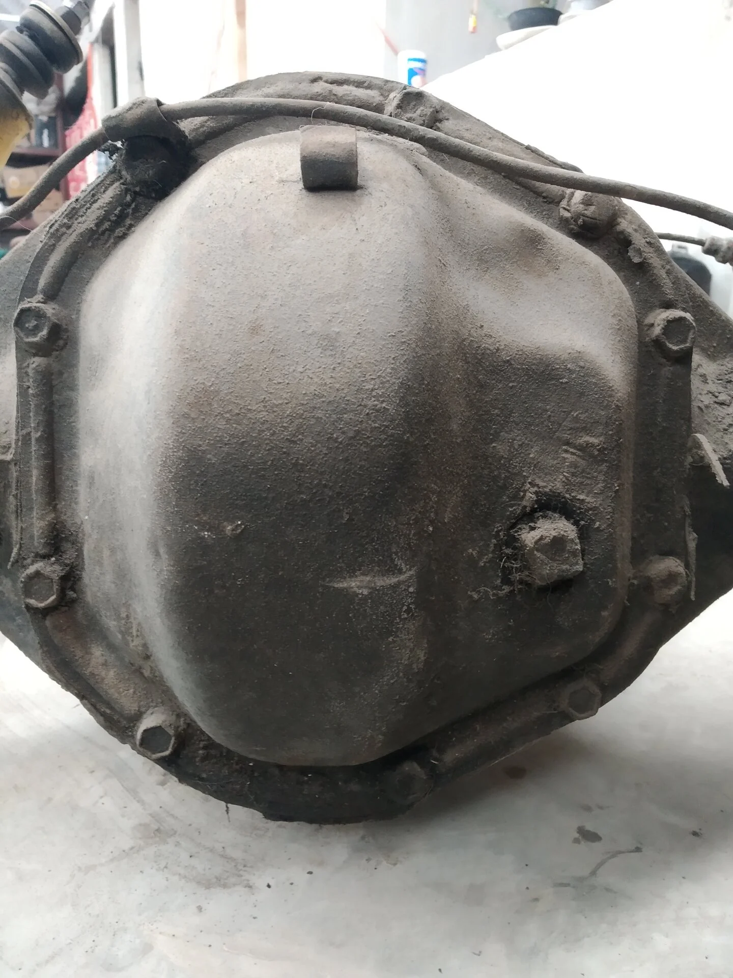

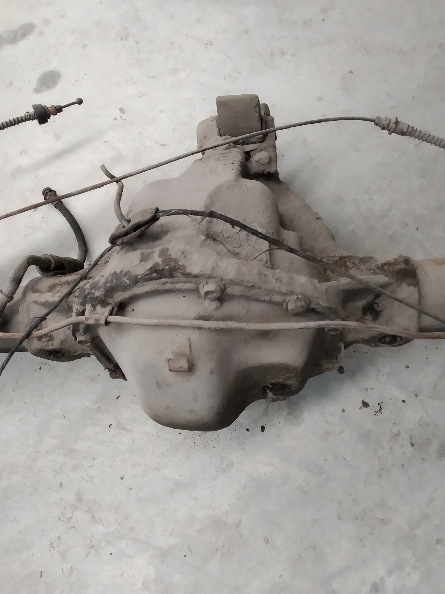

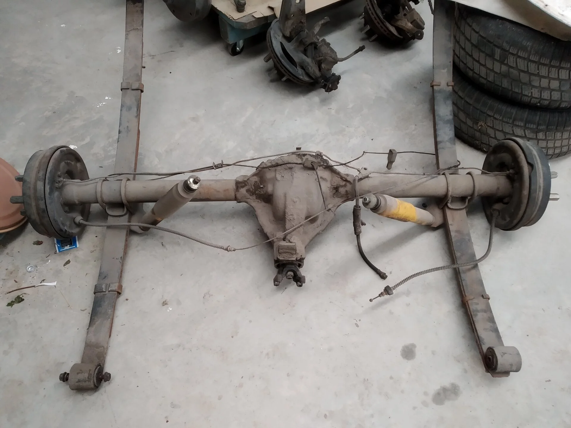

Hi everybody! I am working in my Mustang '68. I bought it with this Cutlass wheels (will be replaced) and here is my rear end. Somebody knows if is from Ford or GM? Thanks in advance!
How many bolts holding rear cover on?
Is there a tag?
Have mounting points been cut off?
Such a dirty lump its hard to tell.

I haven't put any 8.8s in a vintage mustang...but on my last '66 I did actually have a 7.5" with rear disc from a Mark VII if I remember correctly? The 7.5 and 8.8 in the fox were the same width...you can fit a 8.8" from a foxbody in a vintage mustang, but the wheel offset will change(more dramatically for 65-66 than for 67-68) so if you do so...you may be forced to use later model wheels(which also means you will need spacers to use them on the front). One way around it is to shorten the 8.8", but then you get into custom length axles, etc. It really depends on what you need as far as strength goes and what wheels you are wanting to use with it. The best axle choice is going to vary from build to build. That being said...the 8.8" is an excellent choice if you need something that comes with factory LSD and rear disc brakes...but it will require work to properly fit a vintage mustang. The 8.8" you choose needs to be thoroughly researched as well.(If I were to do the swap myself, I would choose an 8.8" from an explorer, shortened on the passenger side, and using 2 driver's side axles, then run whatever spacers were required to correct the wheel offset....its the most well-known way to do it...but there are plenty of other ways. The best unit you could start with for example would be a 2014 Mustang GT 8.8"....since its new and easy to find, the clutch packs would be in good condition...the downside being that custom length axles would be required(pretty sure the explorer axles inner spline isnt the same as the late model mustang, but I could be wrong on that).
That being said, there are plenty of others out there that would be able to give you better details than me on the swap.
