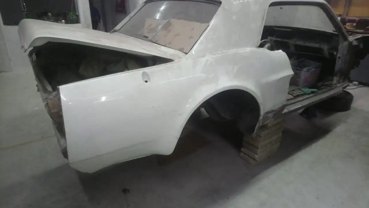

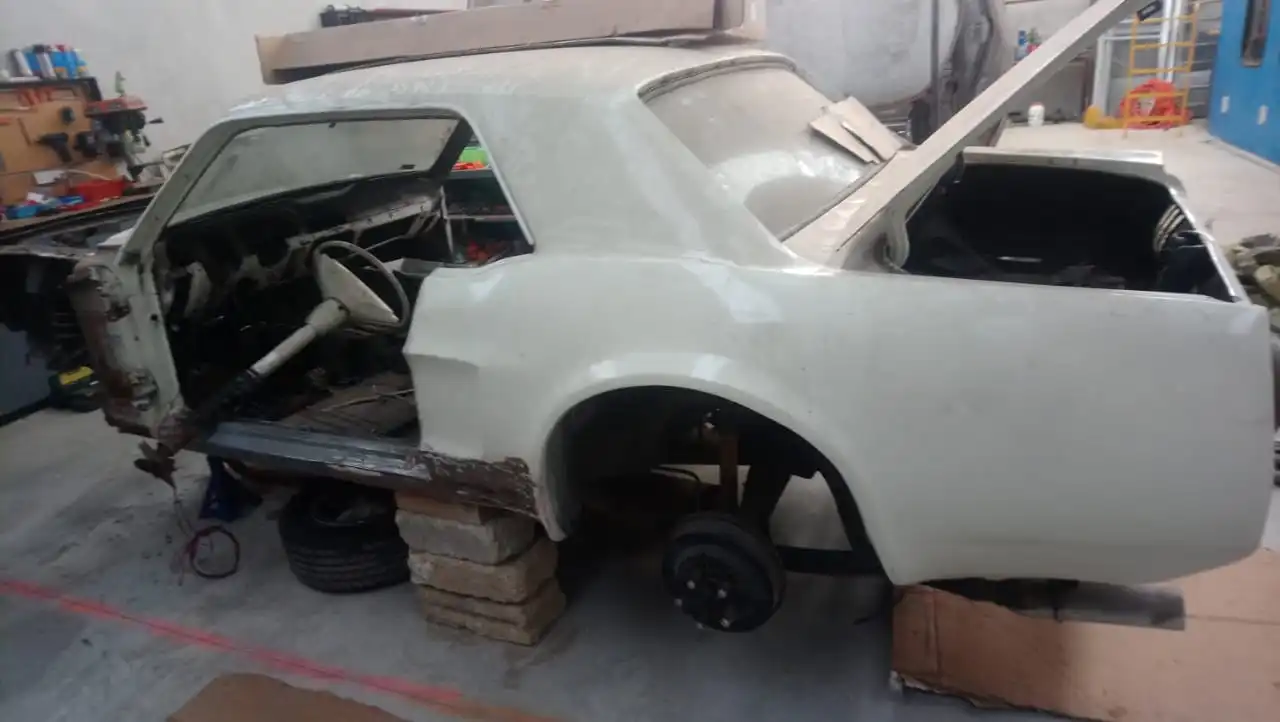

We need more pictures of your car.
In progress is fine
In progress is fine
Here they are:

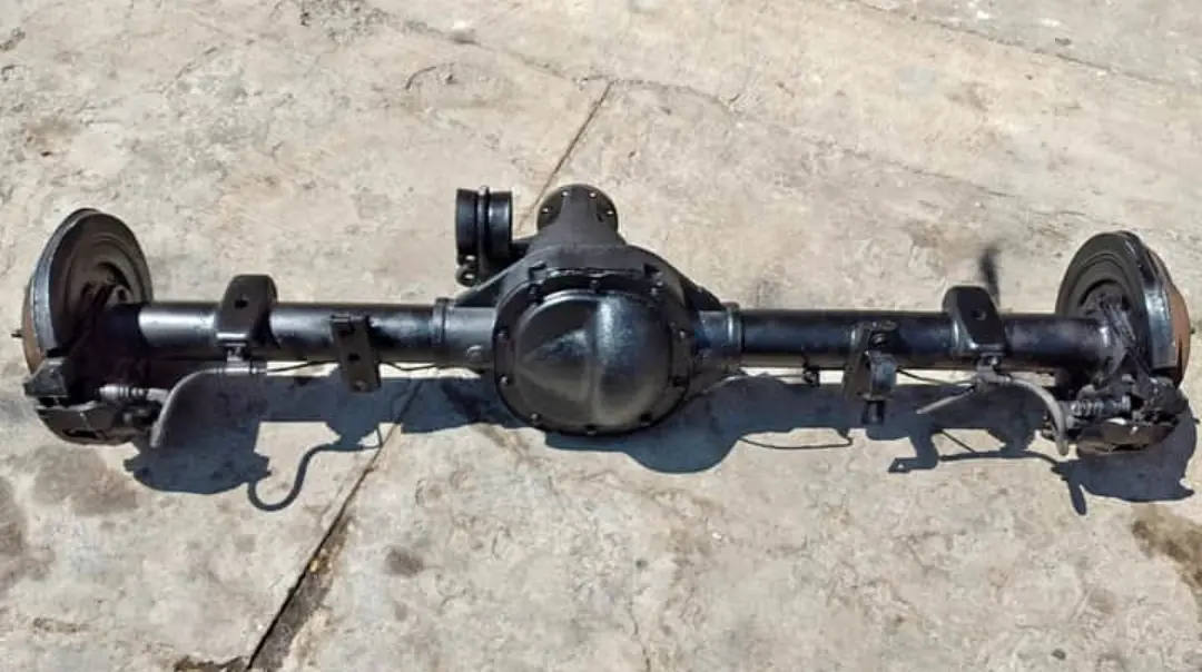

wicked93gs said:
I haven't put any 8.8s in a vintage mustang...but on my last '66 I did actually have a 7.5" with rear disc from a Mark VII if I remember correctly? The 7.5 and 8.8 in the fox were the same width...you can fit a 8.8" from a foxbody in a vintage mustang, but the wheel offset will change(more dramatically for 65-66 than for 67-68) so if you do so...you may be forced to use later model wheels(which also means you will need spacers to use them on the front). One way around it is to shorten the 8.8", but then you get into custom length axles, etc. It really depends on what you need as far as strength goes and what wheels you are wanting to use with it. The best axle choice is going to vary from build to build. That being said...the 8.8" is an excellent choice if you need something that comes with factory LSD and rear disc brakes...but it will require work to properly fit a vintage mustang. The 8.8" you choose needs to be thoroughly researched as well.(If I were to do the swap myself, I would choose an 8.8" from an explorer, shortened on the passenger side, and using 2 driver's side axles, then run whatever spacers were required to correct the wheel offset....its the most well-known way to do it...but there are plenty of other ways. The best unit you could start with for example would be a 2014 Mustang GT 8.8"....since its new and easy to find, the clutch packs would be in good condition...the downside being that custom length axles would be required(pretty sure the explorer axles inner spline isnt the same as the late model mustang, but I could be wrong on that).
That being said, there are plenty of others out there that would be able to give you better details than me on the swap.
The owner told that is from explorer, no from fox, he write it wrong. There is a number code or something like that to differenciate a explorer version from mustang fox? Price was around 200 usd with 3.25 (or something like this), but he give me the oportunity to get the upgrade 3.73 for 200 usd extra, I decided 3.73 + T5 manual + transmision cardan.

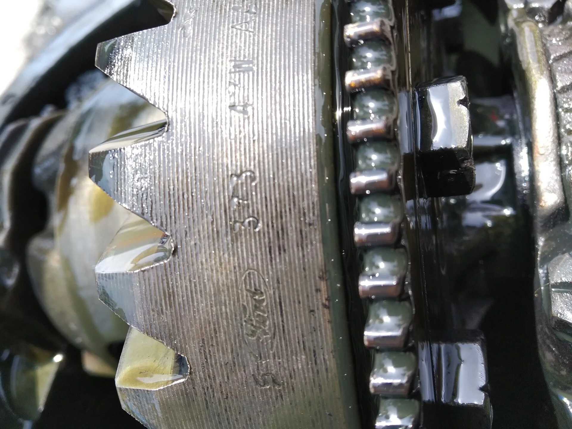

@wicked93gs Do you know how to differenciate the foxx 8.8 rar end from the explorer 8.8 rear end? Some numbre codes? TIA
wicked93gs
Sep 30, 2006
1,198
229
93
Nashville TN
Jul 22, 2020
#36
  • Jul 22, 2020
  • #36
easy way to tell...an explorer 8.8 often has disc brakes and 5 lug, aside from the 93 Cobra, I believe all fox 8.8s had 4 lug and rear drums(though of course they can be changed to 5 lugs with the correct axles and rear discs) Also, the carrier is offset on an explorer rear end....the one axle is longer than the other(which is why shortening them people often use 2 of the shorter side axles)

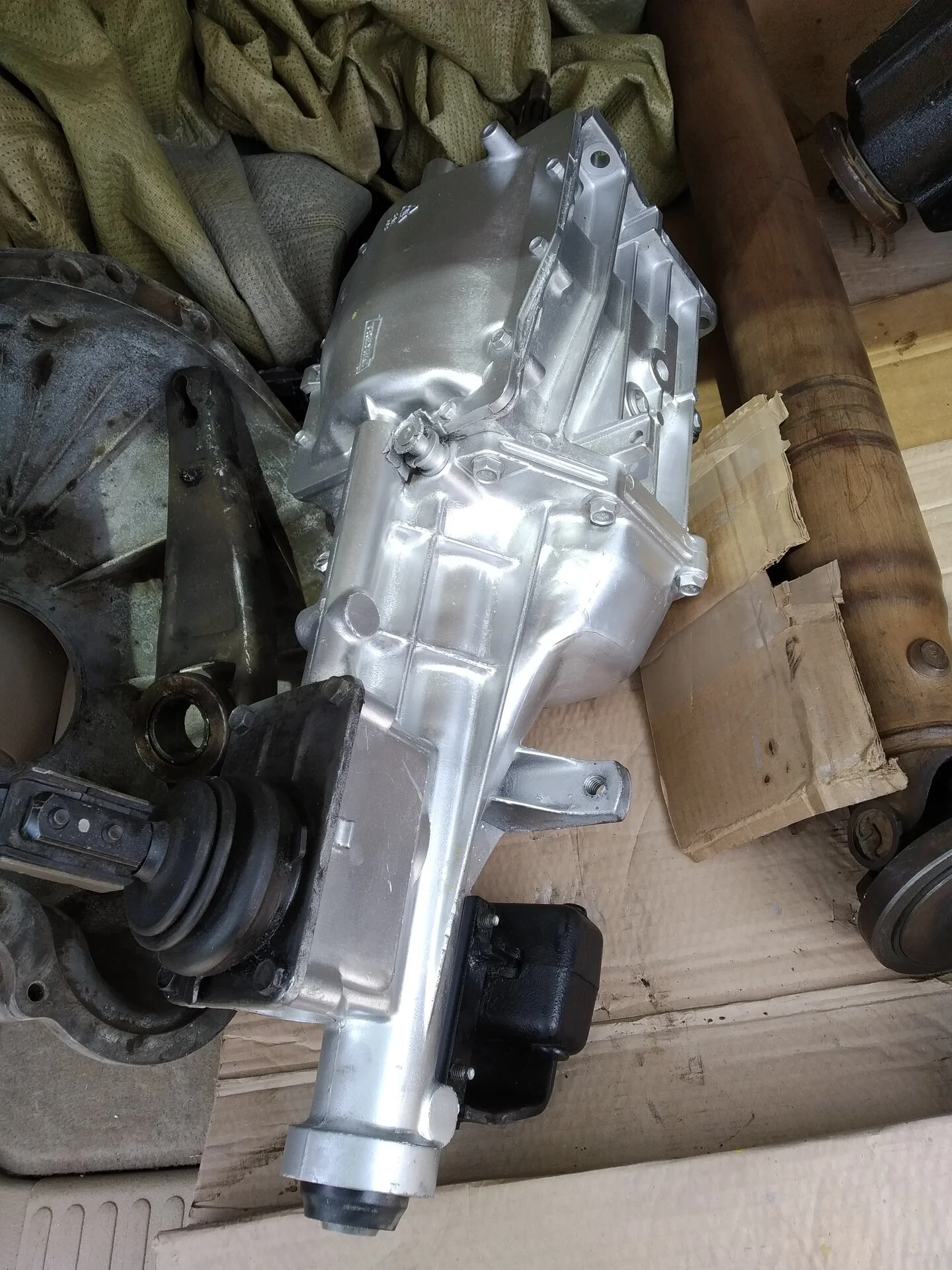

And finally I got my new gifts...
Rear end 8.8 Mountaineer posi + 3.73
Tremec T5 Mustang '95
Cardan Mustang '95
Thank you everybody for your help!
Reactions: Olivethefet and 2Blue2

Hi! Somebody knows wath kind of oil to use for differential an gearbox?
The seller told me to use automatic gearbox oil (Dexron III), because the manual gearbox oil it doesn't work properly.

That t5 uses automatic transmission fluid. I forget what goes in the rear end. 75-140?
