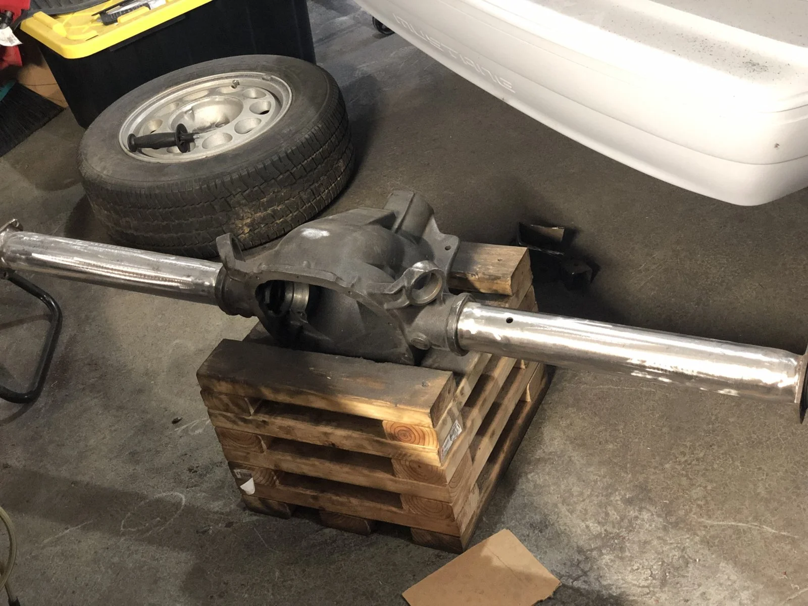

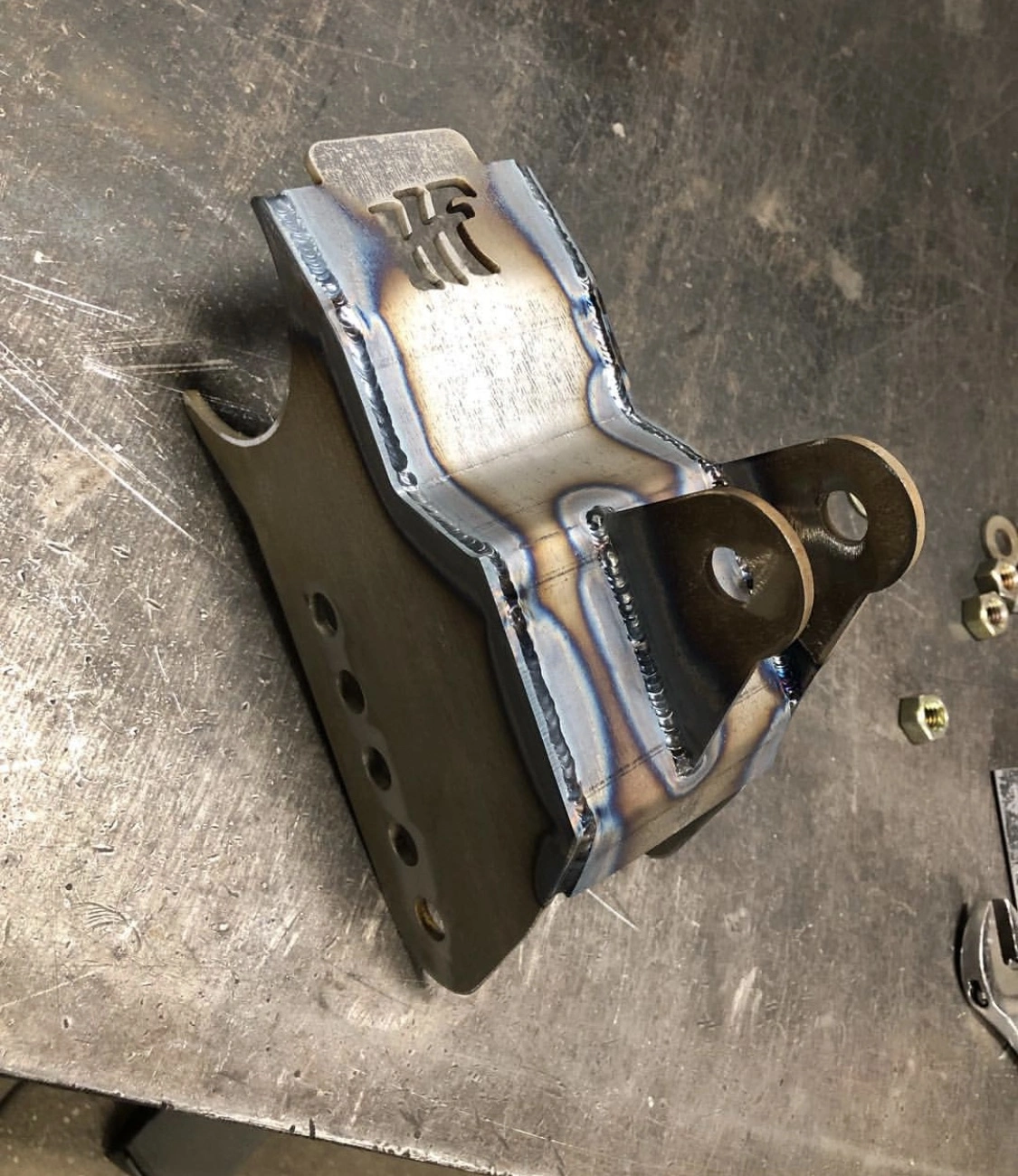

Ok so I have my rear end stripped and rear to start beefing up. I have the strange h1137 9 inch ends. Do I cut the old ends off flush to weld the 9s on? Or do I cut more off like an 1.5inch or what idk. Also when welding on my new LCA bracket, is it best to weld back to factory spot or is it better to. Move it in a little? Thanks for any help
Stock width housing measure end to end . You’re going to want to set the length exactly the same . So ld measure both flanges . The current and the 9 inch . See if there’s a diff . Cut flush mock up and measure and work from there .
