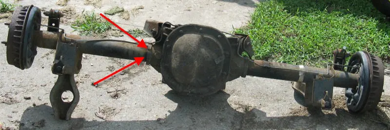

Good Morning,
I had my 86 gt inspected over the weekend and the garage told me that my rear end was leaking from the passenger side where the drive shaft enters the rear gear box. I have a picture of where I am talking about and you can view it at:
http://i303.photobucket.com/albums/nn129/coachpete0474/88-rear-end-2.jpg
They said that the bushing in this area was worn and that the passenger side of the rear end was shifting forward. I personally have never heard of such a thing so i wanted to ask you guys if this is a bunch of Bull#$%^ or something to worry about and if so how to I go about fixing it? Any help is greatly appreciated! Thanks!

Good Morning,
pull the rear and have the axle tubes welded to the housing in a jig..
Wow, they shouldn't leak there. It must be bent. Have a ring and pinion shop out a straight bar throught it, straighten it, then have them weld that sucker. I have had two housings straightened, and they are fine. Don't let anybody tell you that it can't be done.
