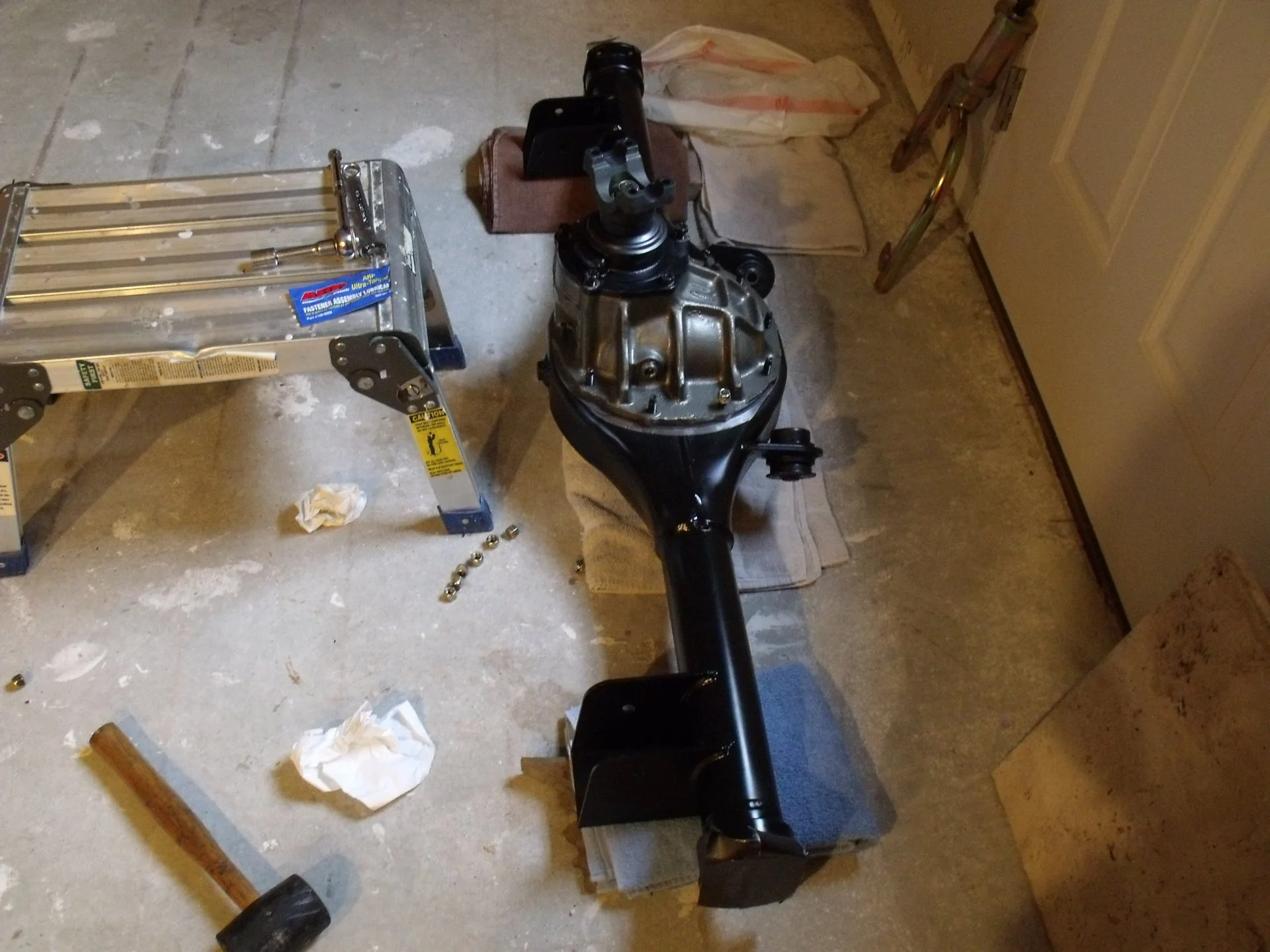

I don’t have a ton of experience with this, but I did just recently rebuild my own rear end. I painstakingly watched videos and read articles during the process, and in the end, it runs awesome. I would bet that all they did was change the gears and throw it back together. I’d say that your clutches are shot and need to be redone.
So the rear end in the mustang is a limited slip. It is a crappy version of one though. There are clutches on both sides that you can replace. But buy a trac lok if you want posi. It's a great way to spend 4-500$.
Rear end gears are something I grown into. The 8.8 is actually easier than say a 9 inch. If you have the capability to torque the crush sleeve it's about 220ftlbs. Then you have to use a dial caliper to measure play in the gears then paint them and spin it for like 10 minutes. It's definitely doable if you have the tools and a afternoon and some ocd helps. Also YouTube will/can walk you threw it in like 8 different languages
That gt should have a trac lok in it. As stated it probably just needs the clutches replaced. You can buy the carbon clutch rebuild kit from ford performance and do it yourself, or find someone who has experience doing them and get a hand.
They’re actually pretty stout If rebuilt with the carbon clutches
