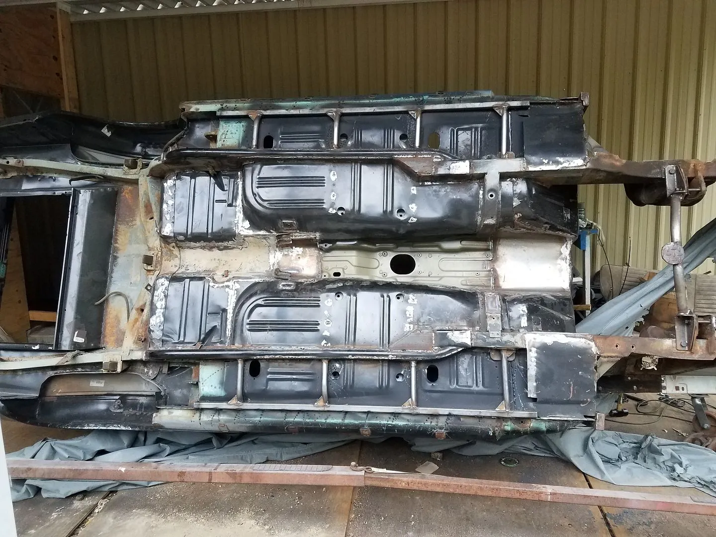

Couldn't find a real good picture of the area you need on mine while it was on the rotisserie, but its really going to depend on how much original metal you have left. If the trunk floor is intact enough, what you can do is simply cut out the old section of rail and drill out the spot welds and simply use the outline of the old rail to locate the new one...of course this only works if the car has not been damaged in an accident and if your repro piece is dead-on. Another method is to get measurements(center of frame rail, not the edge) BEFORE the rail comes out as measured from the other frame rail...use one rail at a time as your reference point. It really is easier if you still have the trunk floor in place.
