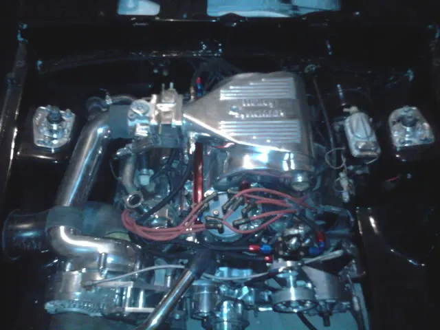

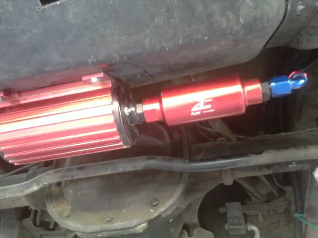

Rear gas tank and front tilt hood pics..
Damn looks good man
Awesome man. big props to being unique.

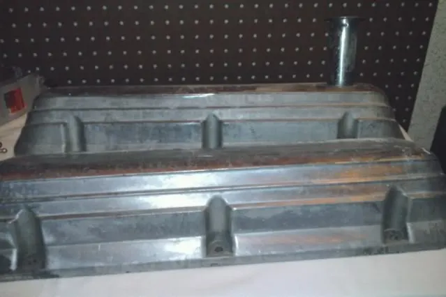

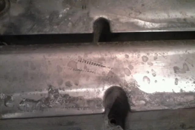

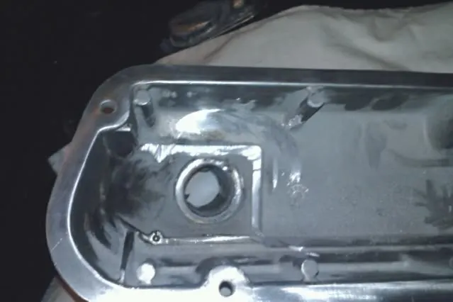

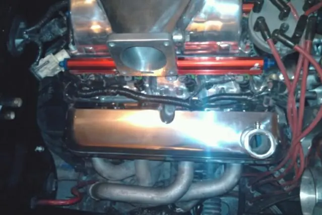

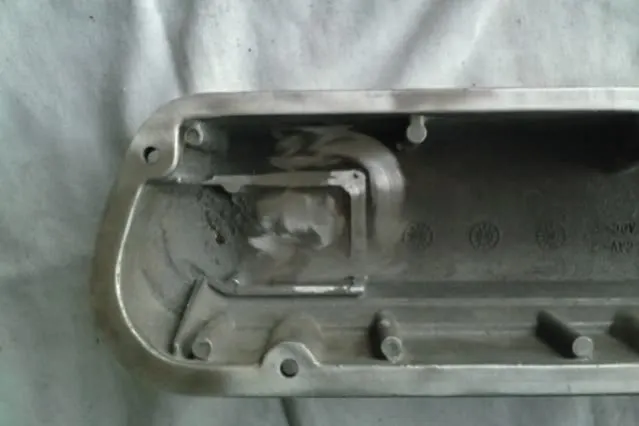

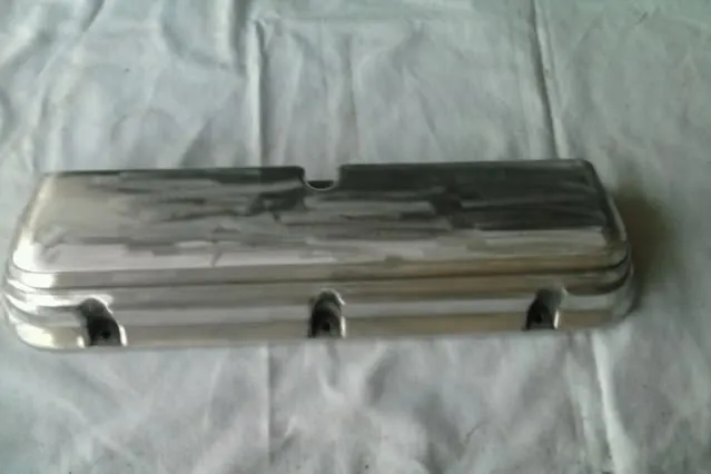

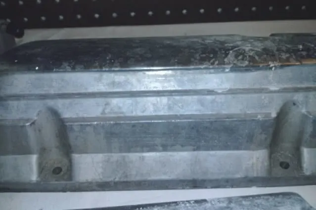

Well guys havent done much to the car.. I took my engine apart to put it back together since i didnt have it on with gaskets...I had it hand tighten so i wouldn't loose anything.. Well i havent bought my new valve covers so i used the stockers. it didnt clear my roller rockers so i had to grind the inside.. I had my covers out with a bunch of tools.. They were in my get rid of pile so i took them out and was going to paint themmbut i desided to clean them up and polish them.... so here they are...oh yeah i finishe most of my wiring i just need to run my new vacuum lines...here are the picts

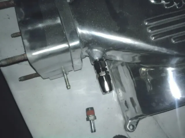

I did all my vaccum line yesterday just need to plug them onto my upper... I have a question for those that know...is this plug a vaccum source?? i would like to run my vacuum stuff through there.....Thanks..

Sorry guys I'm out of town now.Answering with my phone hopefully I can post this...the polishing was done with an angle grinder with a abrassive pad.medium then a fine for cleaning up the cover then used a bench buffer with a tri.poli compound then a white compound for aluminum for final shine well then I did a pass by hand with Mothers...

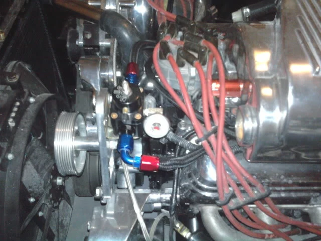

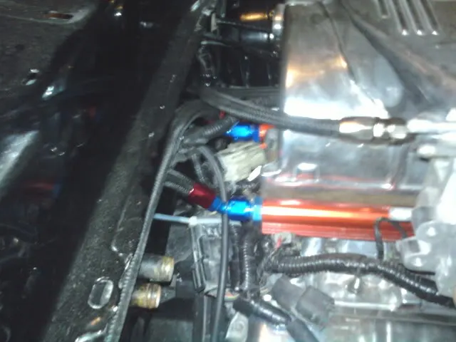

I done with my fuel lines finally ran them installed them.. my vacum lines done except my main ones to booster and pcv.. i need to put my SC to see how to run my last small vacum lines...but got the fittings for my intake..
Im working on getting my steering column on but my wiring harness are old and some are breaking so i need to replace those because some came apart..Cant find them online or LMR...maybe someone can direct me to them...done with electric fan. lineloc.fuel system...well here are some pics
