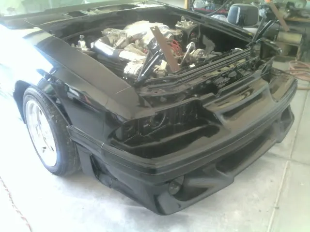

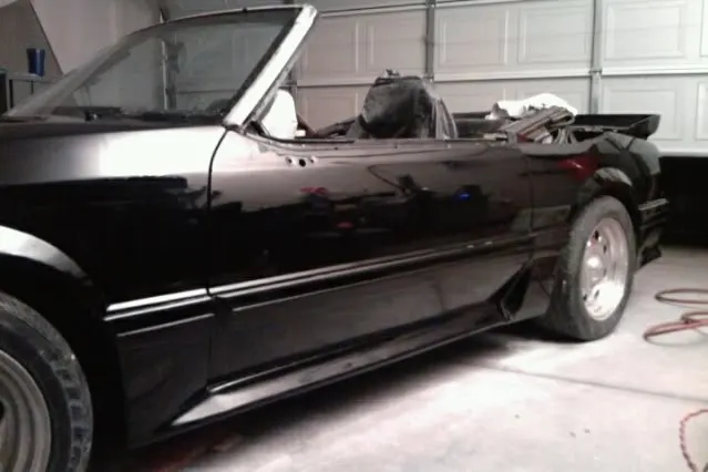

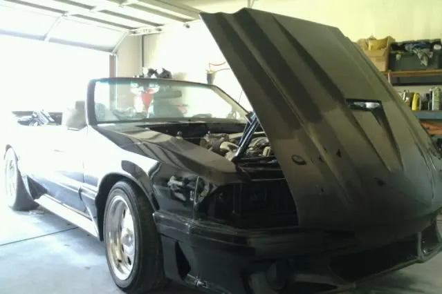

Rear gas tank and front tilt hood pics..

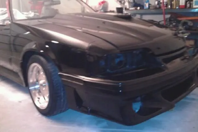

Hey heres some updates not completely done still need the back and the lower part of the ground kit had some polishing done to see how it would look...

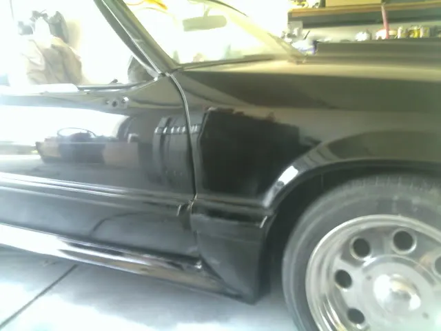

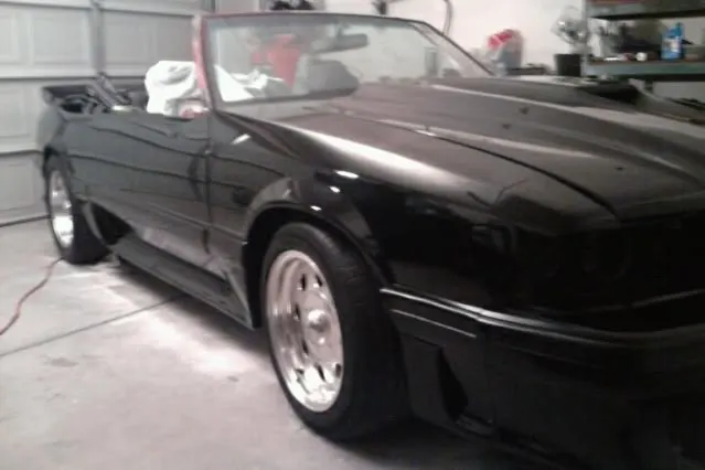

.WITH A LOT OF ORANGE PEEL..
AFTER WETSAND AND ONE PASS WITH THE POLISHING AND PAD...look decent...

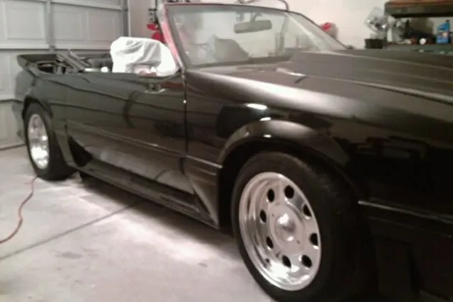

I'm Almost done with the sanding I need my wing to wet sand...:banana:.. I had polished the right side of the car but i left out a few little specs on the clear where i didn't sand and man you can tell big time... so i went back and did those small spec i just need to go over it again. I had done a light pass with the buffer and looks good but need to go over it one more time.Better move slower and make sure i do it right than speed up.. Its my first time so dont want to fudge up.... Then move on to the next step of the polishing.....

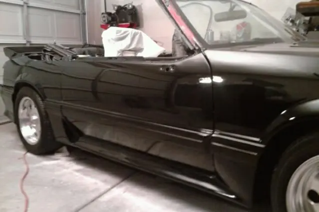

Heres an update.. Used the cutting compound on the whole car heres some picture...Sorry about pictures took them with my phone...Next its a swirl remover or polisher not sure which one ...i will check tomorrow

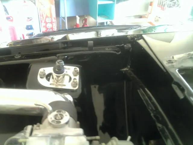

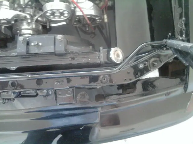

here are some pictures of the hinges and the bar to see how it clears the radiator. dont think i had a picture of that...

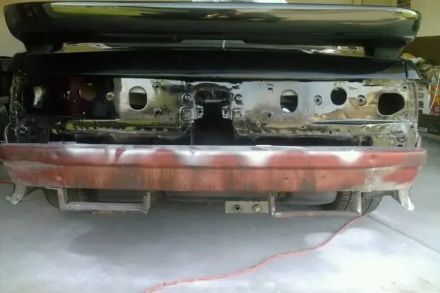

I was outside put my back bumper on permanetely now.had it loose when i painted because wanted to get a little under the original position and i knew i had to get in there when i did my cleaning of the treads.. well i also put my trunk brackets or springs whatever its called. The paint stuff is like 90% done need to wax andneed to do two small touch ups. my cowl vent cover and my tail lights.. I want to overhaul my tail light started sanding them so i can paint the black trim around the red.... then polish them with my headlight polishing kit..see how it turns out...Need to look for my vacum diagram what i actually need and domnt need.....well ive had a long day have to stop in the garage...Have bartending training tomorrow...
