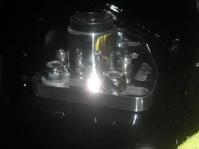

Rear gas tank and front tilt hood pics..

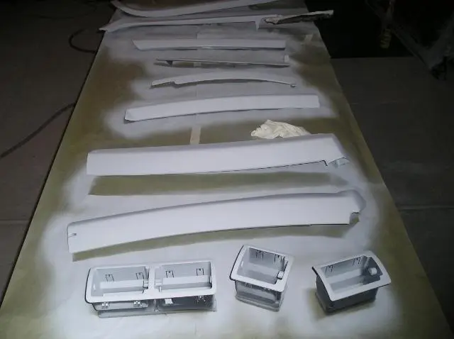

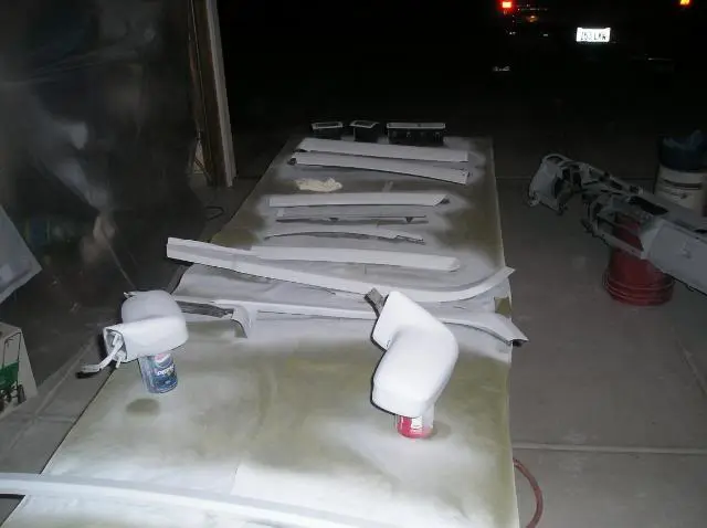

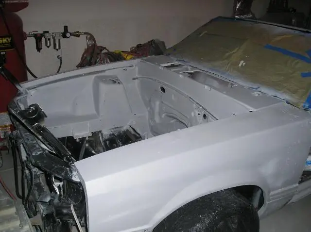

Heres an update on my mustang. I been working on my stang for a very long time by myself, I've done everything on my own, This weekend I was working on the stang getting it ready to paint, A friend shows up he offered to help , And i was relly happy, I had him sand my hood and doors for a final sanding(second coat of primer), I steped out for a few minutes when I come back he said he was done,,,:eek:.... Yeah that was about the look I had he had sanded my stuff with 100 grit.....I was :mad:and wanted to :cry: and definetly wanted to beat the:chair: out of him......but i don't blame him I guess. He actually volunteer, something ive haven't been offered for a long while..So i did what a good friend would do.... I had him go to the store get some CORONAS and had showed him how to primer and sand my hood all over again.. it turn out ok.but anyways sorry about my long sad story here are some pictures of some parts and fenders that i had him primer also ........
PS last time someone will help me again...LOL
I worked A lot on that hood thats why I was mad and sad at the same time that hood had to be modified to clear my rear hook were it latched on to the back and also it had an unfinished liner inside so I smooth it out...

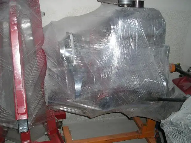

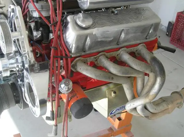

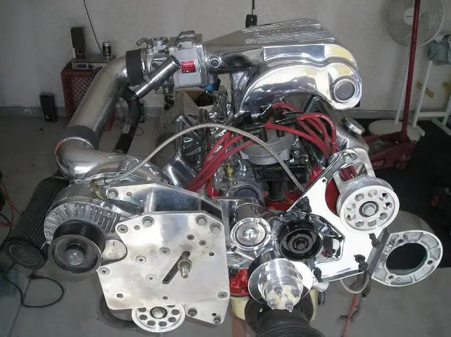

Heres my engine waiting patiently in the corner of my garage. Waiting to get unwraped.....:D

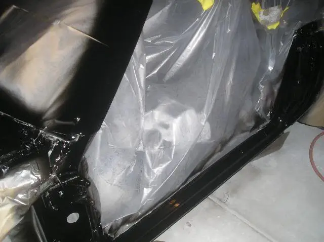

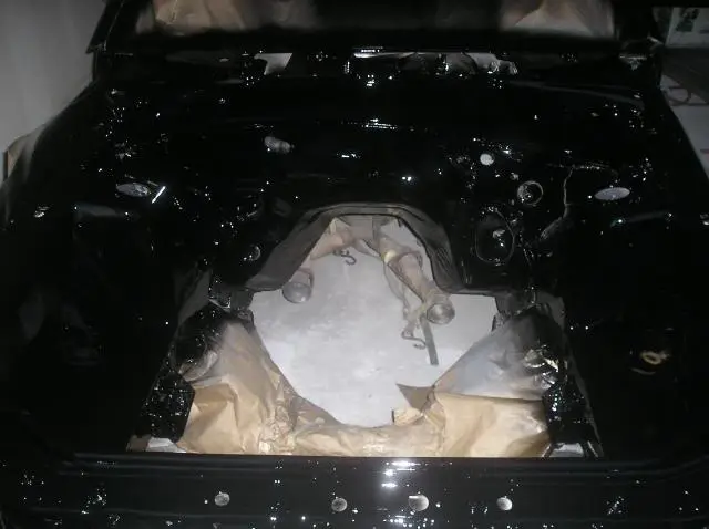

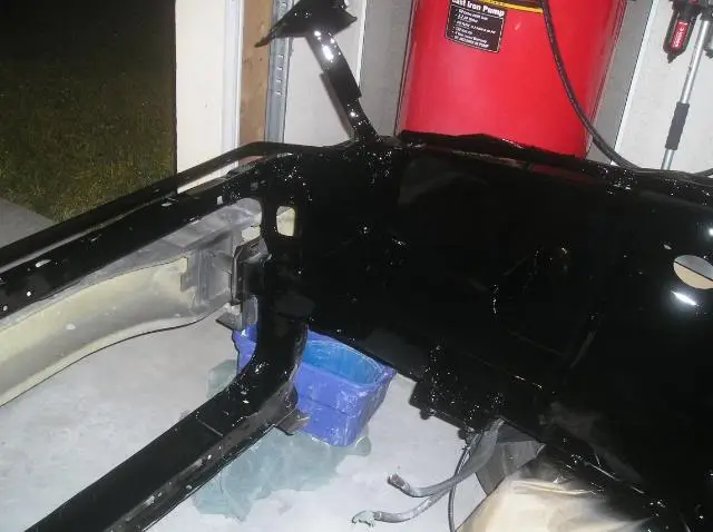

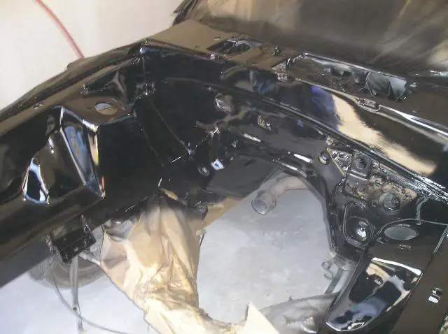

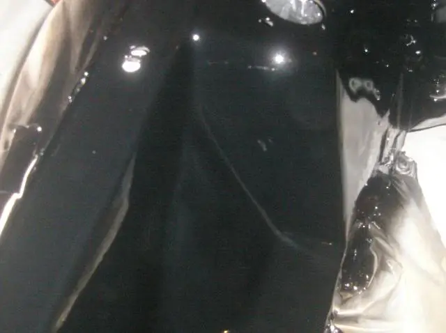

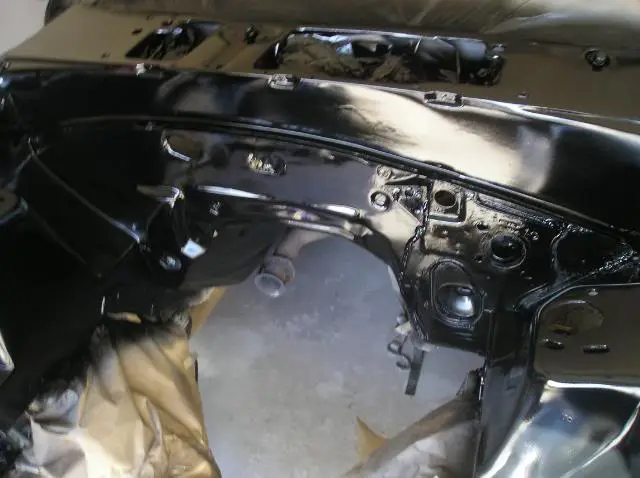

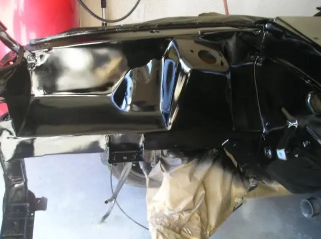

Here are some pictures of my mustang, I started Painting my jams, my hood,engine bay, trunk area, trunk, mirrors and other little things.....I had some extra pipes and build a rack to paint my stuff.. here are some pictures it came out good. some pictures look like I was looking in the mirror or like its chrome..sorry its a lot of pictures.............
This picture is the first coat of basecoat no clear......

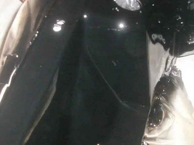

Heres the inside of my hood it looks like a mirror after some clear coats
Heres a night shot of my bay, will get some more tomorrow
I just have to put my car together, wire my engine bay and paint the outside of the car..I'll post some more pictures later..Let me know what you think!!!!!!

Looks good...:nice: Good old 99k thats a base for alot of colors..used it plenty of times when i used to mix paint for body shops at my old job...Keep up the good work cant wait to see the finished pictures....
looks real good man...cant wait to see how it looks
Yeah I can't wait also, I went to sleep at 5 in the morning last night masking and putting up plastic in my garage then woke up at 9:30 to finish up the taping then, when I painted, i went to my mothers to eat, then could wait to get home to unwrap it..I almost wet myself.......LOL..

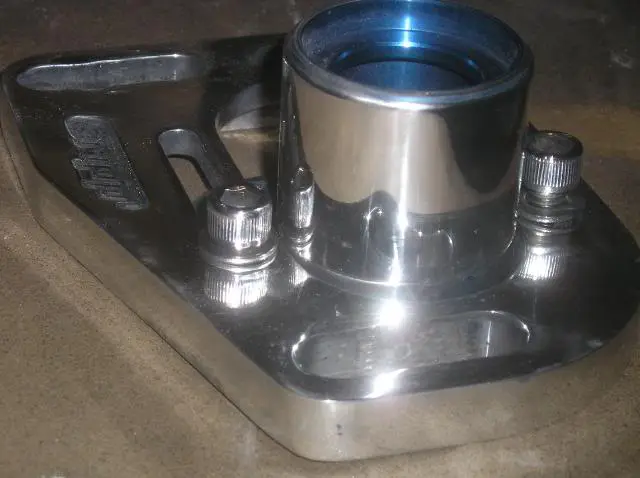

I was cleaning up my garage after the paint job, so I found these I forgot I had bought them for cheap on Ebay,but anyways I didn't like the blue on it so I polished it.I was thinking of painting it black but Changed my mind. Here are some before and after pictures of how it looked. I put the blue one on the car just to take a pic to see how it would look.Sorry pictures aren't that great..

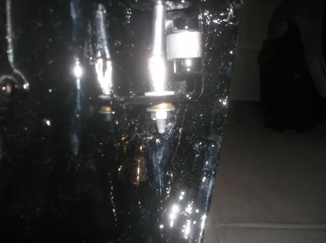

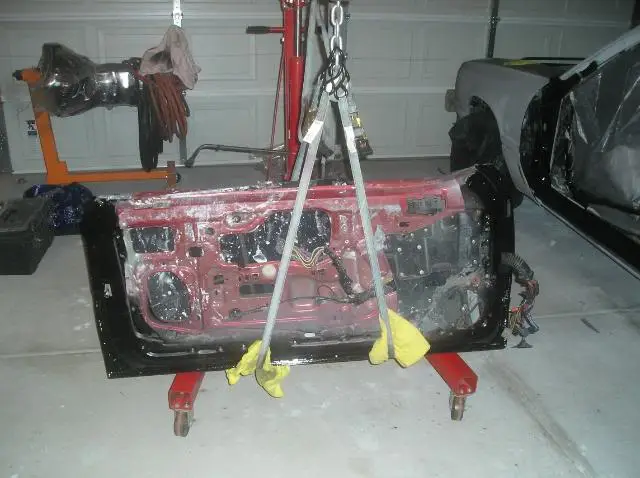

Door hinge and bushing install...
I installed one of my doors in today.. I waited all day for some help(friends and brother), but like always they weren't around. So I used my only friend I have my Engine hoist.I've done most of my car by myself (like 95% of it)no friends, no brother, no shops,The only thing I'll need from a shop will be my aligment and mytune when i get it going other than that, I've manage to work by myself without any help,Anyways I was just venting a little,,,,LOL. Like I was saying I started my door and bushing install, I took my engine hoist and two of my tie down straps to balance it,

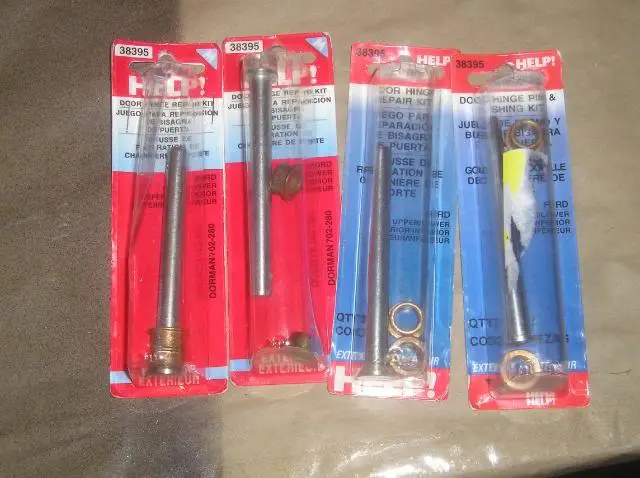

When I had it up I realized that i forgot to put my bushings so I did it on the hoist,(I was to exited that i was going to put my doors up)..LOL....I bought my pins at Pepboys and had to get the others at auto zone, They usually carry one or two of them per store.:shrug:Paid no more than 23dollars for all four, The only thing is that It didn't come with the pins I had some at home so Didn't need them. I did look for them just in case someone needed to know the price or I couldn't find mine there 2.99 a pack assorted...

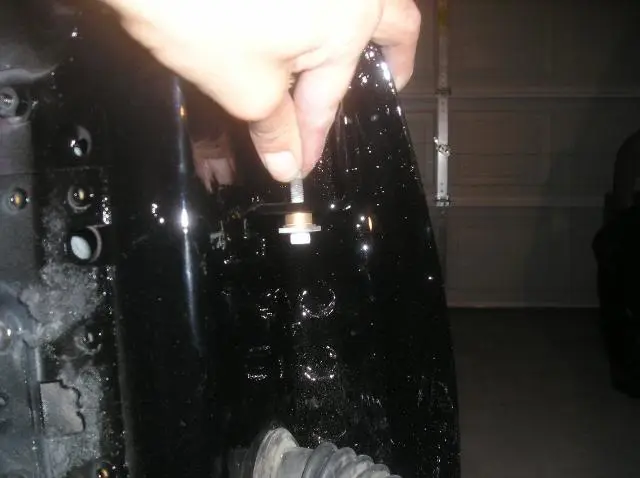

I had a little trouble doing the bottom ones so I though of a way to to it so you wont have to tap it in and maybe damage new paint job.. I got a screw,two washers and a nut to press it in. It was easy just line it up and tighten until it hits.I have some pictures of it......
Then to the install of the door I lined up the door to the car closest possible to the car then I final adjusted the door with the strap, one click at a time,I had to click like about tree time in the rear and once in the front. I was perfect. Took me longer to put the damn door on the hoist...:D
I was just experimenting with it and it worked:nice:..
Then I tried to rock my door up and down,,,,NO play at all,,,Perfect..........Another thumbs up!!!!!!!!:nice:
So theres no need to have more than one person to do the job.....LOL..But it would help....
