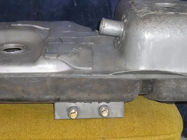

Well I started out by taking out my tank, I cleaned it out and wash it with cleaner to take the fumes out. I left it out for about a week with the degreaser n soap in my back yard.,(NOT BY CHOICE).I let it air dry after to see If I smell fumes. The i marked my sump then cut, and welded my sump in. I welded my inlet hole for my tank shut. then on the opposite side i made a 2-3 inch hole to put an inlet pipe that I got from another car. Im not sure exactly what car i took it of from ,I was just walking around the junk yard and found the inlet I have on a tank then i screwd it off. But i think its from a hundai or a small car like a toyota. But any will do as long as its not to long inside so it won't interfear with the stock pump (if you want to retain your stock pump.)I didn't screw mine on I welded it to my tank.i Checked for leaks and i had a few pin holes but i welded them shut,but just to make sure i used KBS coatings inside and out just incase I misssed a pinhole:D. looked like this....

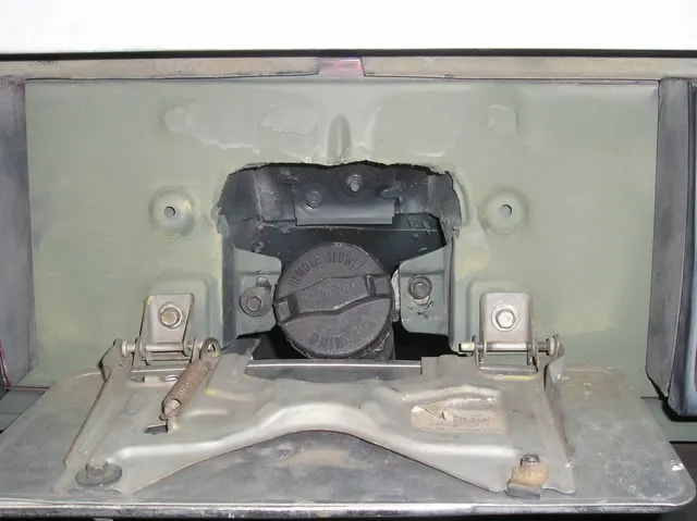

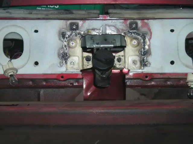

On the car itself I welded the door shut and welded the hole were the inlet goes though inside the trunk.In the back i cut out a piece from a caprece. I cut about two inches around wer3 the hole is and welded that to the car.....like so

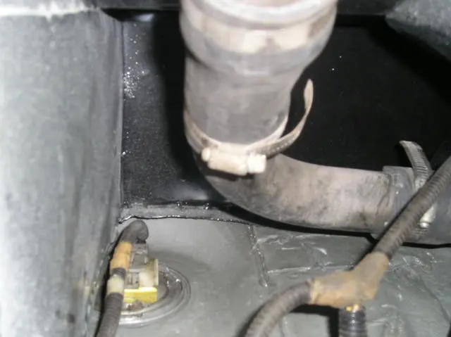

Then i put the gas tank up to check to see how much of the wheelwell would I need to cut. I cut about2 inched on each side of the tube. Then I connected the inlet from the tank and the inlet from the plates with a 90 degree pipe used two small pieces of rubber hose and clamps.. like this

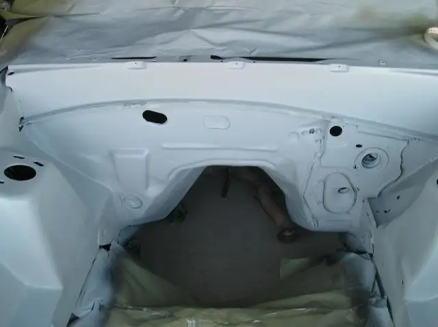

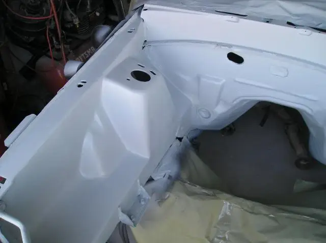

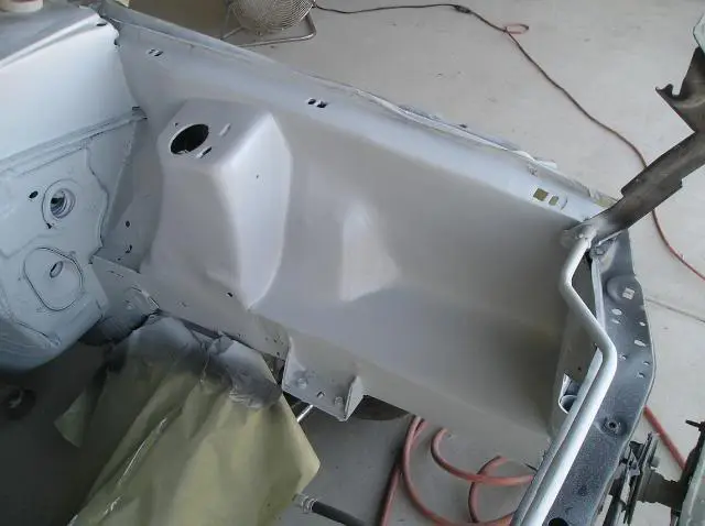

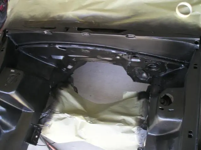

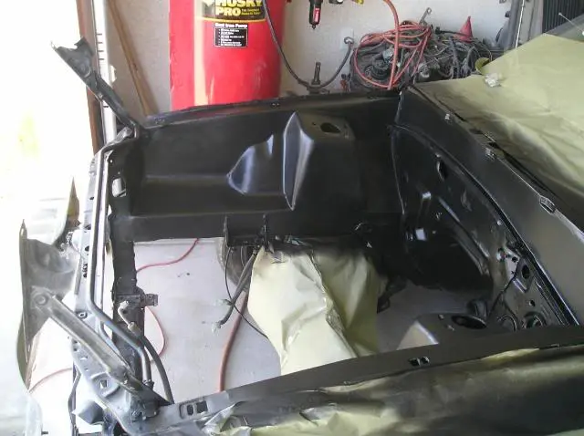

Heres an update on my front tilt hood/engine bay. I put sealer then put some filler primer just have to sand it down to make it smooth, Might need to put another coat of primer we'll see after.YOu can see my hinges a little better in these pictures than in the older ones.
Well heres my car with the sealer....
now here are some with filler primer
Let me know how it looks.. Thank will post some other pictures when engine bay is done.:D
