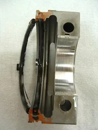

I got the job done. Not too big a deal. The hardest part was getting the old cork gasket and silicone off the bottom of the block.
Anyway, here's what the seal looked like when I took it out...
Perhaps I didn't put enough oil on it or something when I installed it because the lip is all frayed and coming off.
