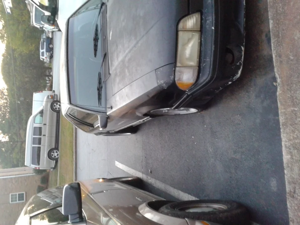

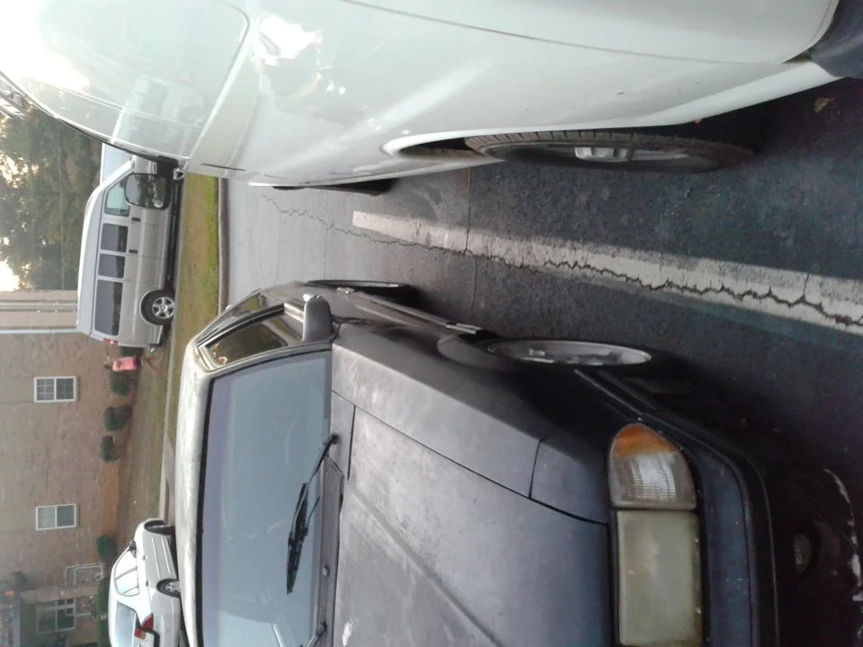

The rear right wheels sticks out about half an inch more than the rear left. The car does not dog track on the freeway. The previous owner used the car for racing on the weekedns, dont know if that causes any issues like that?
Does anyone know how to fix that? do I get aftermarket control arms?

I cant see it in the pictures. You might want to check your rear bushings. Are they stock or aftermarket? Take a flash light and shine it inbetween the body and lower arm. There should be a metal sleave next to the bolt. Is it worn on the ends? A lot of hard launches might wear your mounts. That I can think of
