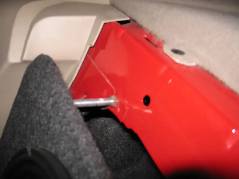

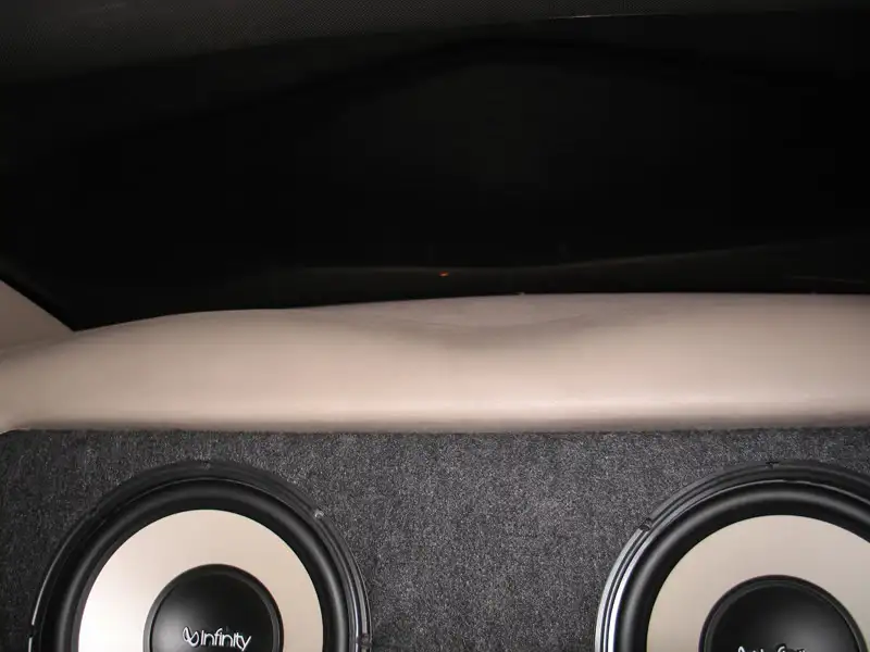

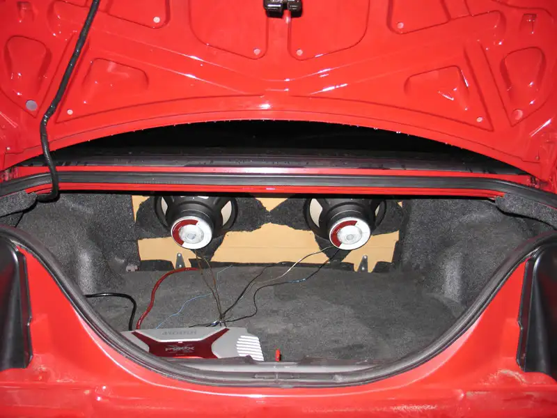

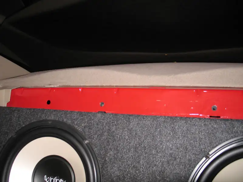

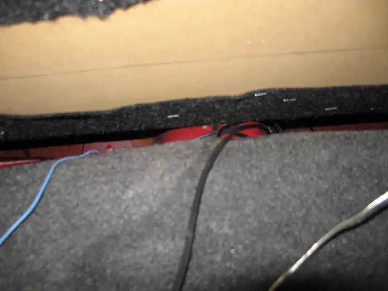

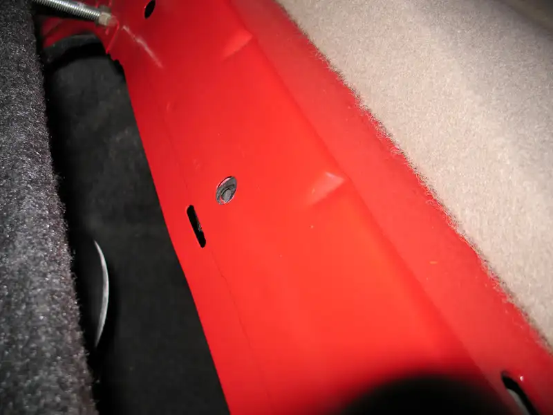

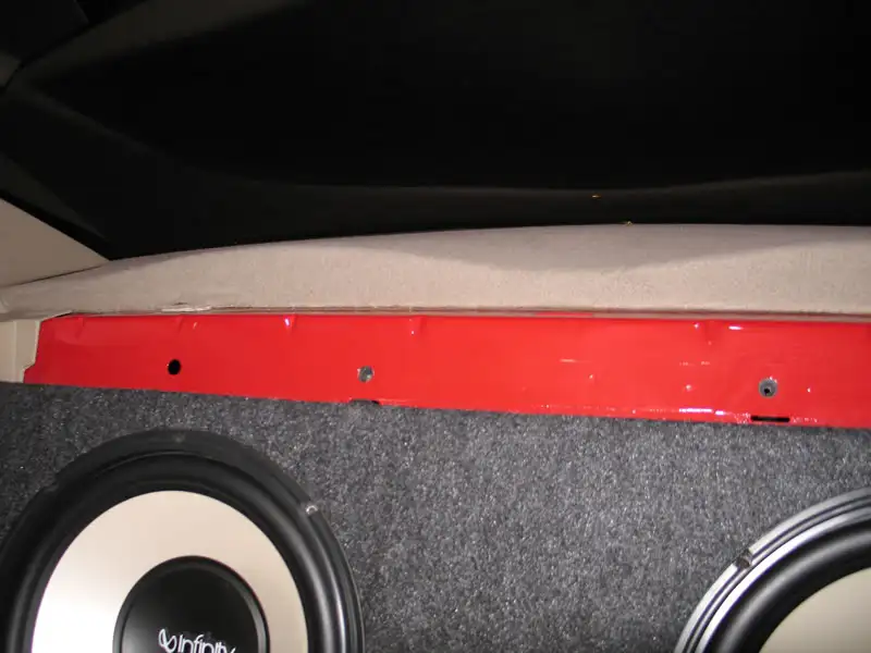

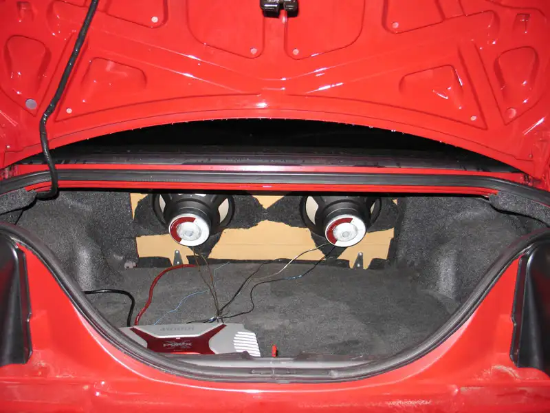

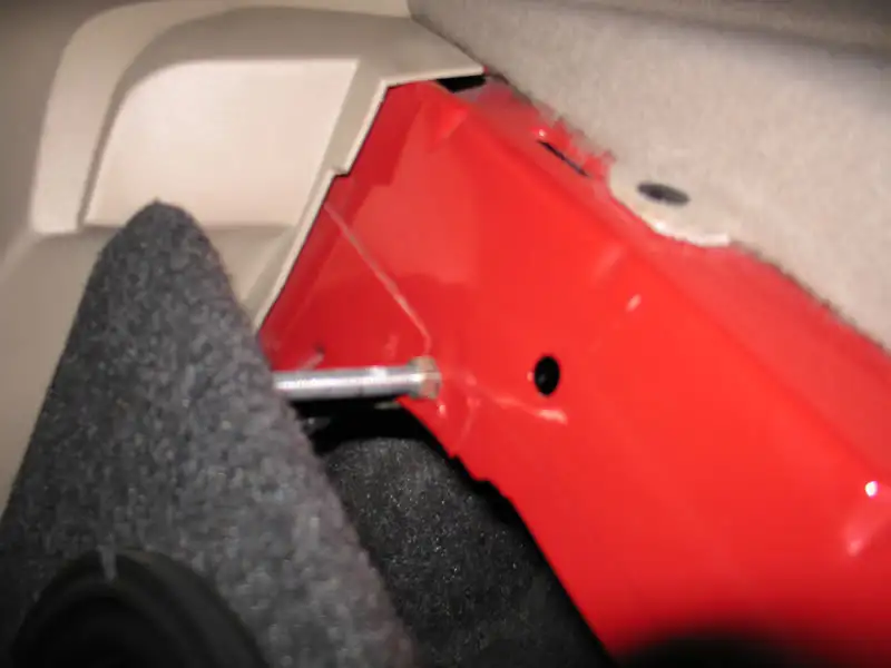

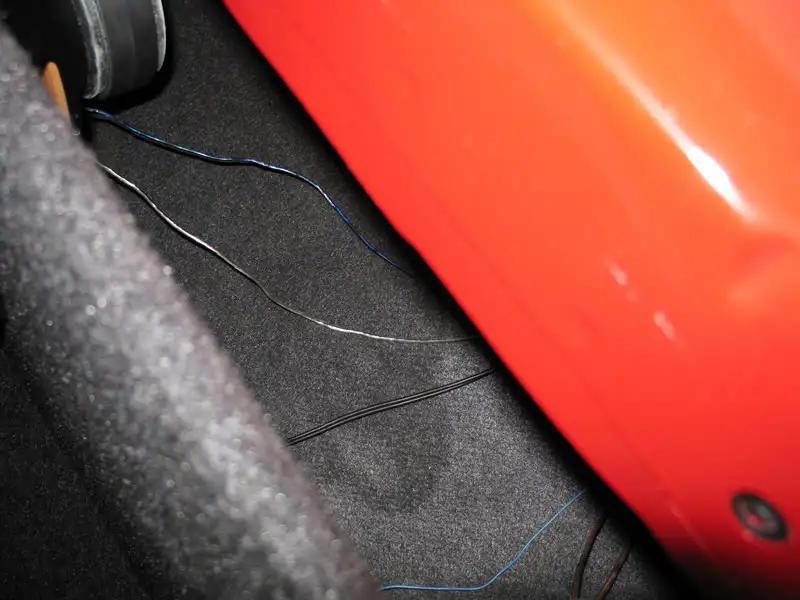

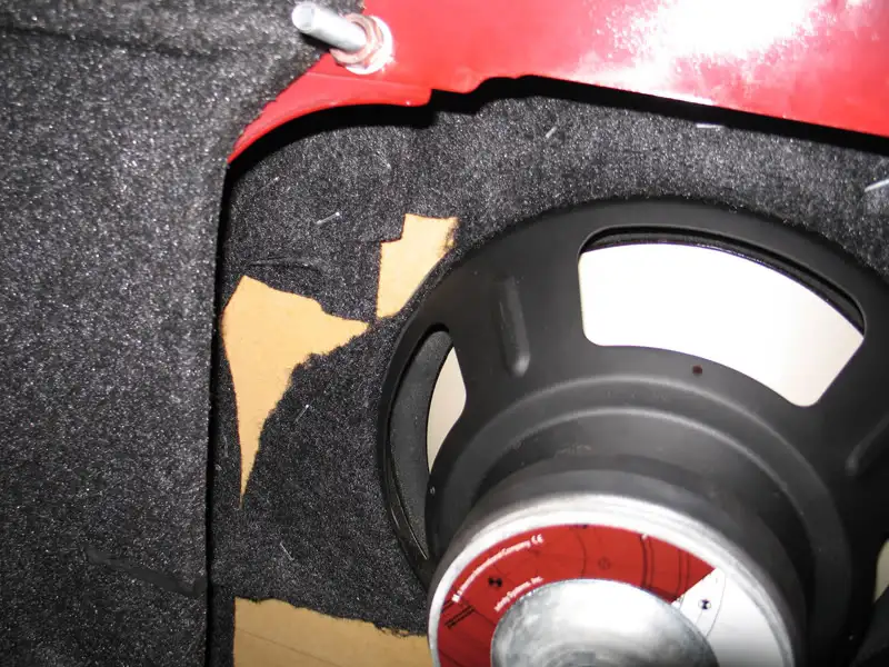

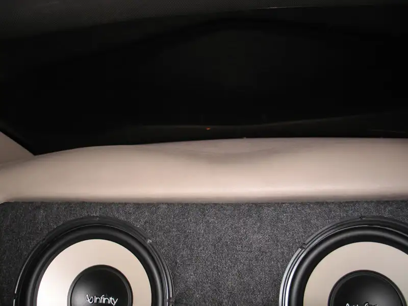

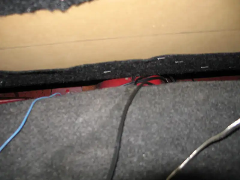

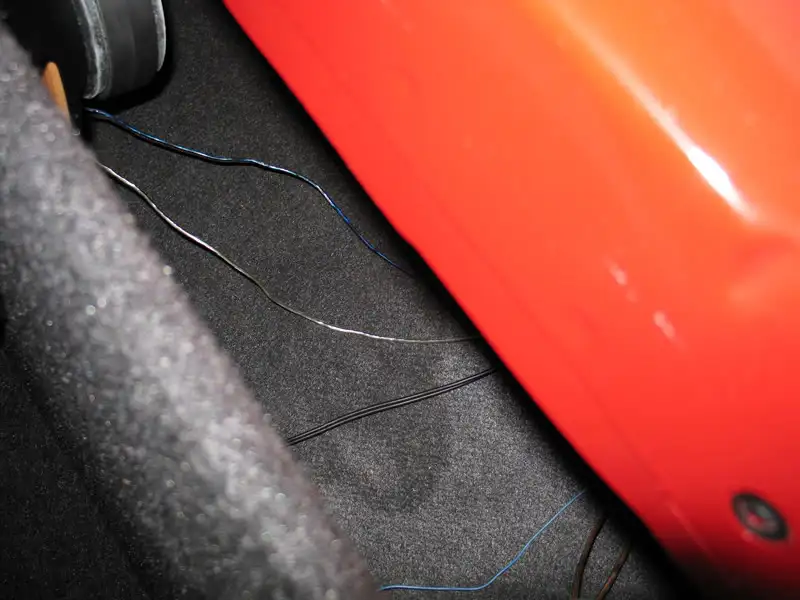

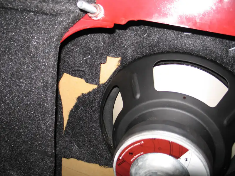

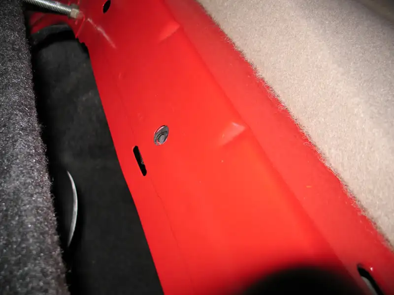

Since a couple of you have been wanting more pictures of my RSD (via PM) and i now have the car out of storage i took a few quick pictures that hopefully will help out. again if any more are required, just ask :)
Self explainatory:
This one is looking down underneath the seat:
A shot of how it is mounted (same on other side):
Looking down into trunk from inside the car:
Another shot of how it is mounted (again same on other side):
Another shot looking into trunk:
Self explainatory:
Self Explainatory:
!!!!NOTE!!!!
I KNOW my trunk is a mess, but like a lot of you know, i will be building the back to it this summer. This is for all of you who dont know my situation.

No you didnt loose any weight, the mdf weighs more - at least in the vert. And putting to subs on a board is going to sound like crap, you need to build boxes into the rear panel. For the delete you did well and it looks good, however for the subs - people dont need to copy that, its simply not done properly
thank you for the one compliment, but:
1) i wasnt looking for weight reduction (that wasnt my primary goal)
2) i have not finished the back which would make it enclosed (did you read?)
3) it does not sound like crap. itll sound better with a back yes i agree. but it does NOT sound like crap
look man, im not trying to insult you here, but those are not free air subs... so you can A) damage them and B) they do not sound good (but used to build boxes for a living so maybe my ears are a little different than most peoples. I didnt see where you were going to back them, in that case get 'er done with a min of 1 cu foot and it will sound great, but make sure you secure the back board to not rattle, also you can go lowes and get cable and a lock, bolt the back board too the floor and the subs to the inside of the their boxes, (make sure also you build 2 separate boxes, not 1 big one, bc the phasing will make them reverberate. Looks like you could also externally mount the amp, however if it were my car Id mount it on the inside of the rear back baord and cover it. good luck
i am fully aware that non free-air subs can be damaged when not enclosed, thats why i dont have the amp cranked all the way up. i know its dangerous but i dont care. the subs came with the car
the whole thing that will need to be done is me remaking the RSD, which i already planned for while making it the first time
i am going to use most of the same procedures but with more of a sealed box concept idea in mind
some of the things i will be making sure of is to incorporate 1.25cu ft of air into each sub (recommended by infinity). 2 cu ft for porting, which i may do
the back will be formed to the trunk and things will be insulated
i wont get any net weight savings by the end but that isnt my primary goal

Digging this back up.. RedDaemon how did you mount the bottom of the delete to the car? I know exactly where to attach the upper section but I haven't seen a great area to mount it to there. I am also really thinking about ripping out the trunk trim pieces and just put carpet on it.
