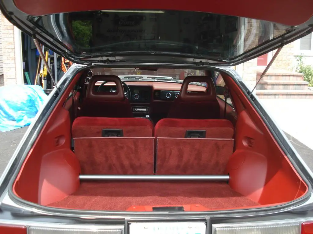

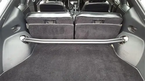

Any kits out there that do not require trimming the rear plastics?
Trying to avoid cutting them like this

Awesome. Looks like that's what I want. How does it install? Existing holes or do I need to drill?
Yeah you'll need to drill. It comes with two brackets that you bolt to the wheel well (one on each side). Pretty simple.. Then you bolt the brace to them. As for the question to whether these do anything or not?
I Da Know? I did it because I thought it looked good in my car. LOL

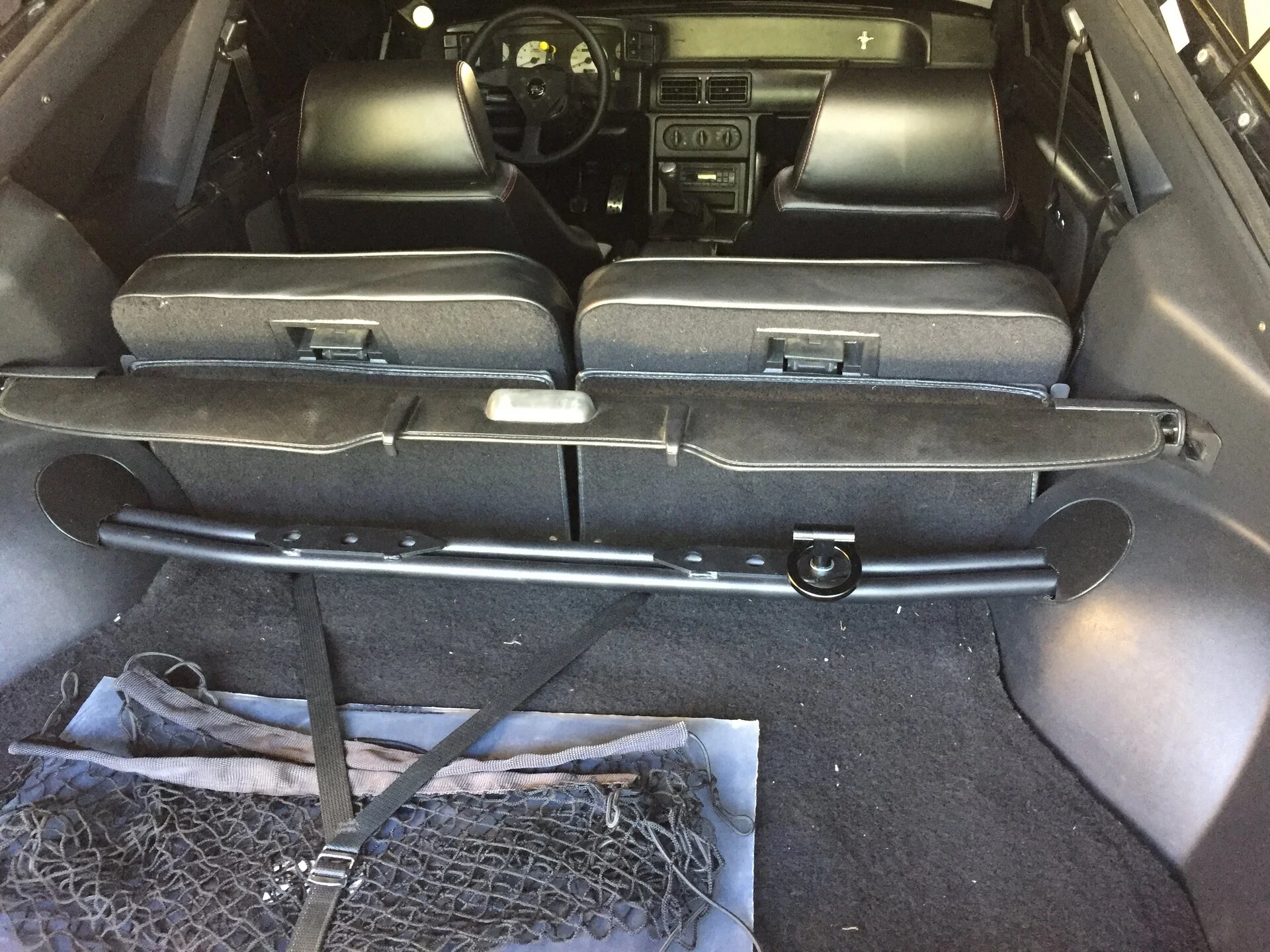

I ended up installing one as pictured above, BUT, I did it as a point to mount a tether for a child seat. It allowed me to loop the tether over the seat back and hook to a loop I installed on the bar. I used it a handful of times to take the kiddo's for a ride.
Now that the kids are old enough to not need that, I plan on taking it back out. it doesn't mount to the shock bolts, but bolts to the sheet metal instead. I'll have to remove it, and weld up the holes and refinish.
I noticed ZERO difference in rigidity, or handling from the rear bar. All it does it get in the way of thinks when I load the hatch (like my sunroof, or small grocery run)
