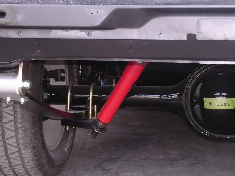

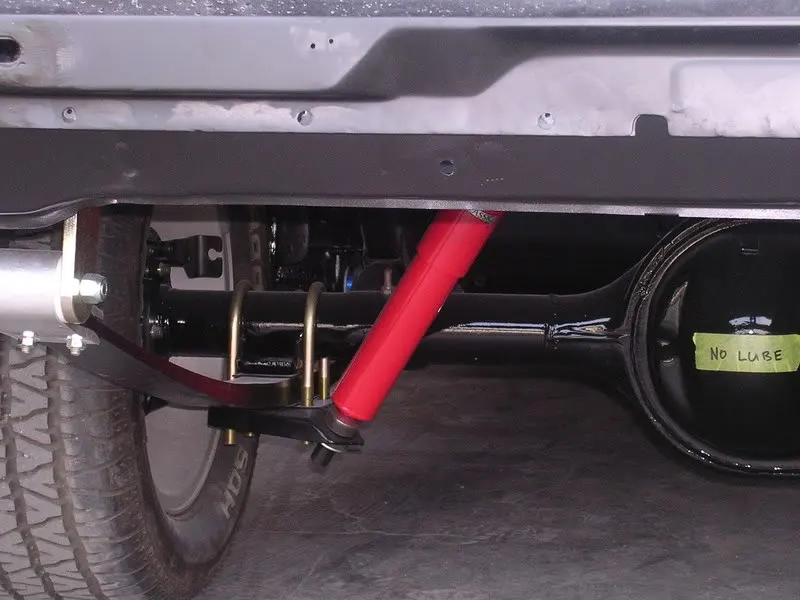

for what you want i would go with flex a form fiberglass leaf springs with koni shocks instead. the konis are adjustable in the car, and the fiberglass springs dont wrap up, and you wont need the heavier rate spring as you would with steel springs since you dont have to control as much weight, thus you will get the handling you want, and a better ride as well. i would also run a 3/4" rear antiroll bar to help control body roll.

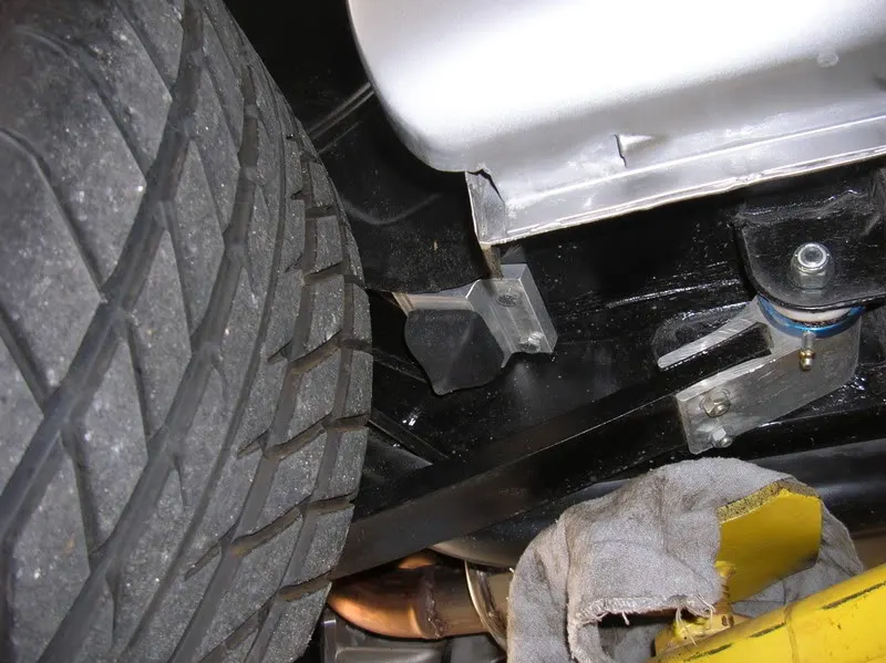

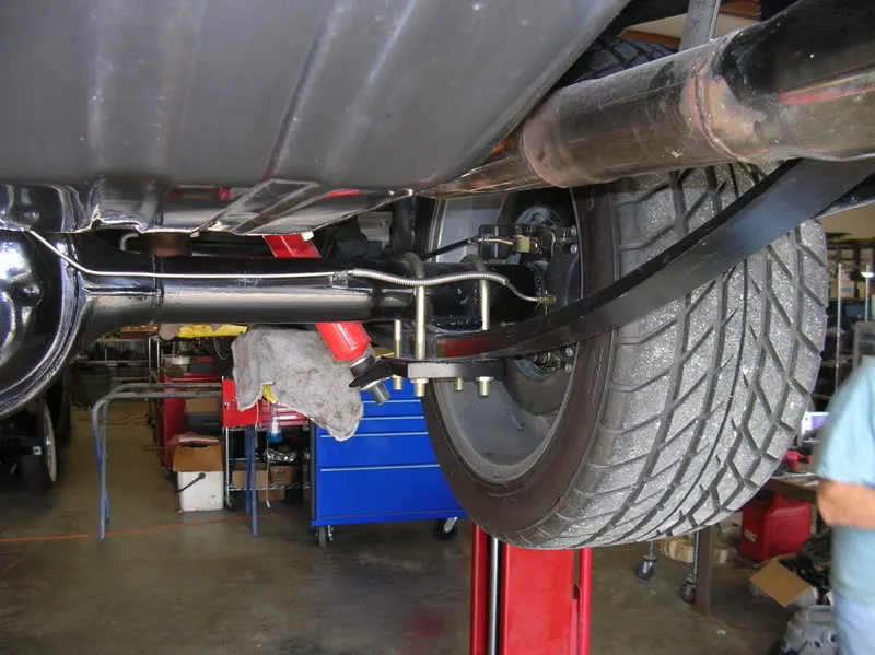

I have Flex-a-form springs and I am very happy with them. Smooth ride and zero wheel hop (and I am running an FE stroker).
I am using Global West Del-alum bushings that control body roll so I didn't need a sway bar but a side benefit is wheel hop control.
The mono-leaf design of the fiberglass springs resists wheel hop but if you look at the Cal-Tracs and Slide-a-Links, they all use a solid front spring eye bushing. Eliminating vertical movement at the front spring mount helps control wheel hop.
