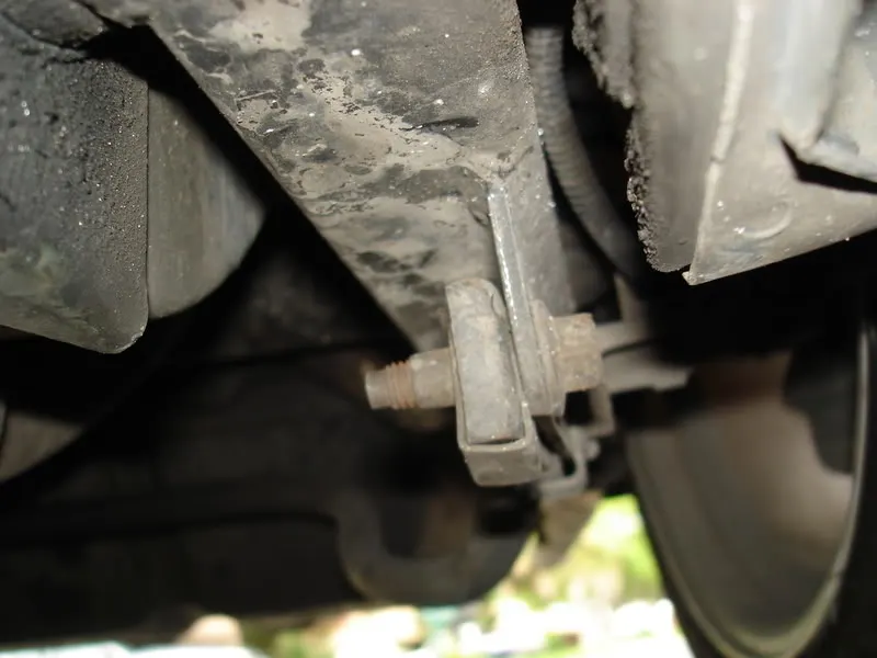

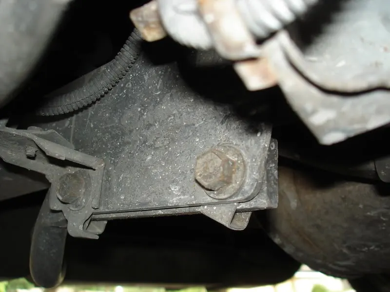

I had the same problem with my Mega-Byte Jr's. Put the sway bar on the OUTSIDE of the mounting plate instead - reverse the clip-on nuts so the bolts now go on from the INSIDE. The sway bar should match up perfectly then. I can take a photo of my setup if you need it.

I would REALLY APPRECIATE the photos if you can get them. I have a 5-day work stretch now, so I wont get to them until WED, but if I have a couple of photos for reference that should help. :hail2:

The tab on the control arms should be towards the wheel.:nice:

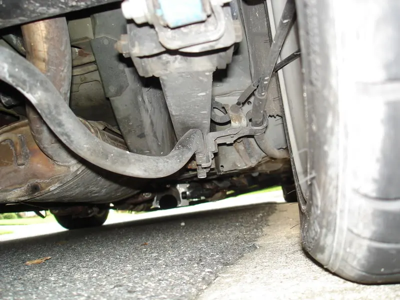

My swaybar Is bolted to the inside,
hope that helps.
Do you have the aluminum control arms or the heavy duty(steel) control arms?
It may be that some sway bars are wider then others. I remember putting the swaybar on the outside but It wouldn't fit So it went on the inside.:nice:
I got them with the car, but the bushings are black, so Im almost postive they are the steel ones. The steel ones have the sway bar mounting tabs in the middle. Yours are off to the side(by the looks of your pictures), which would make the arms "side specific" if you mount them on the wrong side, the tabs would be a closer/farther apart.
