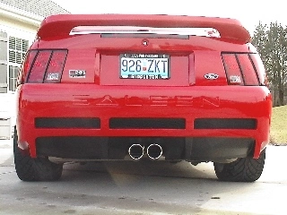

Just took some pics today with my new 315s... :D
I have two sets of wheels with two different manufacturers of tires.
Both have 18X10's with 295's, my black wheels have Bridgestone Potenza S02's and my Chrome Saleen wheels have the factory equipped Pirelli P-Zero's.
I just changed my wheels out to the chrome for the first time to see how they would look and I compared the tire width while I had both wheels off.
The S02's are considerably wider and I don't like the look of the pirelli's on the car at all, they look so skinny in the back compared to the S02's. Not too mention the black wheels totally make the car....
my 2 cents
