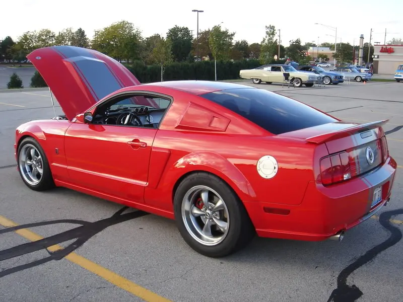

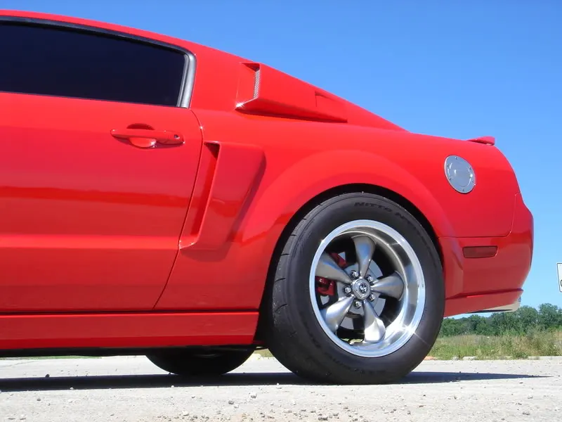

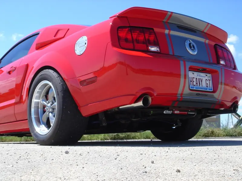

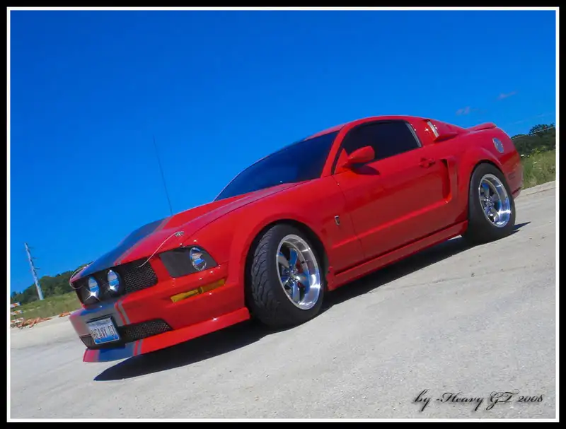

I wouldn't get those...spend a little more and get the Shelby American Racing Antrachite Bullitts from www.Tirerack.com ...my rear tires in the pics are nitto 555dr 305/45/18 on SARs 18 X 10 riding on Eibach Pro Kit.
I wouldn't get those...spend a little more and get the Shelby American Racing Antrachite Bullitts from Tire Rack - Your performance experts for tires and wheels ...my rear tires in the pics are nitto 555dr 305/45/18 on SARs 18 X 10 riding on Eibach Pro Kit.
I love the way that size tire fills the wheel well!!! I've been eyeing those tires for a while. Doing a few good burn outs a day trying to wear done these Toyos so I have an excuse to get them.
