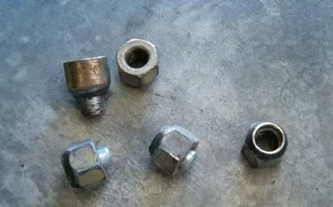

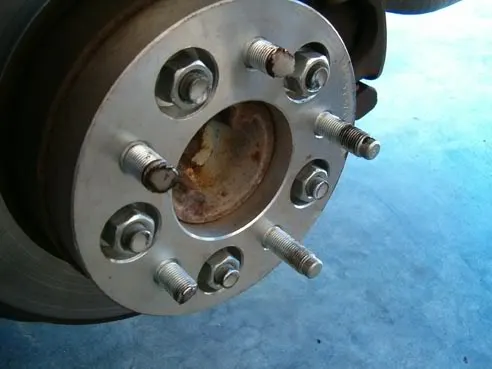

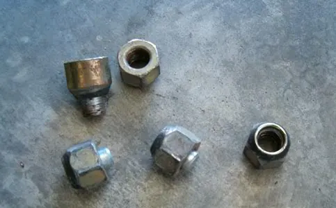

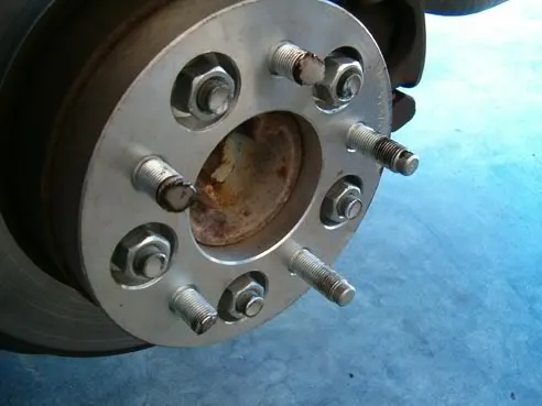

Good news and bad news.. good news, it wasn't anything major and the car's drivable again..
Bad news..
Trailsport is about to get reamed. :bs:
thanks guys for the nice remarks and EpiKk3 i'm glad you found your problem before the other two bolts broke. and thats scarry i have the same spacers yours look like 1 inch i have 1.25 inch i have the hub to spacer bolts torqued at 130 ft. lbs... with lock tight to ensure they wont work loose and the spacer to wheel lugs tightened to factory spec 85-105 ft. lbs. give us more info. how long were spacers installed were they torqued and any other info. that might help us in preventing this from happening to us? thanks again fellows......
