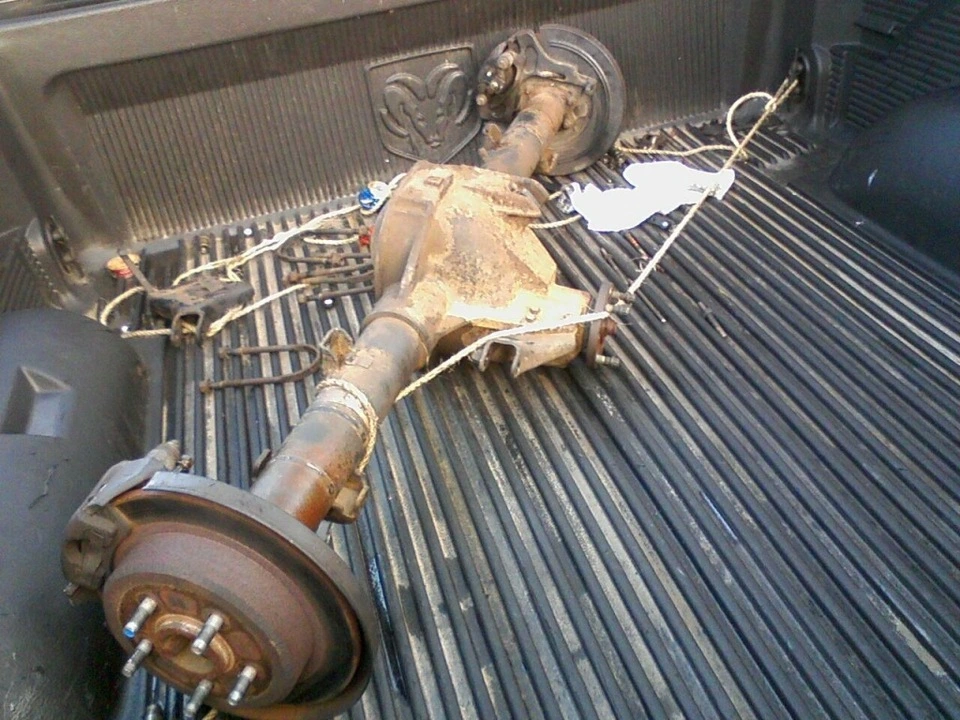

here is my 96 explorer rear...trak lok, 373 gears...for my 66
haven't put it in yet

Cool. I think that would definitely be the easist swap. Unless the Explorer pumpkin isn't actually offset. I can't tell from the picture. If it is not offset and does not require shortening then that would be the best swap because of the gearing and the disk brakes.

the explorer rear is indeed offset, but I haven't heard of it causing issues for anyone, other than the ds hitting the tunnel on big bumps...which is fixed by clearancing the tunnel.
