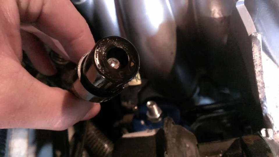

I pulled the valve and grommet out, the grommet came out very easily. There was some sort of baffle covering half of the hole under the pcv screen, but I could stick my finger around it and through. Oil was definitely being sucked through the pcv valve.

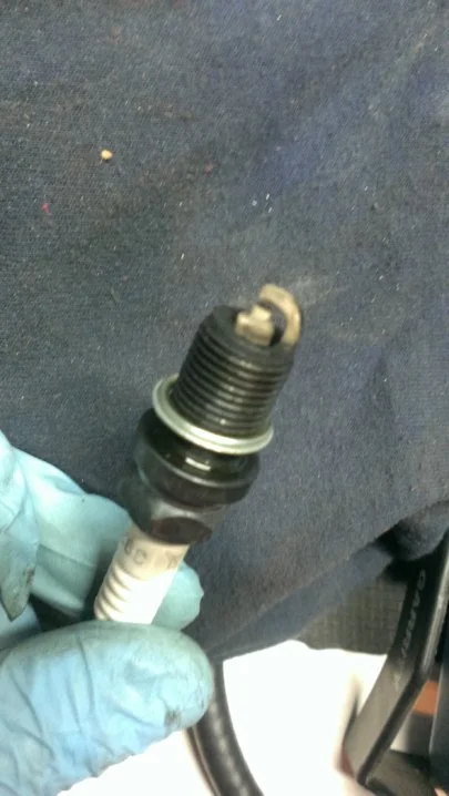

When I pulled the upper intake oil poured out of it. It took me awhile to get everything out. I also pulled all of my plugs and they all looked like this.

So this has to be the exact reason the previous owner had no pcv setup before. He had the pcv valve capped. The vacuum line that would normally go to the pcv valve routed to the oil filler neck and a breather cap on the oil filler. The throttle body was also capped. I am going to do this for now as well. Correct me if I am wrong, but this is not ideal to vent the crank case?
Am I also correct in saying I should be looking for a new intake manifold that was manufactured in Murica?

I think you definitely found your problem. Do a google search. I think some guys have made their own baffle. I would assume it is the baffle that's the issue, but it may be worth doing a compression test just to ensure that you are not pressurizing the crank case.

Also, there is an oil galley plug in the block right at the PVC plug. If it is not seated or missing, it will squirt oil right on the PVC.

I also pulled all of my plugs and they all looked like this."
Your crank case should be vented thru the pcv and also a hose to the filler cap. If you remove the pcv temporarily for an oil consumption test and are worried that you do not have enough venting, you can buy a filter that will push into a new grommet or possibly your existing pcv one. Running without a pcv for a while will not hurt anything.
Your plugs show no obvious sign of burning 1 qt of oil every 75 miles but…

So it's definitely the poor design on the baffle that caused my issue. I found an old post from tmoss on some random website and it basically stated that the Chinese lowers had a faulty two peice baffle instead of the nice one piece on the original Cobra. I am all set with that intake, and instead of spending the money to modify it I am going to purchase a better one.
