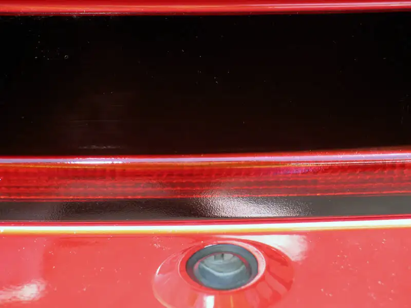

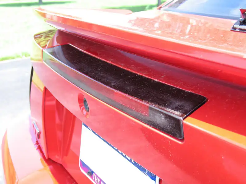

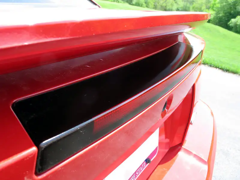

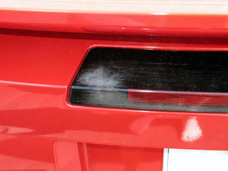

I havent been on much in recent times, however i am on now to share my experiences with wetsanding to refinish my oxidized and pitted headlights and rear brake light. I have been doing this on my car, as well as my sisters car all week and everytime i do it, the results get better and better.
Before:
After:
thanks for the info on how to do this DTNODYA :nice:

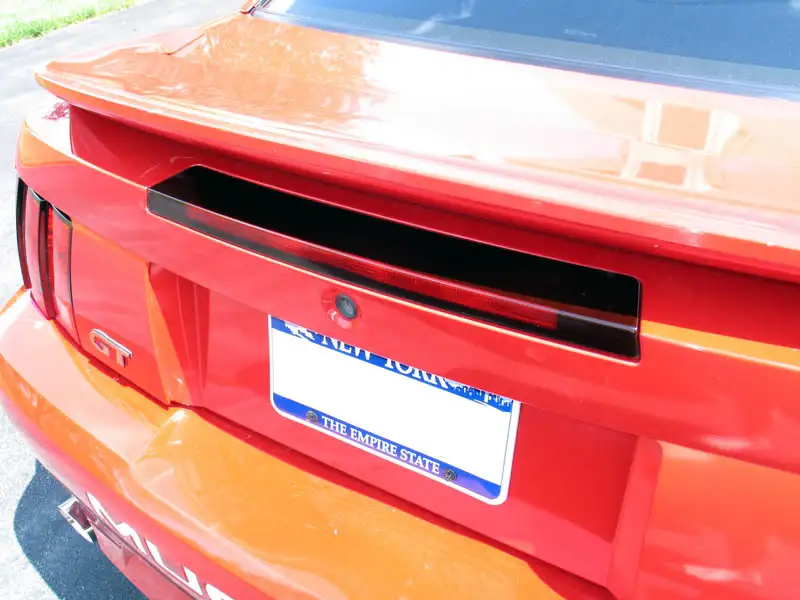

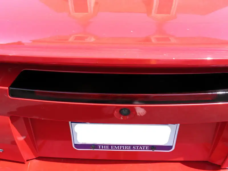

i used a combination of 600, 800, 1000, 1500 and 2000 grit wetsand paper, ScratchX and PlastX

how the hell did it get so messed up in the first place?? the trunklid around it looks fine?
this DOES work on clear plastic. yes mine are a touch hazy after 2000 grit and PlastX. I knew this was probably going to happen so i tried picking up some 3000 grit but noone in my area has any. eventhough they may be slightly hazy, t is still 100 times better than what they were
ill post a pic of my finished headlights when the weather is cooperative. i forgot to take "before" pictures

If you get some 3M Perfect-it II rubbing compound and use that before the polish, they will look perfect. But your results are impressive considering I couldn't get anywhere near that clear by starting with polish. I was just trying random stuff and hit it with some 3M and it was night and day. Food 4 thought.
