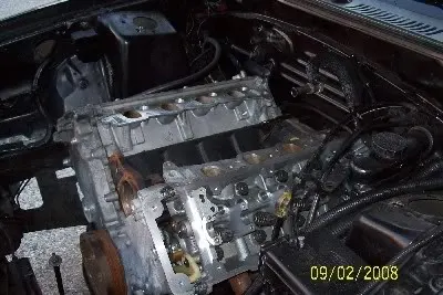

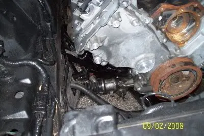

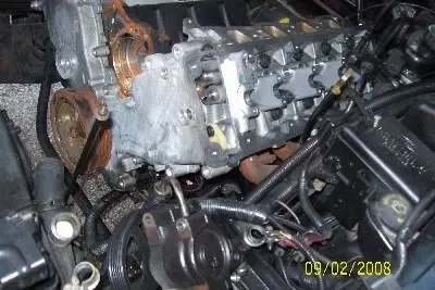

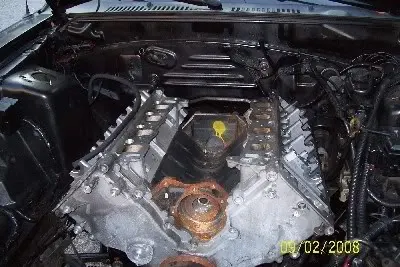

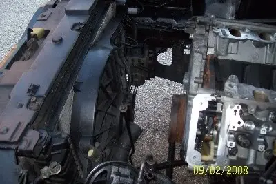

to remove the motor its just the tranny bolts to the motor and the motor mounts rigth ? also can the headers go on before the new motor goes in the car
i totally gutted the engine bay of wiring harness,hoses ,ac compressor, ac hoses
i also removed coolant filler,power steering filler and compressor,
complete removed the intake,fuel rails
i think the only thing i need off the old motor is that metal gasket that goes between the engine and flywheel and a little plug off the heads on the driver side
i think i got enuff room to pull the motor forward then up to remove it i was told i need to remove the radiator
yea like the rust cars been sitting for a year

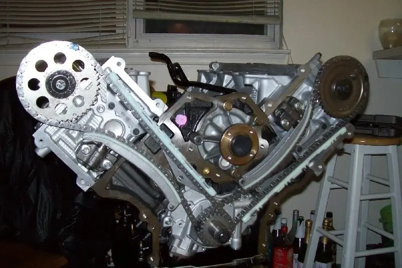

here is the new motor this picture is a little old i replaced the stock cam gears with adj. cam gears and the timing cover and valve cover is on but its still in the kitchen

I dont see anything else holding it unless the exhaust is still hooked up. As long as you use stock or shorty headers they can. But if your using long tubes, you'll have to put the motor back in unless your pulling the tranny too. I have heard that if you pull the motor with the tranny, and put it back in, you can do it with LT. But if the tranny did not come out, then they go on after the motors back . I also pulled my fan and radiater when I pulled my motor, just to be safe. Good luck.
