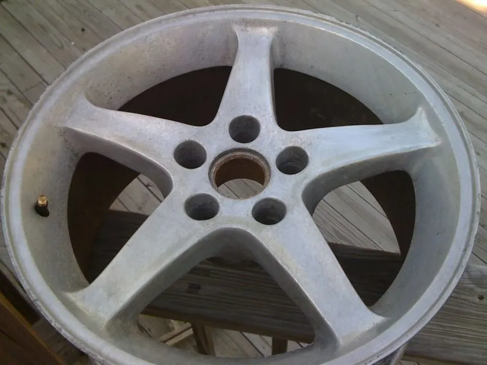

I picked up a set of 17x8 Cobra Rs today and am planning on cleaning them up, repainting them and selling them. Problem being, 3 of the wheels are aluminum (pretty dirty) and the other is a nearly new chrome wheel from AM.
The plan is to have a matching set because they will obviously be easier to sell and one chrome wheel isnt doing me much good.
so to get to my question, how can i safely remove the chrome without damaging the wheel/pitting etc.
Im not exactly a chrome expert but from what i understand the wheels are plated in zinc, then copper, then the chrome and its a chemical process involving dipping, electric current, the whole 9 yards. I obviously dont have this setup at my house . Is there a CHEAP way to remove the chrome finish, sandblasting (which i assume would pit the wheel) or wheel acid (doubtful this would accomplish anything other than damaging the wheel)
if theres no good way to do it i will just hold onto the chrome wheel until i have the funds to get 3 more and do something with the other three, but id really like to be able to get these wheels cleaned up and sold

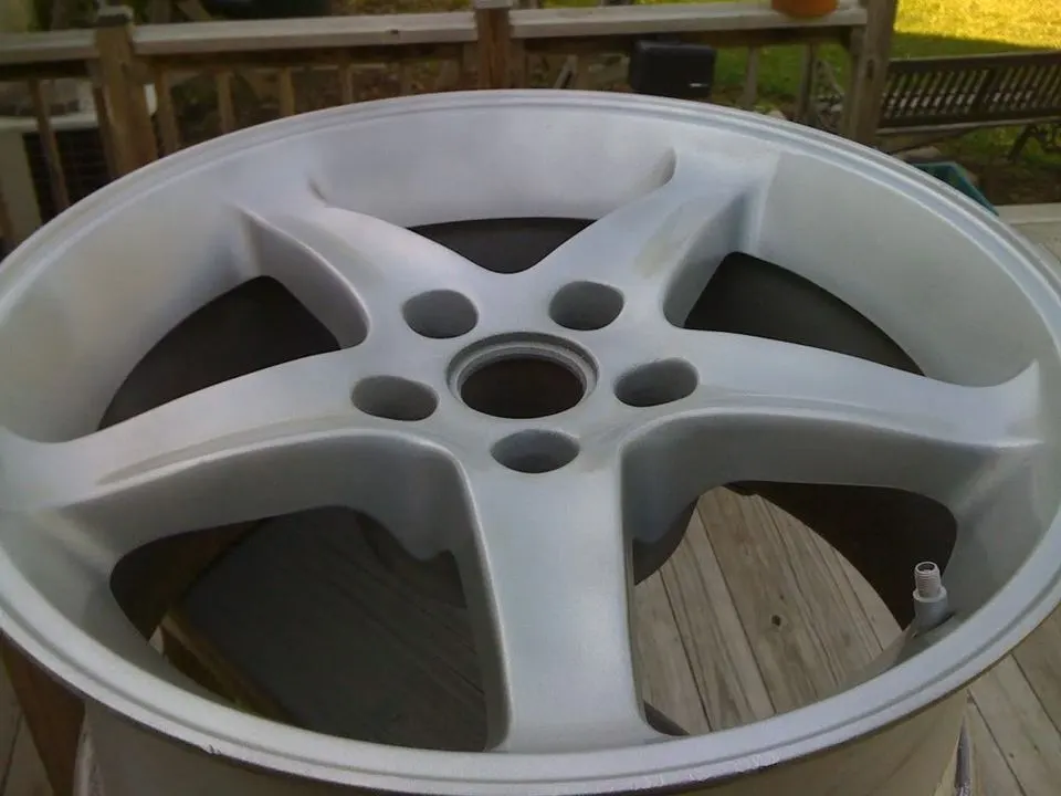

yeah, i did a little research and it seems like guys are having success by using self-etching primer, and then a regular primer and then the wheel paint. 80 grit with a DA is what seems to be the recommendation and a higher grit to smooth things out a bit.
i also came across a few people saying to just hit it with a scotch brite pad and paint them, but ill probably avoid that method
the plan is to sell these wheels after i clean them up so honestly i could sand them a bit, spray them and get rid of them but id hate for someone to buy them and have them start flaking apart.

Started painting the wheels, will post pics tonight.

i would use an adhesion promotor like ''bulldog'' also. it says on the lable that it will help paint stick to chrome.

looks good tanner, i like it.
