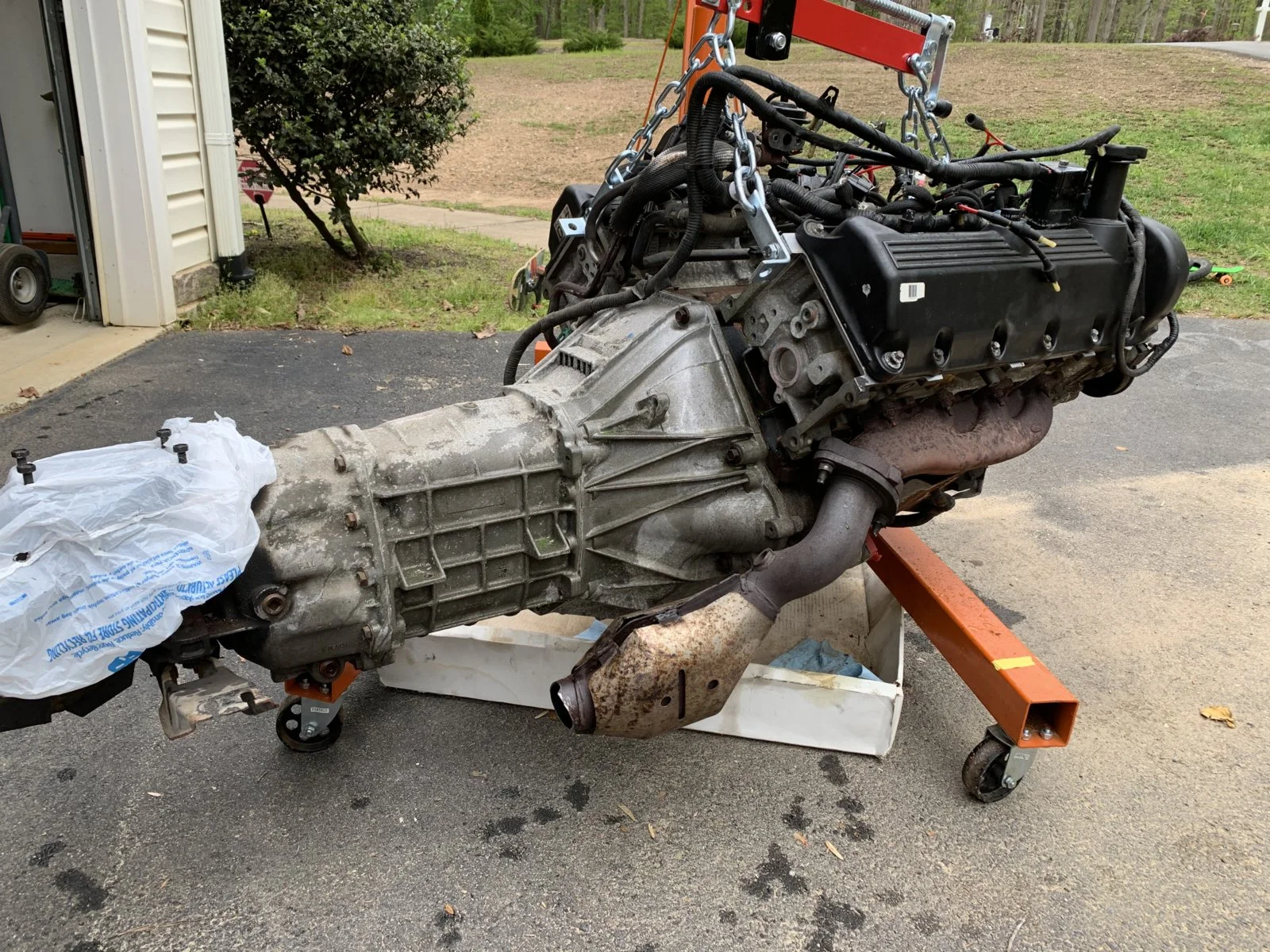

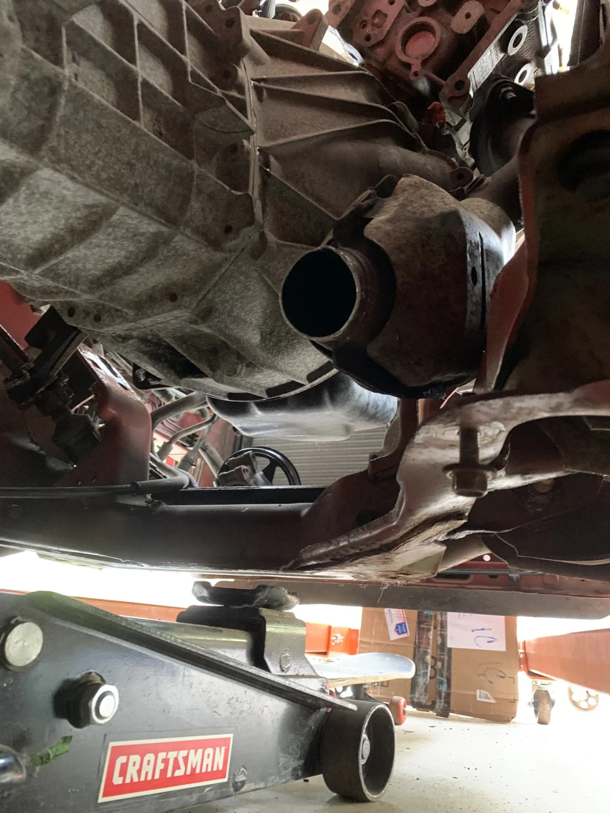

I am removing the engine anyways because it needs to be replaced; that’s the reason for the exhaust removal. The rest of the exhaust is off but I couldn’t get the last bolts for the h-pipe off. Basically I decided it cut it after the first passenger cat. I am pulling the tranny with it and after looking at it, it seems the whole assembly with the one cat will squeeze out of the engine bay.

So it does fit out with a cat attached. It actually didn’t even get in the way. It was way easier than messing with those nuts.
