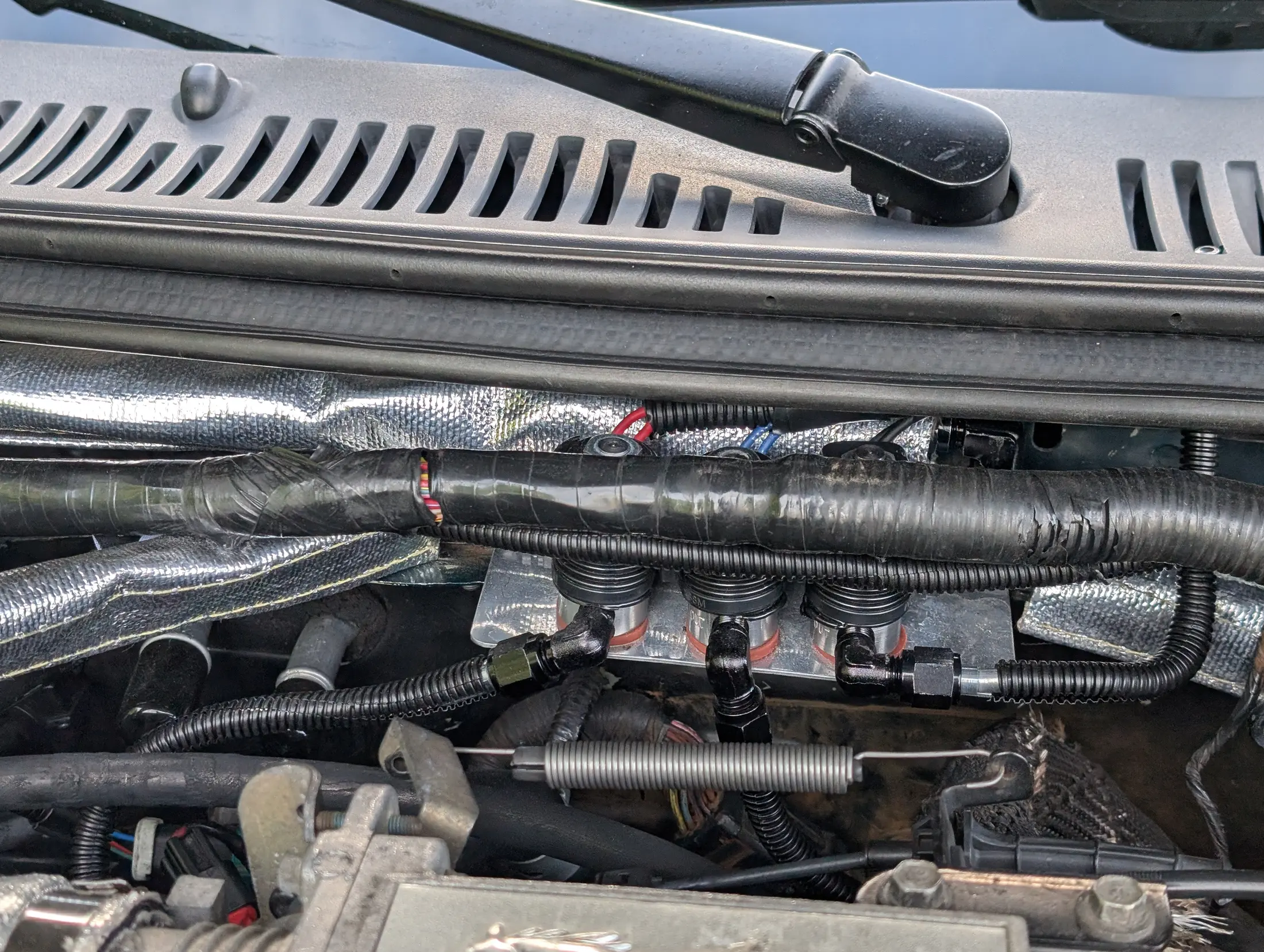

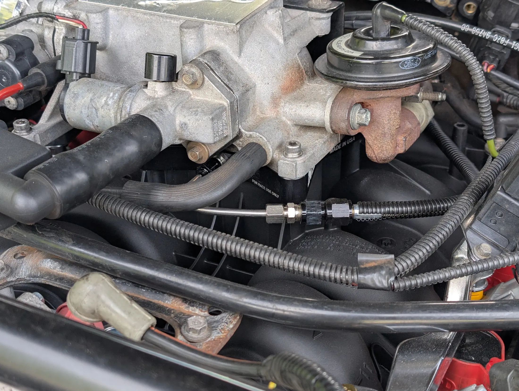

Just as a general question. I'm relatively handy, but I just picked up an 01 GT with a nitrous express NOS setup that I'm pretty sure I want to remove. Assuming this is pretty straightforward? Anything I need to know or consider? Thanks in advance!
Pull kit and any associated parts/wiring. Plug up the intake tube for the nozzle.
Remove line, plug any holes made for line and bottle brackets etc. Remove fuel fitting and lines for kit if a wet kit. Check for leaks etc after.
Pretty straight forward.
