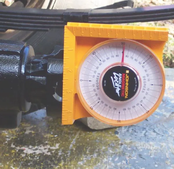

How does one check the pinion angles? I assume there is a specific tool that shows fine changes in the drive shaft to diff angle? I suppose a good driveline shop would do it easily, but I like to try these things myself...
You can check pinion angles with a level and a straightedge, if you remember your geometry, or one of these that you can get on the cheap at Home Depot, etc...
