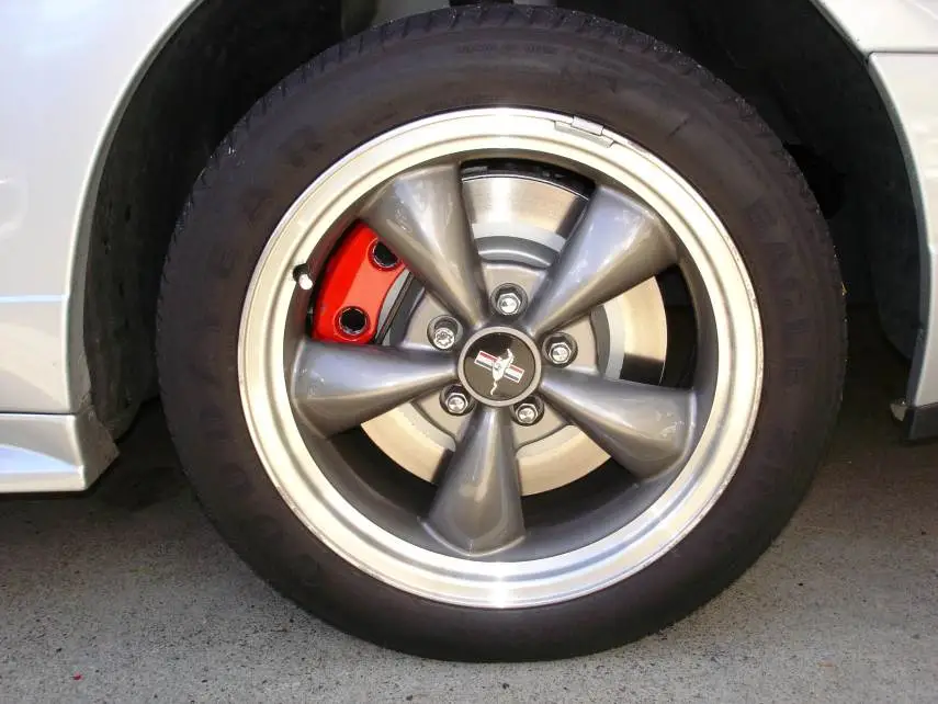

(sorry for the dirty rims and calipers... but I have bigger problems, like no motor)

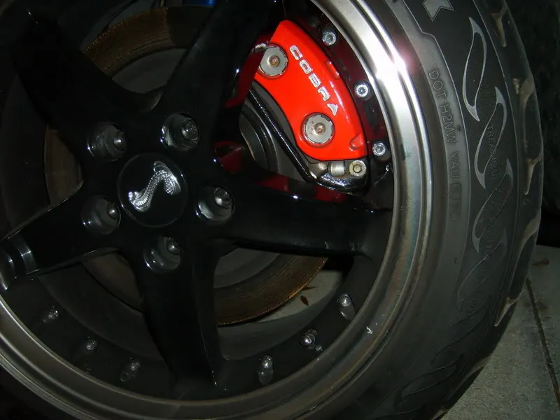

Painted 13" Brakes = :)
