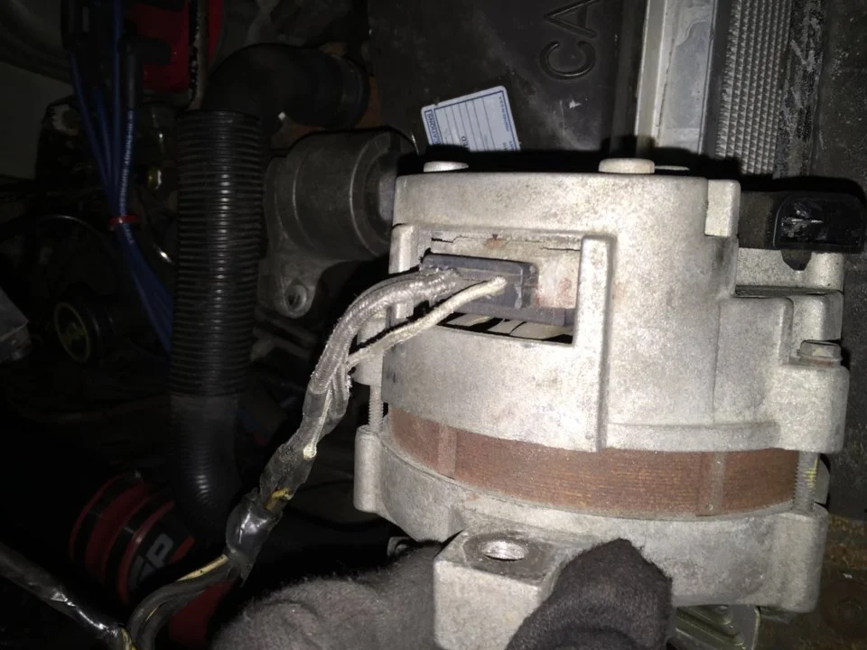

couple of days ago when i started up my 87 5.0 i noticed that the voltage had spiked and sat at almost 17-18 volts on the meter until i turned the headlights i heard some clicking under the dash and then the voltage dropped to 8 volts and stayed there..... needless to say i have an alternator / voltage regualator problem.

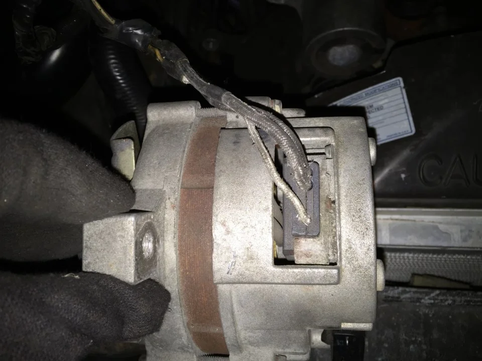

heres the issue... removed the alternator from the car today and ran into this issue. i cannot remove this plug and there seems to be no way to get it out. from pictures around the net it is the rectifier plug but i need someone to tell me whats going on here because unless im missing something this plug looks like it does not come out..does it need to be cut? there are no clips or spade to push to even unclip it.. ..please help thanks

It is not uncommon for the pigtail to have the clips broken off or to overheat and get stuck on the alternator. If you replace the alternator with a new or remanufactured unit, it should come with a new pigtail connector. Cut the old pigtail off, strip the wires, put on shrink wrap tubing on the wires and SOLDER the new pigtail on. Don't crimp, don't wrap, don't do anything else but solder the wiring.
I suggest that you check the fuse link for the alternator prior to replacing the alternator. Check to see that you see battery voltage at the alternator and at the green wire on the starter solenoid. Good 12 volts, good fuse link - in most cases.

It looks like someone else already crimped on new wiring. That's not factory wiring/plug.
That was my initial observation when I first looked at it that someone may have installed a new alternator previously..what threw me off was that every 2g alternator I've seen or looked up for reference had a removal rectifier plug...this plug seems to be permanently installed and unremovable unless cut and re-soldered...I thought I might be able to reference the alternator brand but there aren't even any identification numbers or names on the alternator to reference...I guess my next move from here will be to try and change out the voltage regulator since that's the cheapest method of elimination without cutting the wires out..I have considered the 3G alternator but I'd like to find out what's really going on here before I spend the money on a brand-new alternator. I'll keep everyone posted once I get the new regulator.
I would get a 3g and be done with it. You will be spending money on a 2g which are barely adequate for a stock mustang and the wiring are fire hazards. Total upgrade is less than $100 for a junkyard alt 94/95 mustang gt alternator and wiring kit off Ebay. Clearance the bracket a little for the larger 3g case, use the wiring from the new kit, swap the pulley and you are done. If you want to get rid of the rectifier plug altogether, get a 1 wire alternator- they are about $200 new from PA performance.

Fabric wrapped wiring is pretty old. I wouldn't be surprised if that Alt wasn't sourced from an older Ford model and just spliced in.
If it was my car, i'd head to a boneyard and snip off the wiring from a 80's/90's ford with same alt and solder it in place with heat shrink. I'd grab a stator plug off a 90's-later ford and then do a 3G or 6G conversion and run a large gauge power wire.
