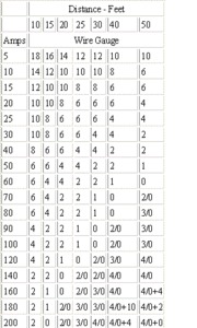

Facts:
1,) The wire size must match alternator output as closely as possible. Larger wire size is OK, avoid smaller wire size.
2.) The fuse or circuit breaker must closely match wire size, no matter what size alternator you have. The fuse or circuit breaker protects the wire from burning up and burning your car to a smoldering heap.
DO NOT OVERSIZE THE FUSE OR CIRCUIT BREAKER!!!!
If you use a 4 gauge wire, use a 125 amp fuse or circuit breaker. Both high current fuses and circuit breakers have a 5%-10% continuous overload capacity and usually a 150% short time overload as part of their characteristics.
