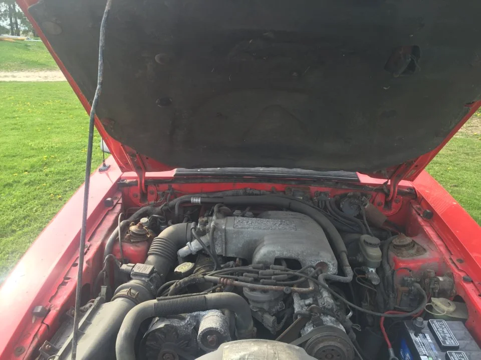

I am waiting for more detailed pictures since it's about. 2 hour drive. I certainly wouldn't pay asking price. I guess if $700 was realistic and I bought it and it turned out worse than expected I could always part it and make the $700 back. Or if the trans and motor are strong or clean interior I could find a clean roller and transfer.

I would look at the pictures too. See if it's rust or rotted out rust, you start seeing daylight through any of it, walk away. There really are still a bunch out there (though you couldn't tell that by checking the salvage yards in my area!).

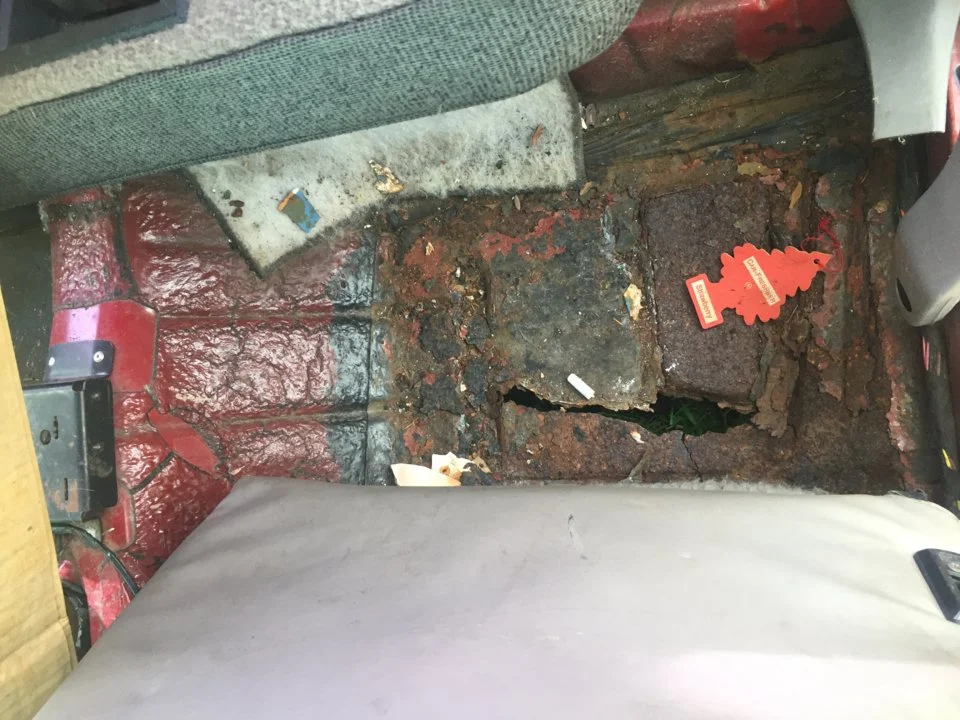

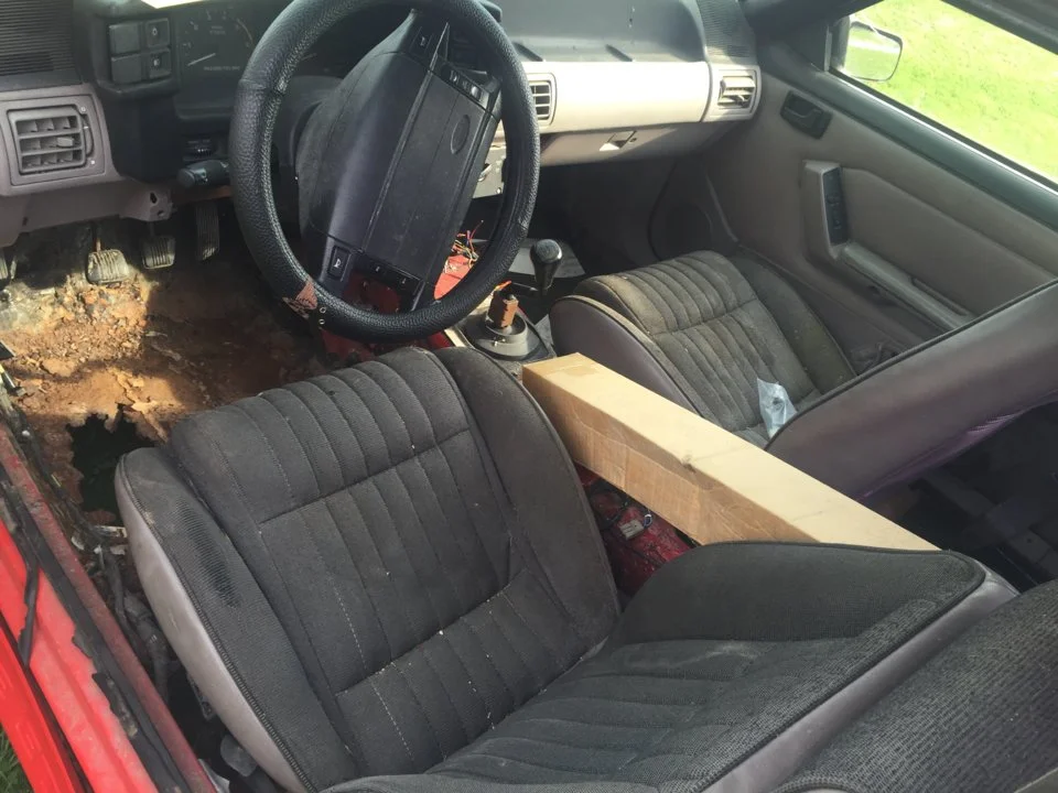

Here is the floor board. Past the point of repair?

If it's repairable for the right price I wouldn't mind taking it to a body shop and having it professionally repaired. But I'm not sure how this stacks up? What's a fair price or is it not worth anything just run?

Wow! After looking at that floor! Wow!
You'll probably want to replace the entire floor. the panel isn't very expensive, it'll just take work.
Need a more detailed picture of the shock towers though.
Truthfully, the floor is relatively easy. That is compared to the shock tower and probably the front subframe.
