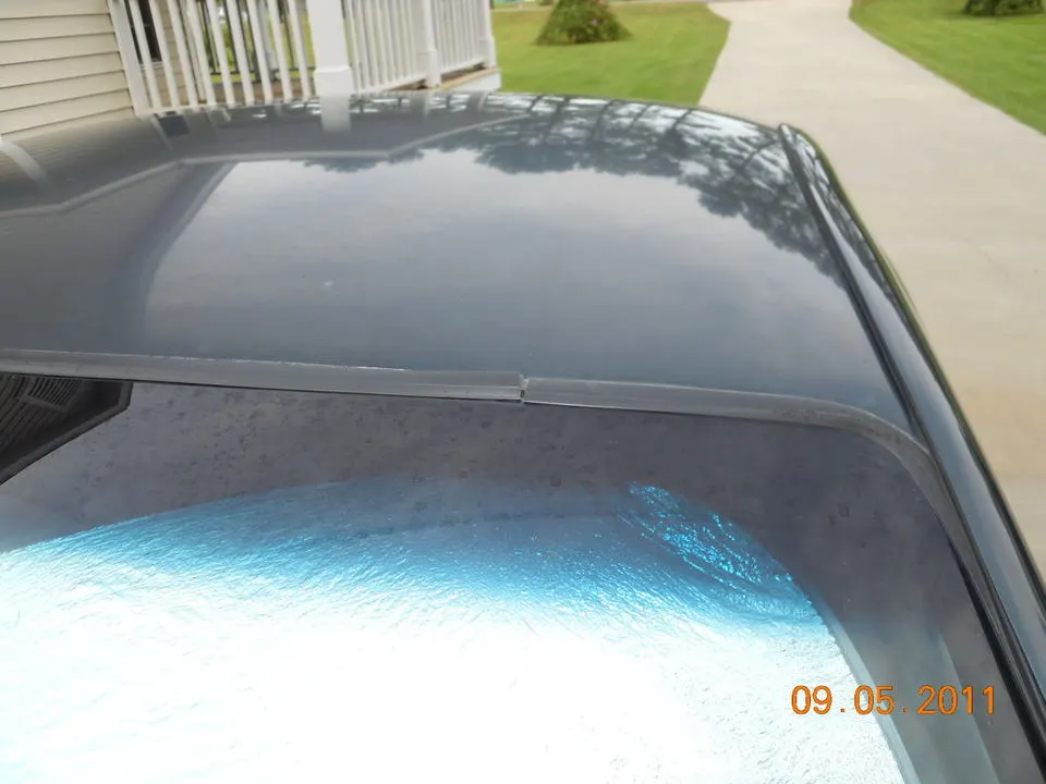

But, neither had a definitive answer & the Service Manual is a bit ambiguous too ... the question is, do you have to remove the windshield to replace the rubber trim (Ford P/N F4ZZ-6303144-BAM) that is around the windshield?
As seen in the pic below, mine has decided to split for some reason and is looking pretty tacky.
So I think I got the answer I needed ... This youtube vid helped:
Day 5 Mustang Cobra Project Ford SVT new windshield - YouTube
First hint, if you watch closely, is you'll see the new windshield with the rubber molding already attached. So I contacted Safelite and got this response:
the moldings would come attached to the new windshield
So the answer is (for anyone else who searches for this) ... you can purchase & install replacement molding, but'll you'll have to remove the windshield to do so.
