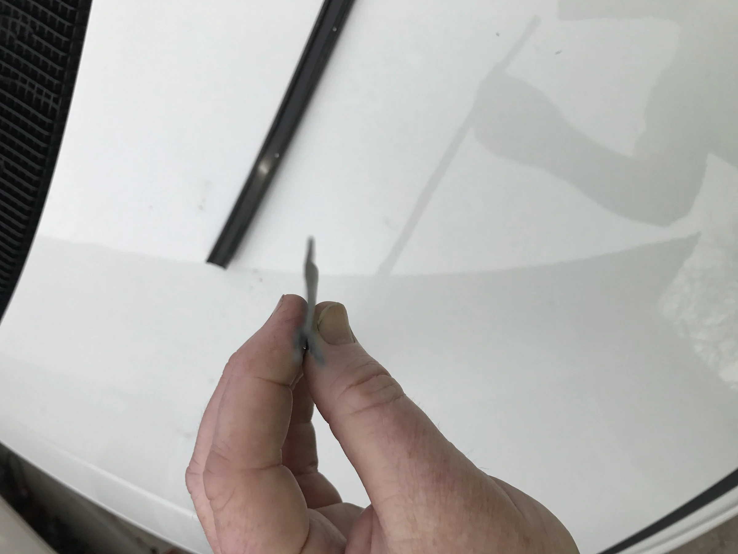

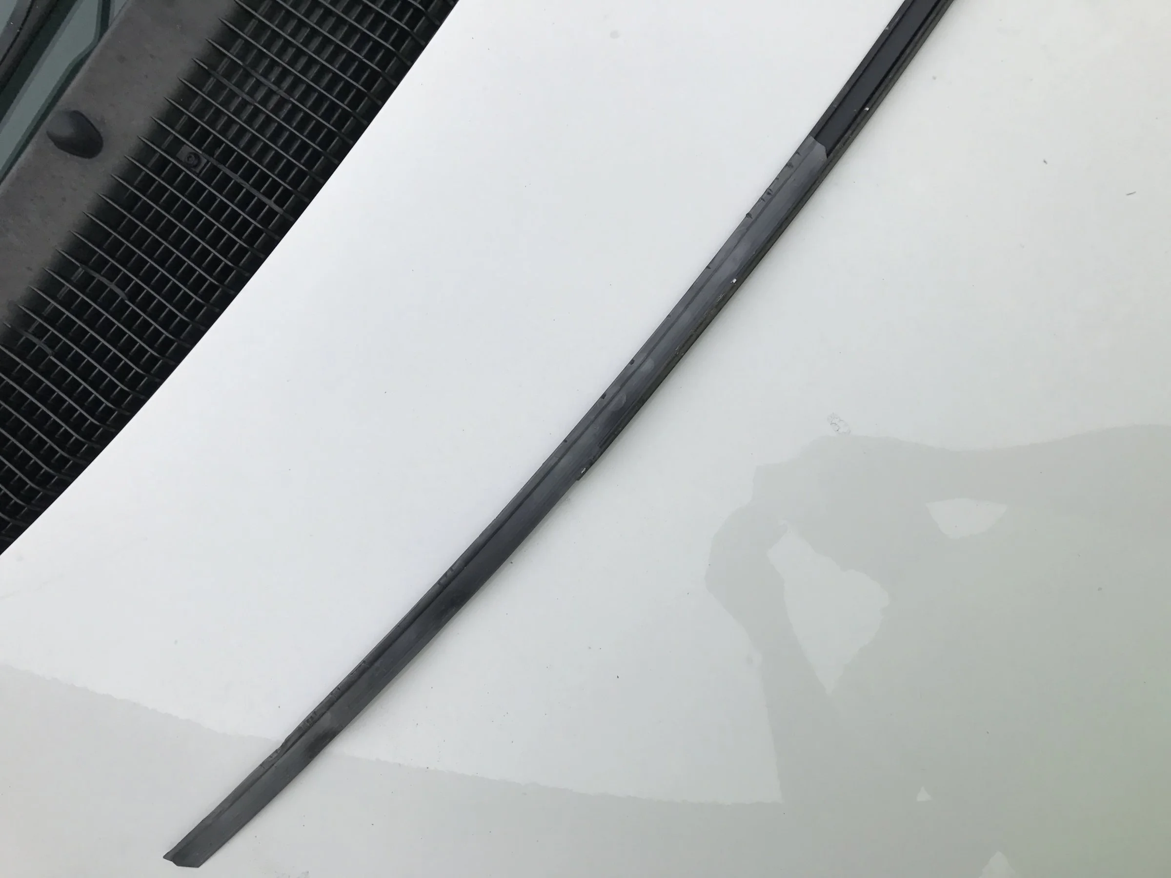

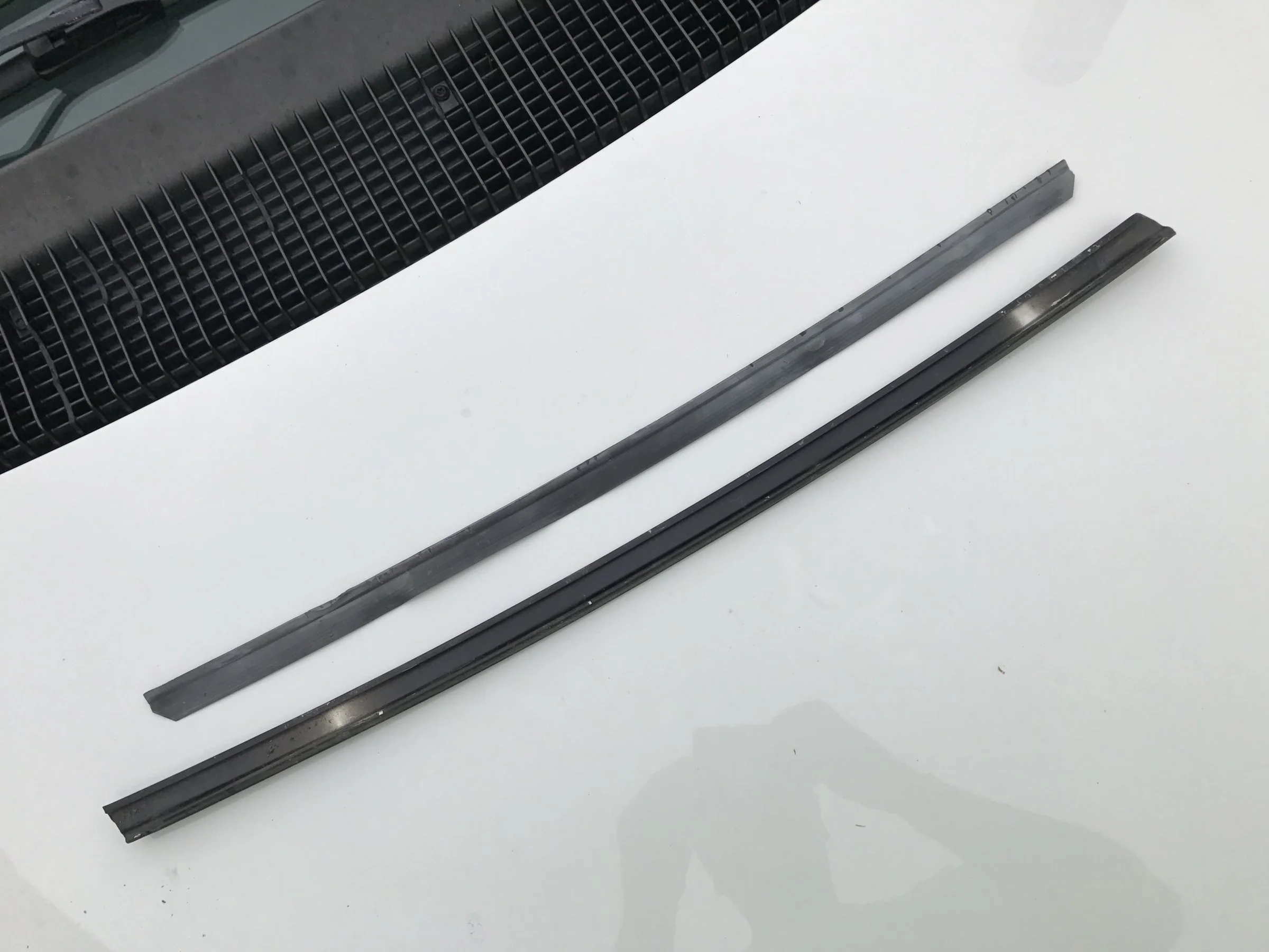

Howdy Davedacarpainter. I took pictures today. The bottom one is the windshield molding side piece with the elusive rubber seal half removed from the windshield molding metal piece, the second one is after I slid it out laying next to the original molding piece, and the top photo is an attempt to capture the profile on the end.

Hi Dave... Before I came here I tried LMR, CJponyparts, autozone, oriellys, americanmuscle, foxresto, rockauto, dallas mustang... tried manufacturer direct with Fairchild, and a few other places... went to Safelite auto glass today and they came back with "nobody makes this anymore".
At least we tried and I captured a picture of the elusive piece of trim molding seal that everyone thinks is non-existent.
