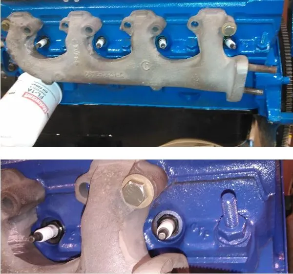

I think that a couple of you missed the point of my original question. Thanks though for the information about aluminum performance heads.
I'll ask it again...
I was curious if anyone has used a 5.0 with the "P" heads in a 1965 or 1966 Mustang in particular but the main question is, will "Tri-Y" exhaust headers or Hi-Po exhaust manifolds fit the "P" heads when installed in the 1965 and 1966 Mustang bodies? That is the narrowest body between the shock towers. Would the spark plugs be more difficult to change? I hope to gain some information from someone else's experience.
Noobz347, I did read the information that you pointed me towards.
Picture below is of a modification that someone did to their early stock manifolds. To me it looks as though the area of the casting could be getting
quite thin after the custom carving.

I worked out the exhaust manifold issue on the Explorer 5.0 coil-near-plug proof of concept engine. I have a 1996 F-150 5.0 drivers side manifold on the left side, and I used a 1977 Mustang II 302 passenger side manifold for the right.
