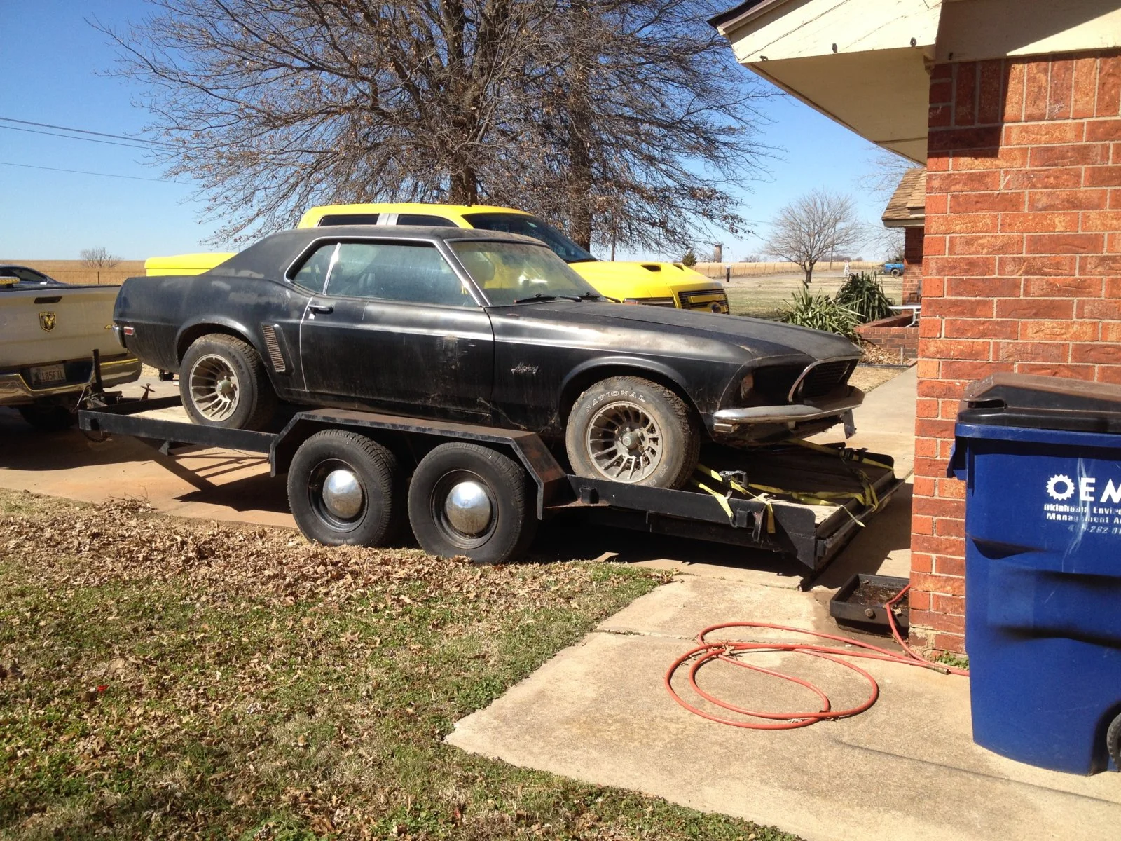

I hope I'm wrong but minor rust is only what you see. These cars are notorious for hidden rust showing up once you start digging into the body. It's almost always cheaper to buy a car already done than to pay to have someone do yours. Unless you can do the work yourself you will be on a time and materials basis and will most likely be put on a back burner at body shops as they typically like quick turnaround jobs. What state are you in? You should post up some pics so folks can gauge the condition of your car.
I’m in Denver but the car is in Oklahoma and has been its entire life. I only have one pic of it on my phone

The only rust it shows is one the rear fender wells, the other stuff is actually cob webs
Well the '69 coupe I did cost me about 10K in parts and supplies and the squirt, and it was in far worse shape than that. I did full floors and both rear quarters and one fender.. And from what I've seen the parts prices haven't gone up much in the last 10 years, however I did all the work myself except the body prep and paint. If you drop it off some place you can easily drop that 30K
