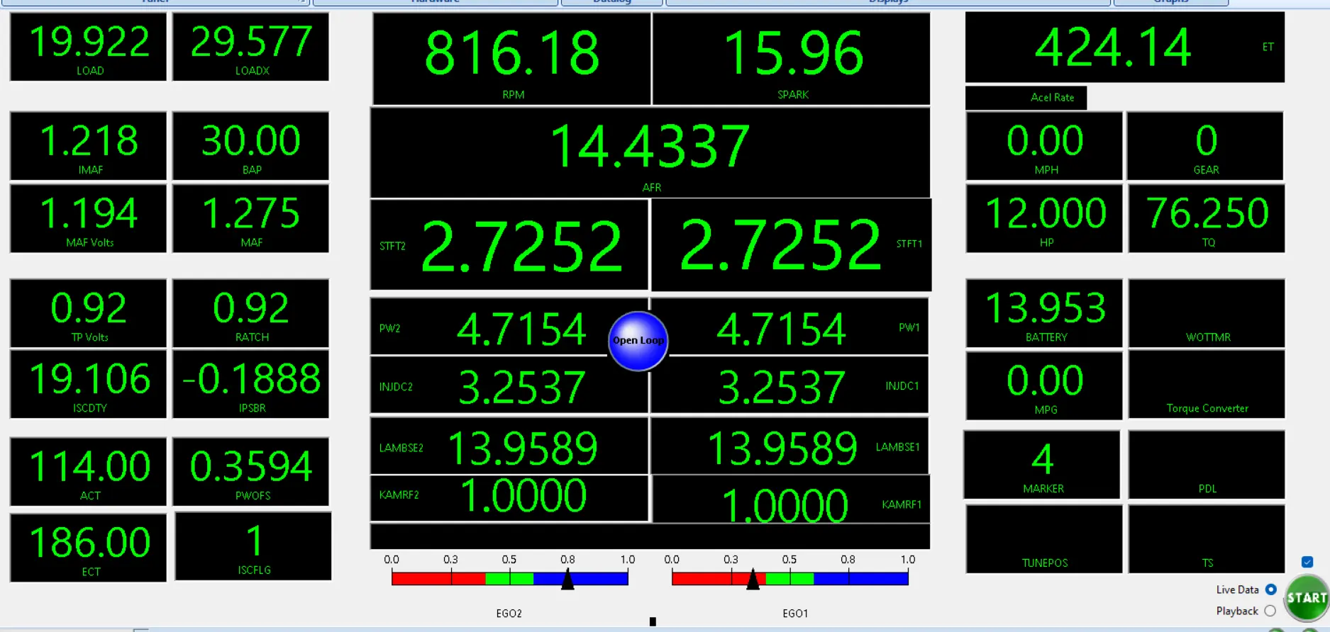

First thing that comes to mind is the IAC isnt opening/closing and sealing right and that could be internal to the ECU and may need new capacitors and a tracer rebuild if the electrolyte in the caps ate up the board enough.......
Post up a logfile of it idling or screenshot of the datalog page........I have a feeling your issue maybe TFI module or Halls effect pickup or maybe even TPS related..
When the engine cant count the pips it goes by the default settings in the ECU.

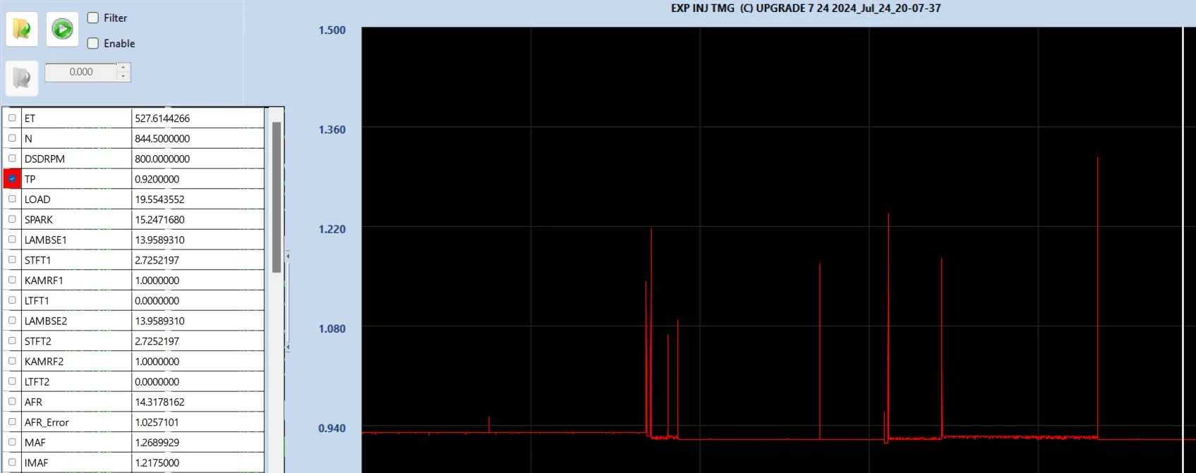

I had a TPS sensor that sort of registered the correct voltage at idle but as you rotated the sensor by driving the numbers got quite erratic for the ECU to understand so the ECU just went by the MAF setting and the BAP setting for spark interpolations and didnt even throw a code..
When idling the TPS should be steady...When you look at my logfile of my TPS you can see the voltage spikes the TPS was throwing to the ECU without even touching the pedal and those spikes were doing a number on my idling....
After changing out the TPS the TPS was just a straight line until I hit the throttle and the idle issues went away...................
