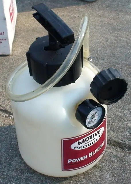

Has anybody used a reverse brake bleeder like the Phoenix V-12? It pushes fluid and air bubbles back up and through the lines to the M/C. I am just looking for a better way to bleed brakes at home.
I've always wanted one but they cost $100+
I made one of these for 10$ in parts from an ace hardware store.
I was lucky though expect costs to be around 20$
PS: Motive is a company that took the idea off the net and started selling them on amazon for 50$
