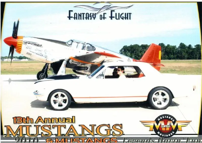

I have a pretty simlar setup on my coupe, but do not have the shelby drop.
This is what it looks like:
