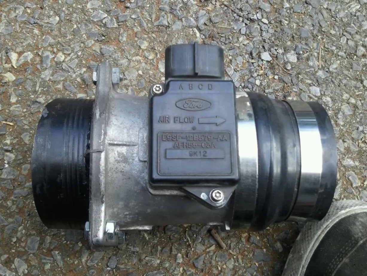

Now, I took the MAF off the car and measured it...it's about 3.25" so it's an either an 80mm or 83mm MAF housing with the tbird electronics in it. After I told my buddy who owned the car, the moron said OHHH YEAH I FORGOT I SWITCHED THE SENSOR INTO A DIFFERENT HOUSING. Here's some pics...there's no way that's a 55mm housing, he also made an adapter for it. I'm picking up the stock MAF for free tomorrow, can I just throw the sensor in this housing or will it not work that way?

Won't work that way. Sensors are not interchangeable. That maf is pretty much useless to you.
Get a stock maf and 19# injectors....or am sn95 maf
http://www.stangnet.com/mustang-forums/616246-94-95-maf-install-completed.html
