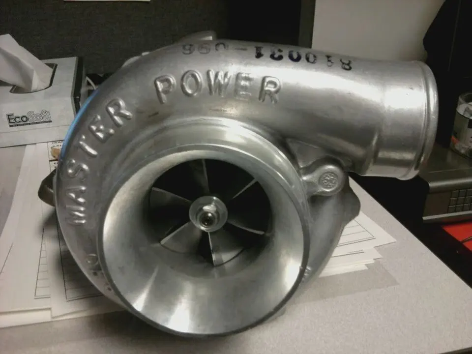

The kit arrived and is now waiting patiently to be put on the car. Yesterday I picked up a brand new MasterPower T70 with .96 a/r off of Corral for a great price, so that's the turbo I'll be running. All I need is an MAF and a wastegate now and a few tiny odds and ends and it's good to go. The dilemma now is whether I run the kit on the stock motor and blow it up within a few months, or sit on the kit while I build a forged bottom end with trickflow heads and intake... What would Stangnet do? :shrug:

Oh yeah, and this showed up today...
